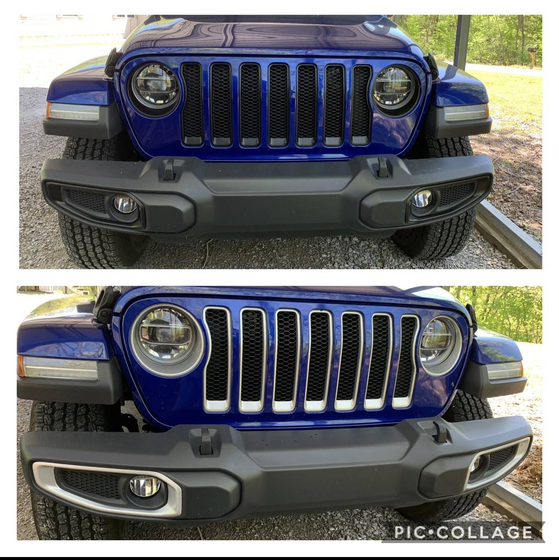

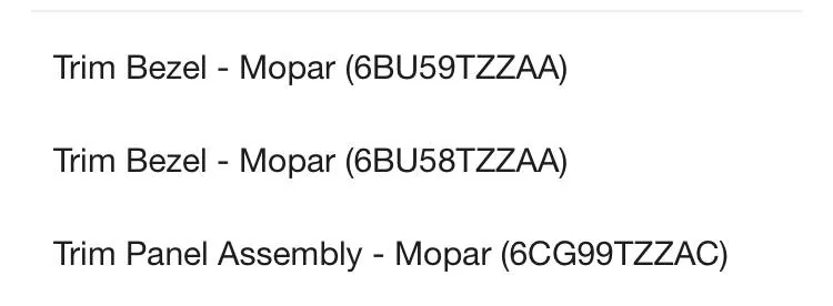

Here’s the part numbers you need if you decide to replace them.
I watched you tube videos and had help from members on here when I replaced mine on a 2019 Sahara a few years ago.
Here is a pic.

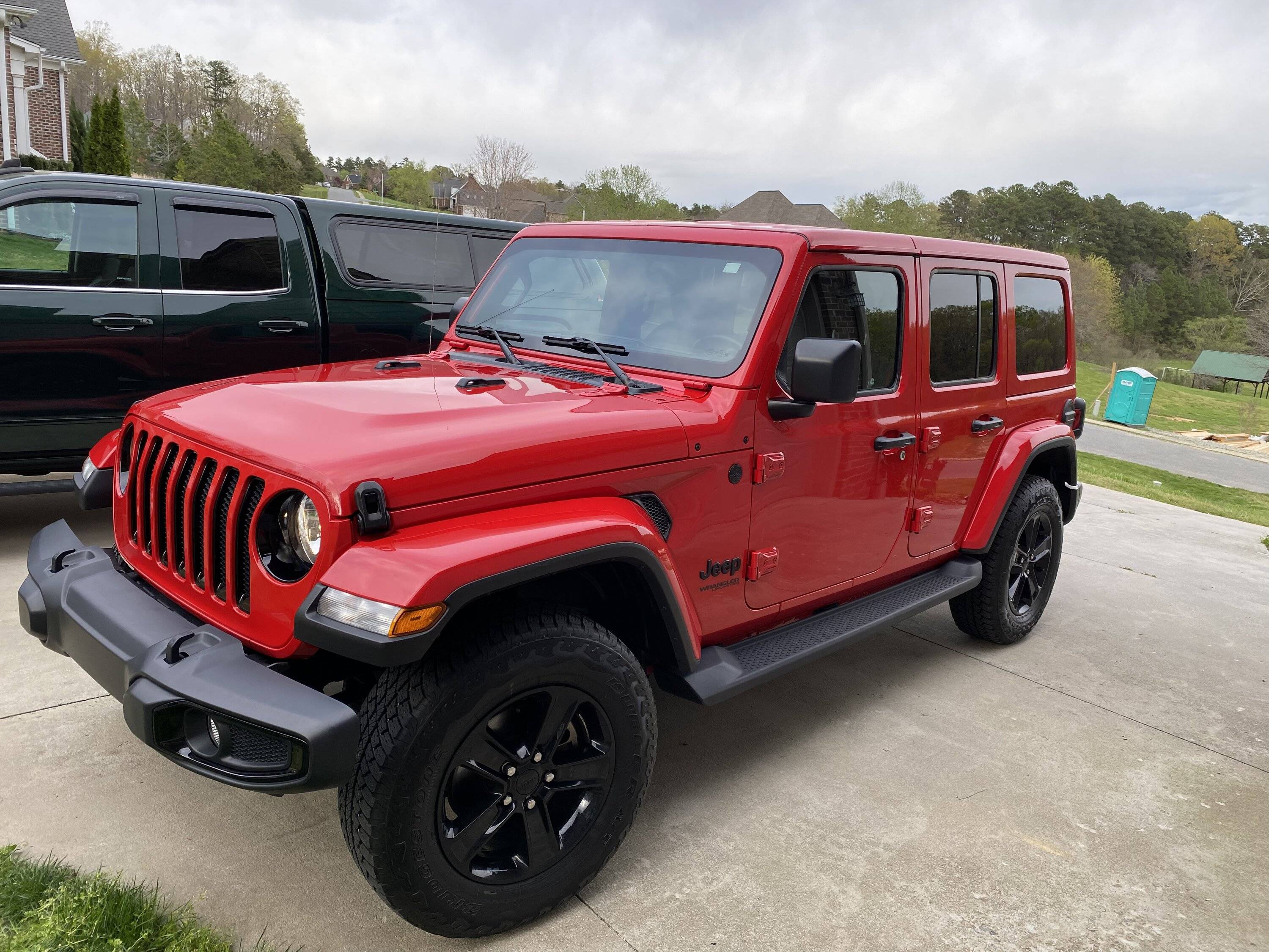

Or just get the altitude edition. Blacked out from the factory. Although I did buy some black Sahara emblems from eBay. Post your progress!
