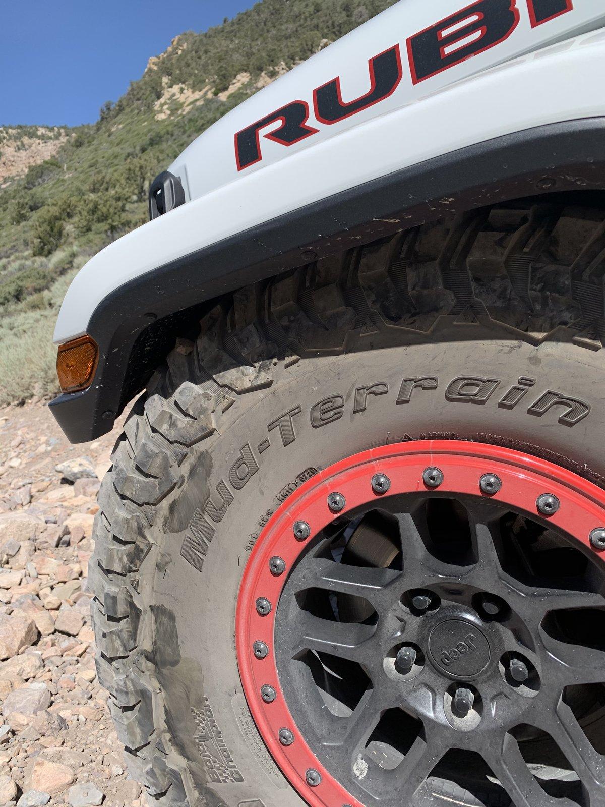

No rubbing on the front. I did remove the steel bumper wings, tested at full articulation (to the bump stop) and cycled my steering lock-to-lock. I think 13.50”W tires will require A minimal amount more offset, but the 12.50”W tires work great on the MOPAR wheels.
I think I may step up to a 1.75” spacer from my current 1.5” spacer. I do get light rubbing in front at full lock and articulation.
You’re on stock wheels?

Yes. Stock wheels. Been trying to keep it “stock” looking and I’ve pulled it off quite well so far.
