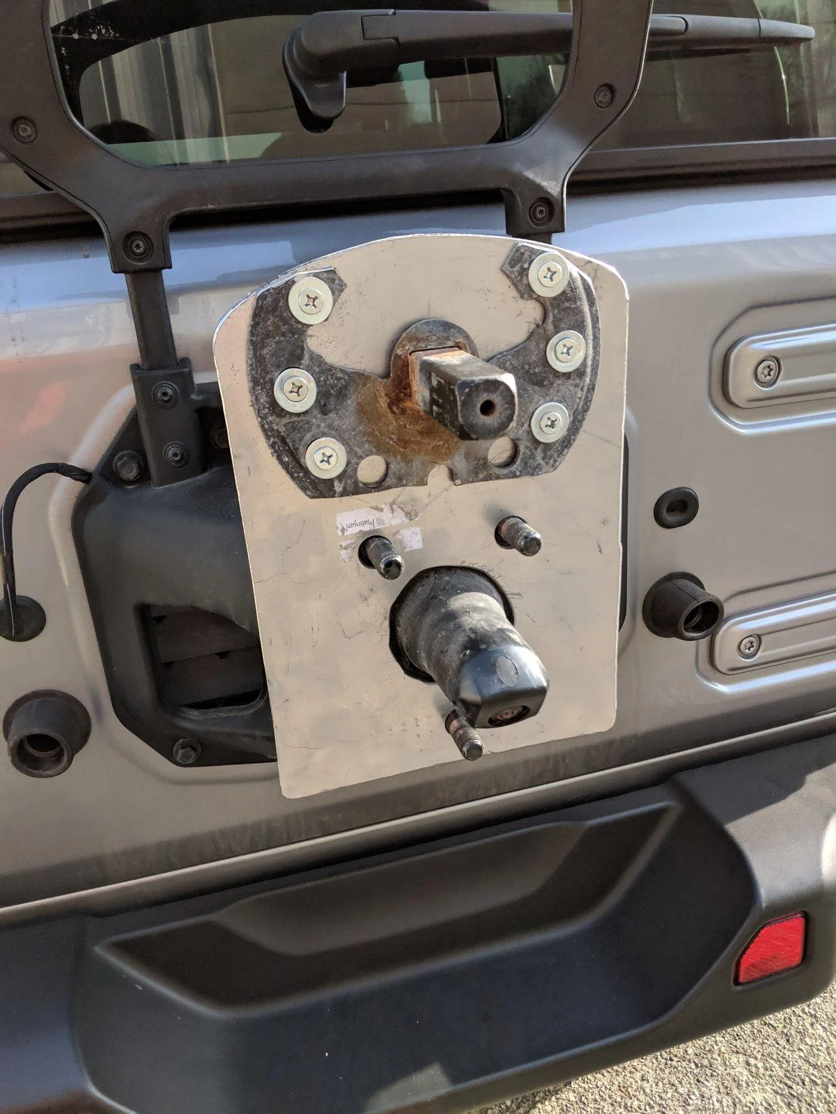

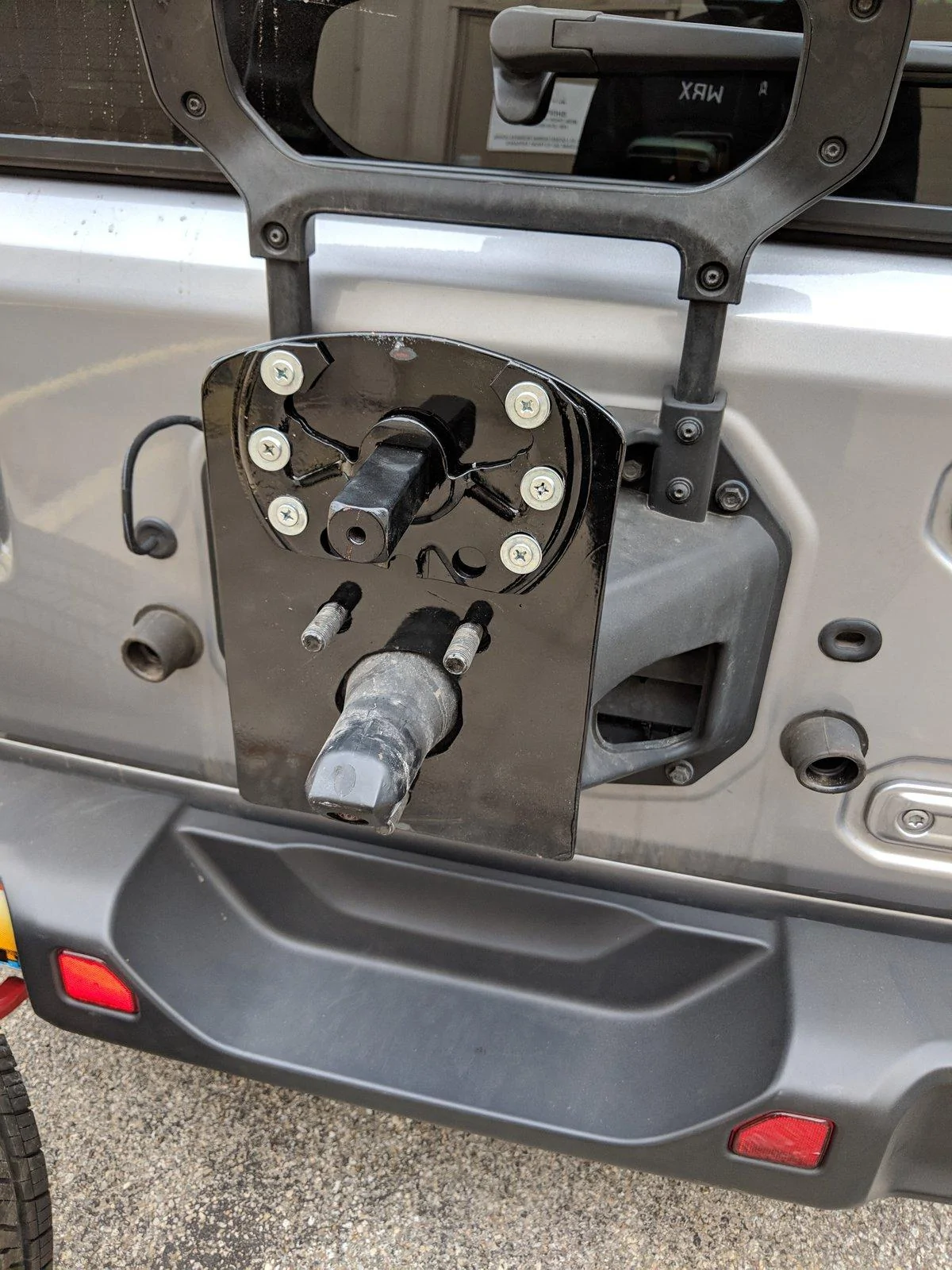

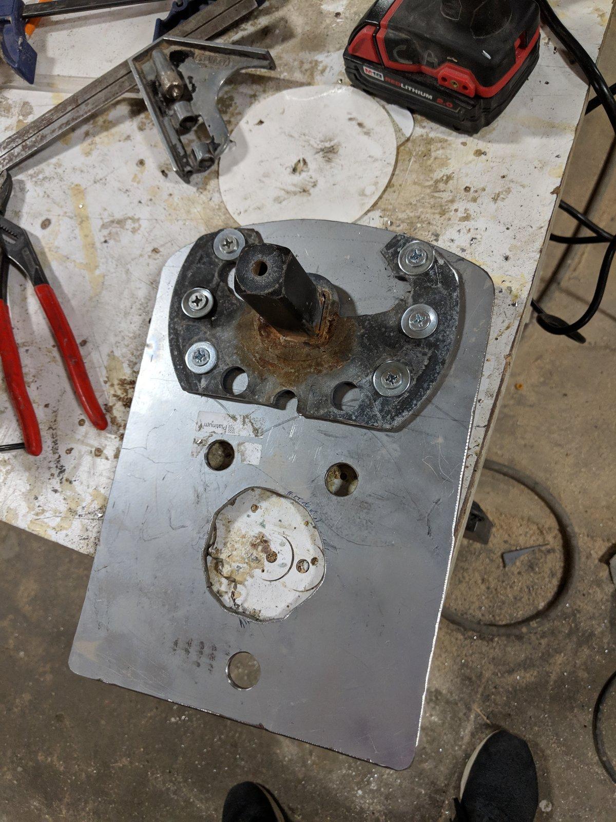

So this is a somewhat involved option, but I modified my Thule Spare Me 2 to work with the camera.
Cut up a 3/16" plate and trimmed the existing bracket to fit. Had to move up the cross piece to account for the camera offset. All in all it turned out pretty well.
