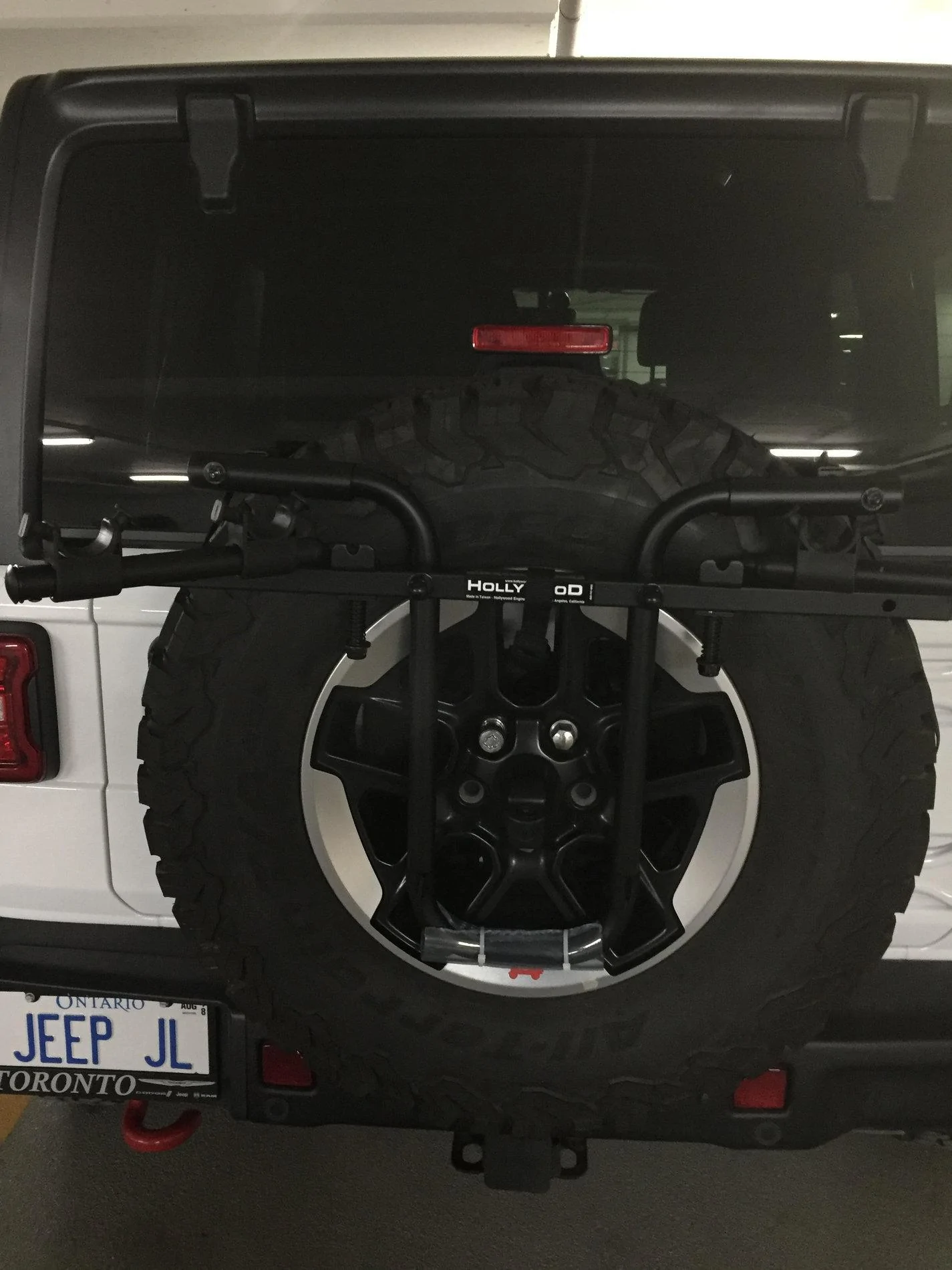

If the active safety group is included with the blind spot monitoring then no, I opted against it.
I loosened the mount of the 3rd brake light, then tightened it again after installing the bike rack. They touch each other, though, but not in a way that would bend or force-back the brake light mount.
Here is Colorado the 3rd light is not a requirement and I may decide to take it off altogether.
One more Hollywood SR1 rack on JLU. No problems installing the rack after loosening the 3rd brake light with T25 torx as above. Had to add some protection for wheel on bottom of rack U-section to avoid scratching wheel. Ideally black split rubber donuts would do the job with 1" inner diameter.
Blind spot monitoring unaffected with or without bike on rack. Parksense automatically turns off with bike on since it beeps continuously due to tire proximity to sensor. Camera view unaffected when no bike on rack.
No complaints for price of SR1, but would probably not add a second bike unless hinge reinforcement installed.

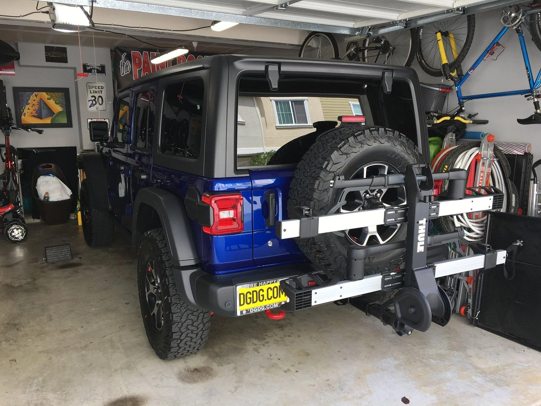

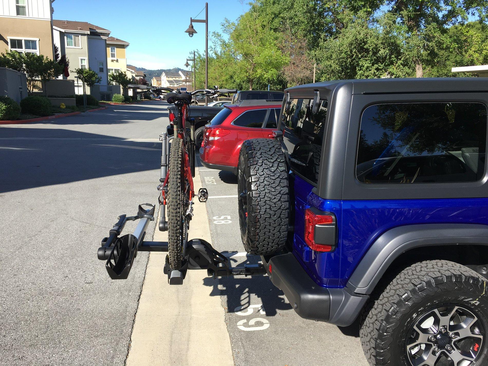

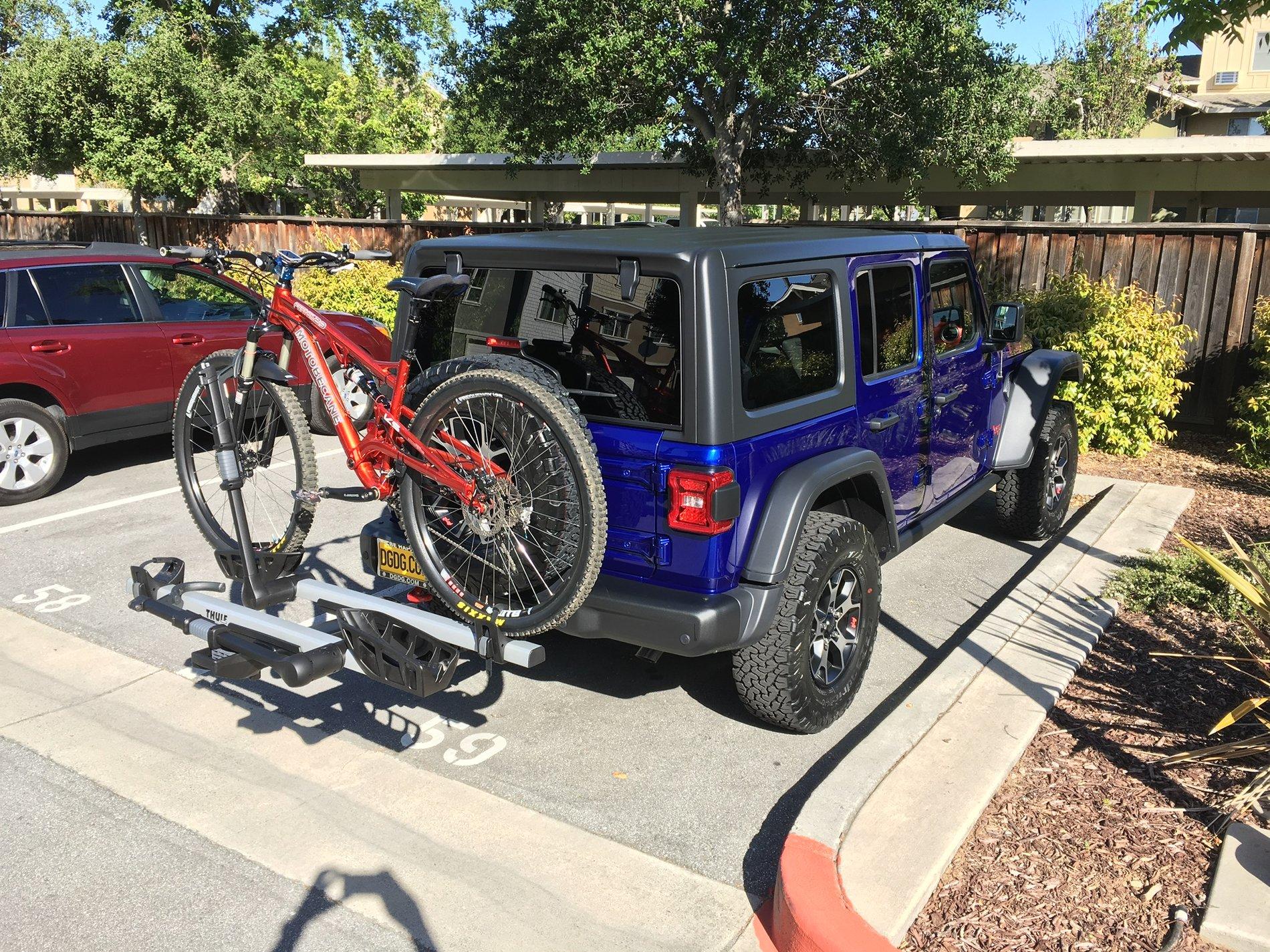

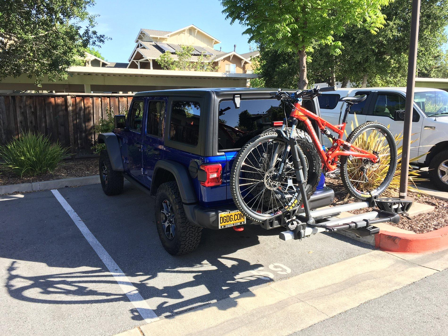

Well I ordered the Thule T2 Pro Xt hitch mount bike rack and the 1up 7.5" hitch extender. I'll let y'all know how it works out once the Jeep and the rack arrive later this week/ early next week. :like:

Any update on how this is working out?
So far I really like this setup. The 1up hitch extender has a threaded pin that let's you tighten it so that there is no play, it is rock solid and it also has a locking mechanism. I didn't get a drop down so you can only open the gate about 1 foot before the spare tire touches the rack, but that's totally enough to grab your riding gear out of the cargo area. The backup camera still has a great view between the two wheels and below the bottom bracket when you position the crank arm out of the way. I'll be making a video on this hitch rack set up for my youtube channel next week. I'll post a link here once I upload the video. Here's some photos of the rack on my JLUR. Hope this helps! :like:
Looks good. Where did you pick it up? and my bikes are less than 17lbs each so not really worried about the weight ;)

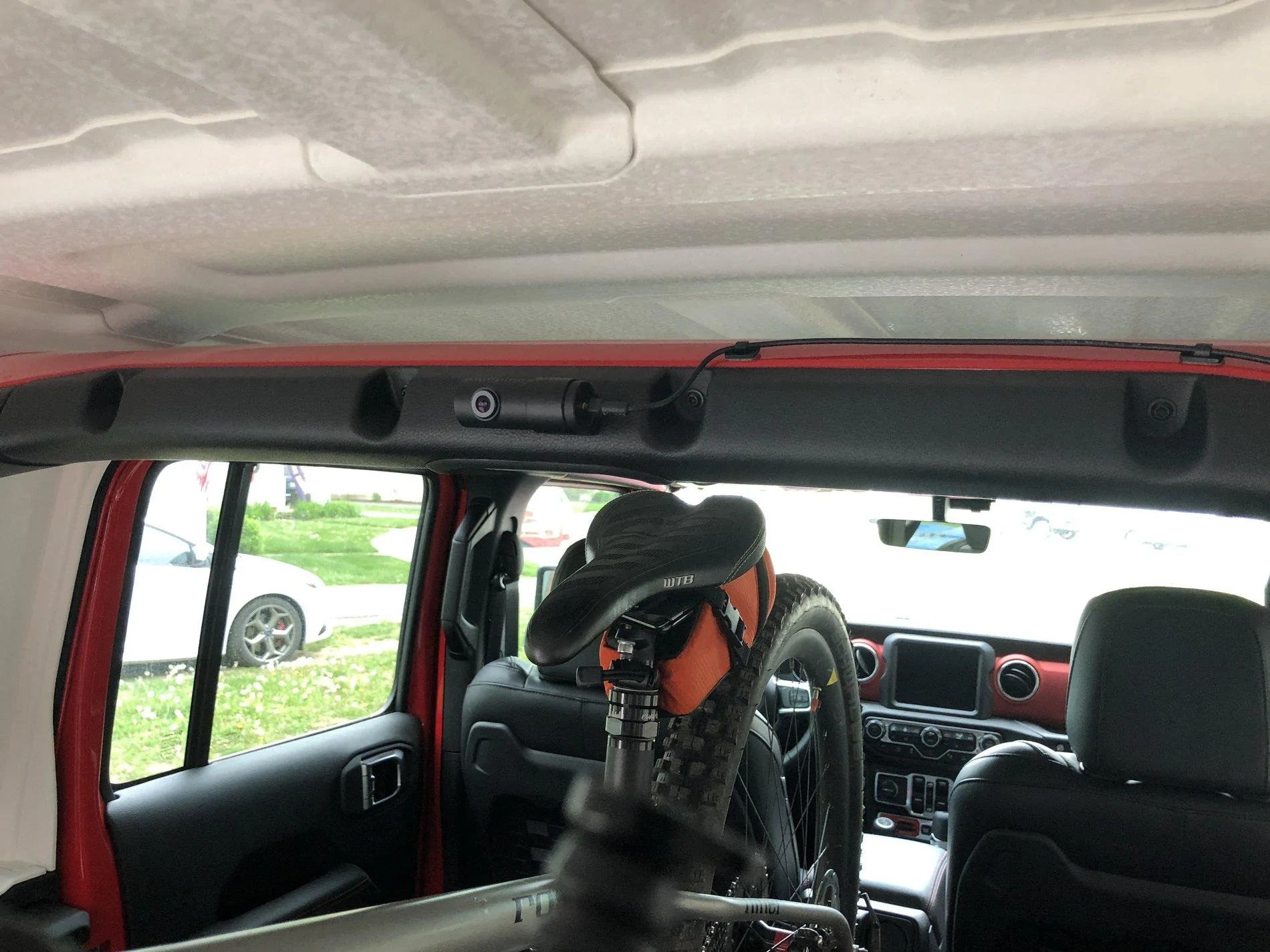

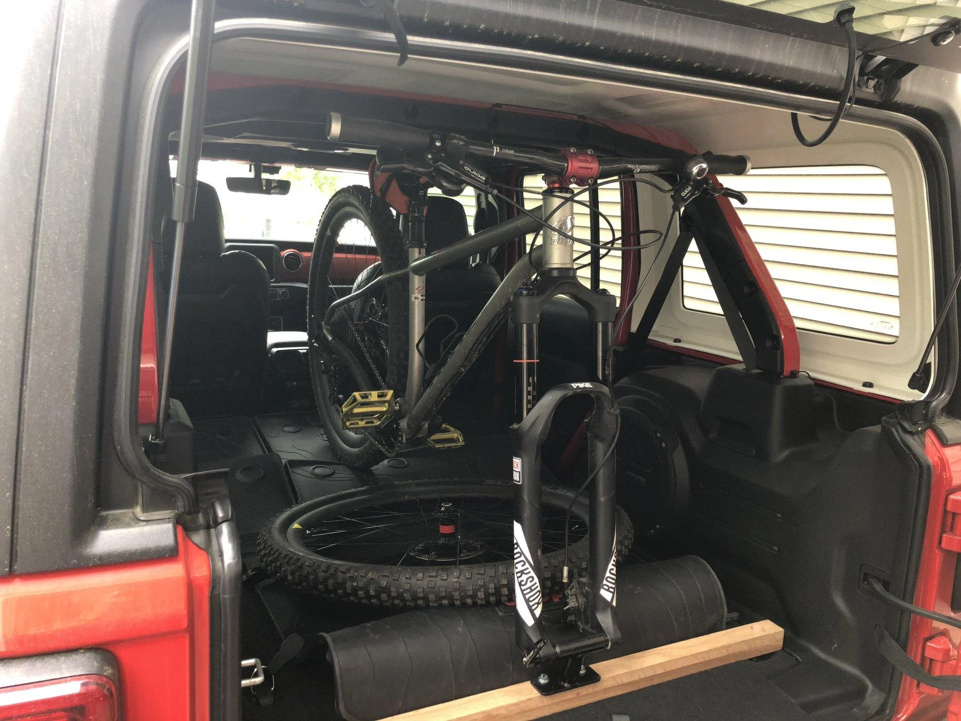

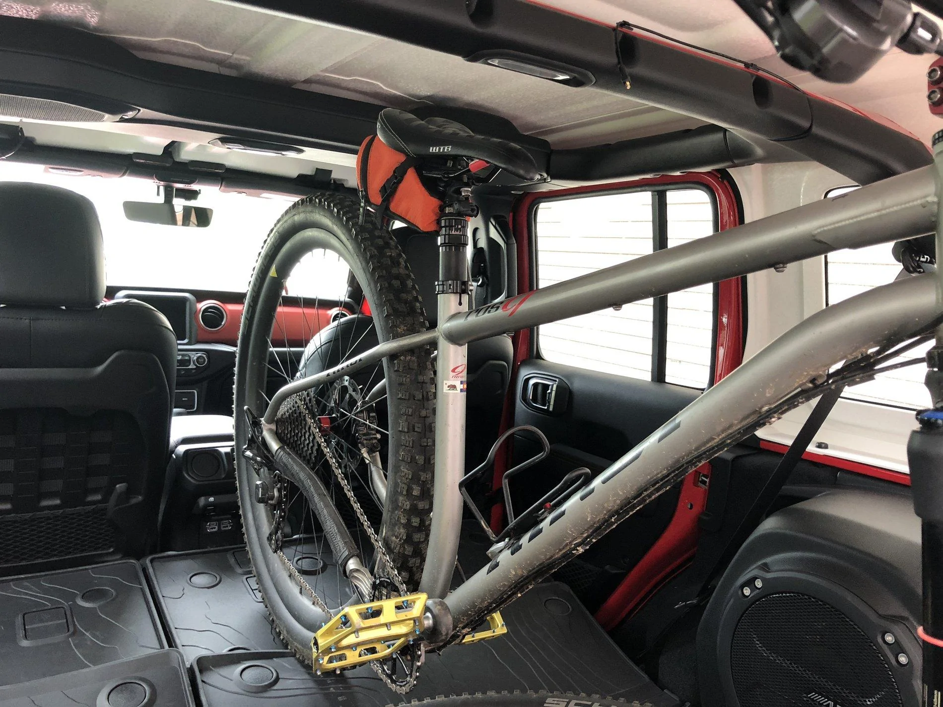

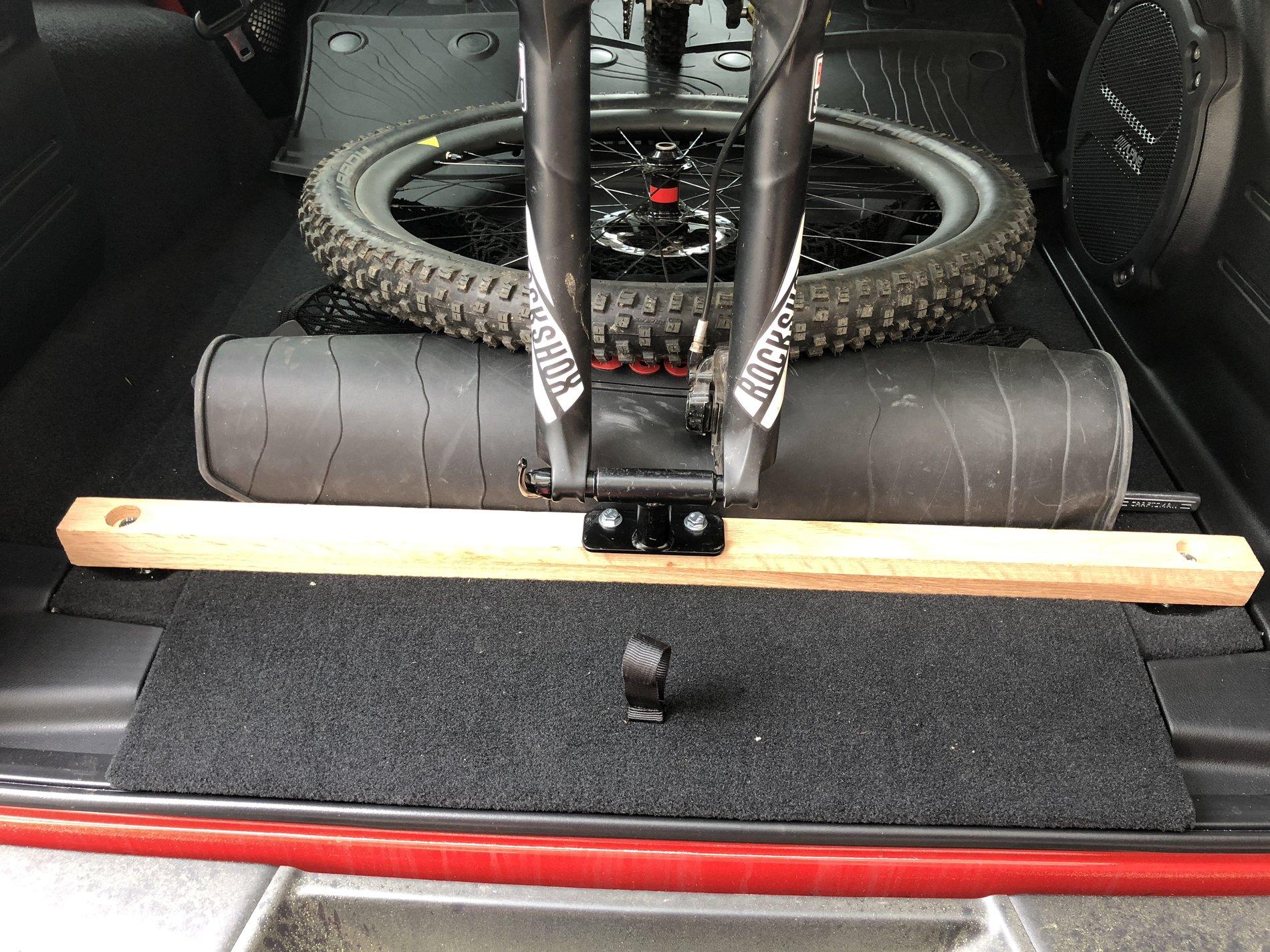

I only need to carry one bike and I prefer to carry it inside the Jeep. Here’s what I did and when the trail rail system comes out I’ll be able to build a better mount.
