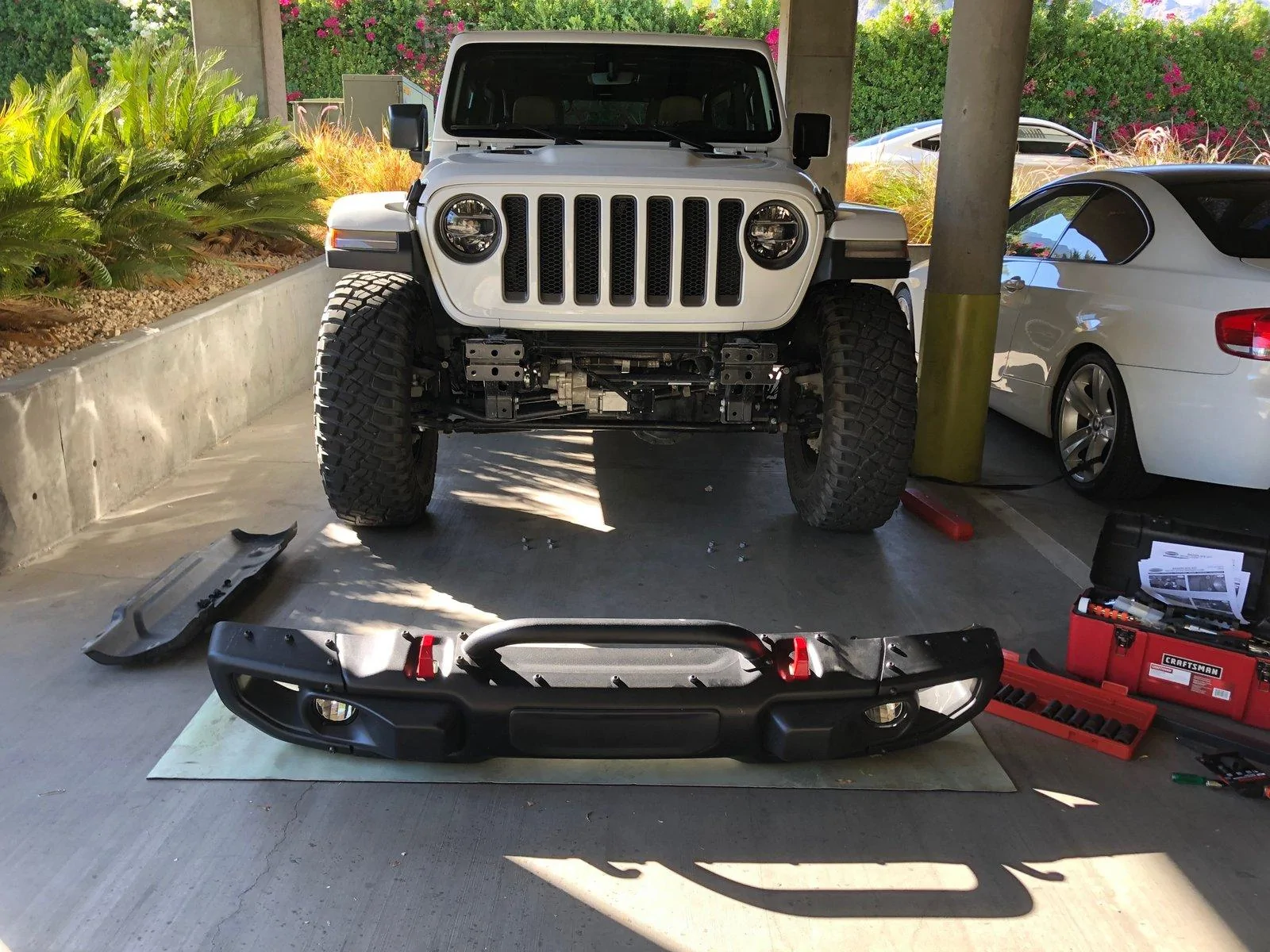

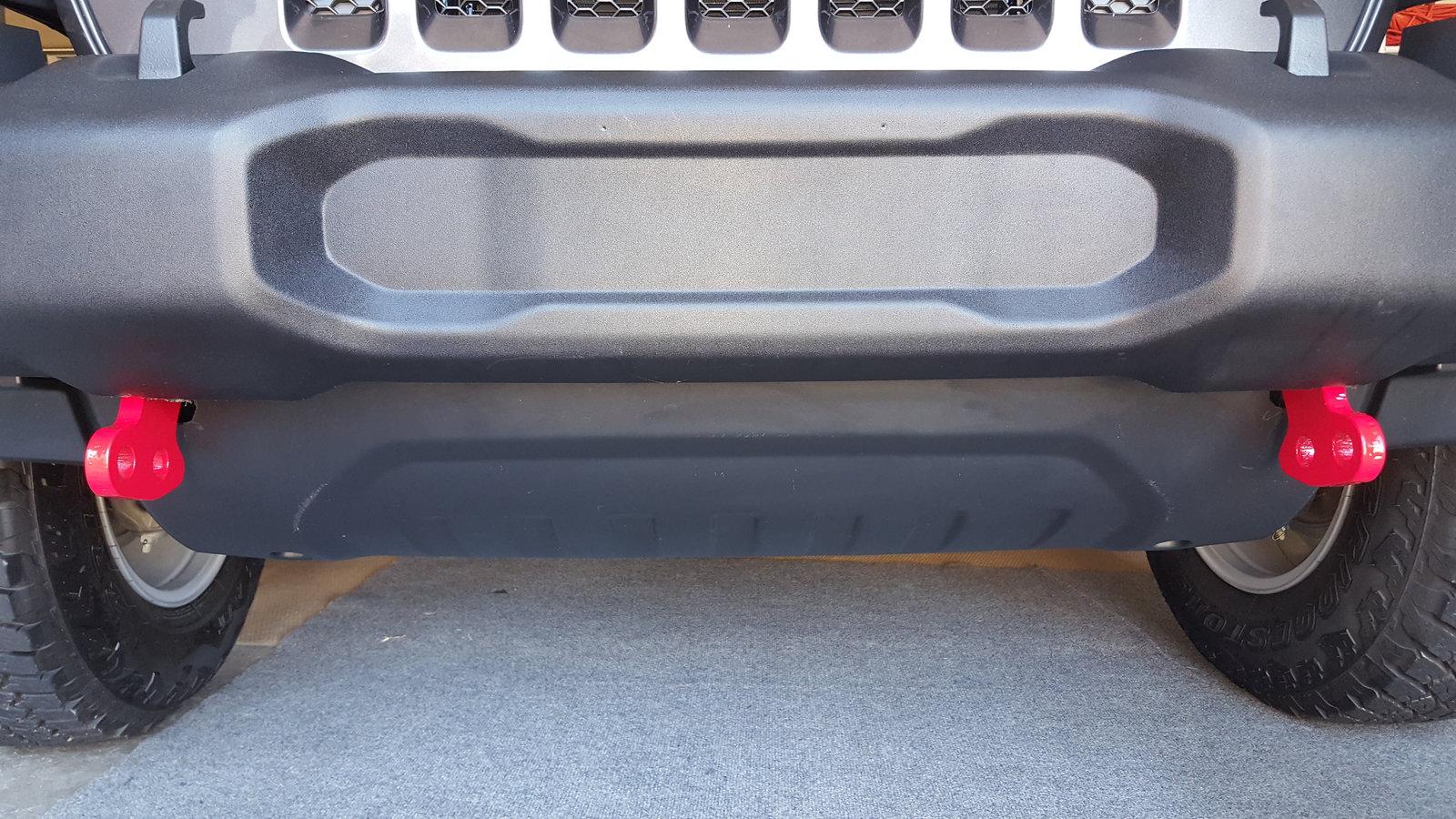

Installed the Maximus -3 tow points last weekend.
2018 JL Wrangler Sport. The installation is not exactly the same as the Rubicon
Bumper but similar in concept and execution. Just make sure you have both shallow and deep well sockets and 2, 4, and 6 inch extensions. There is plenty of wrenching.
I ordered the Blue Ox adapters too.

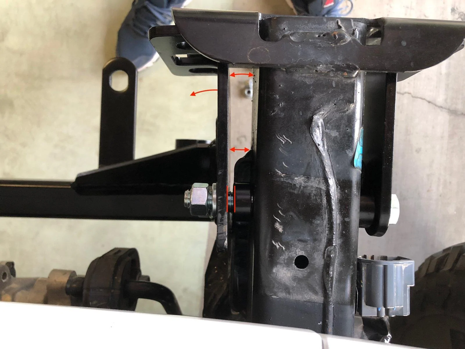

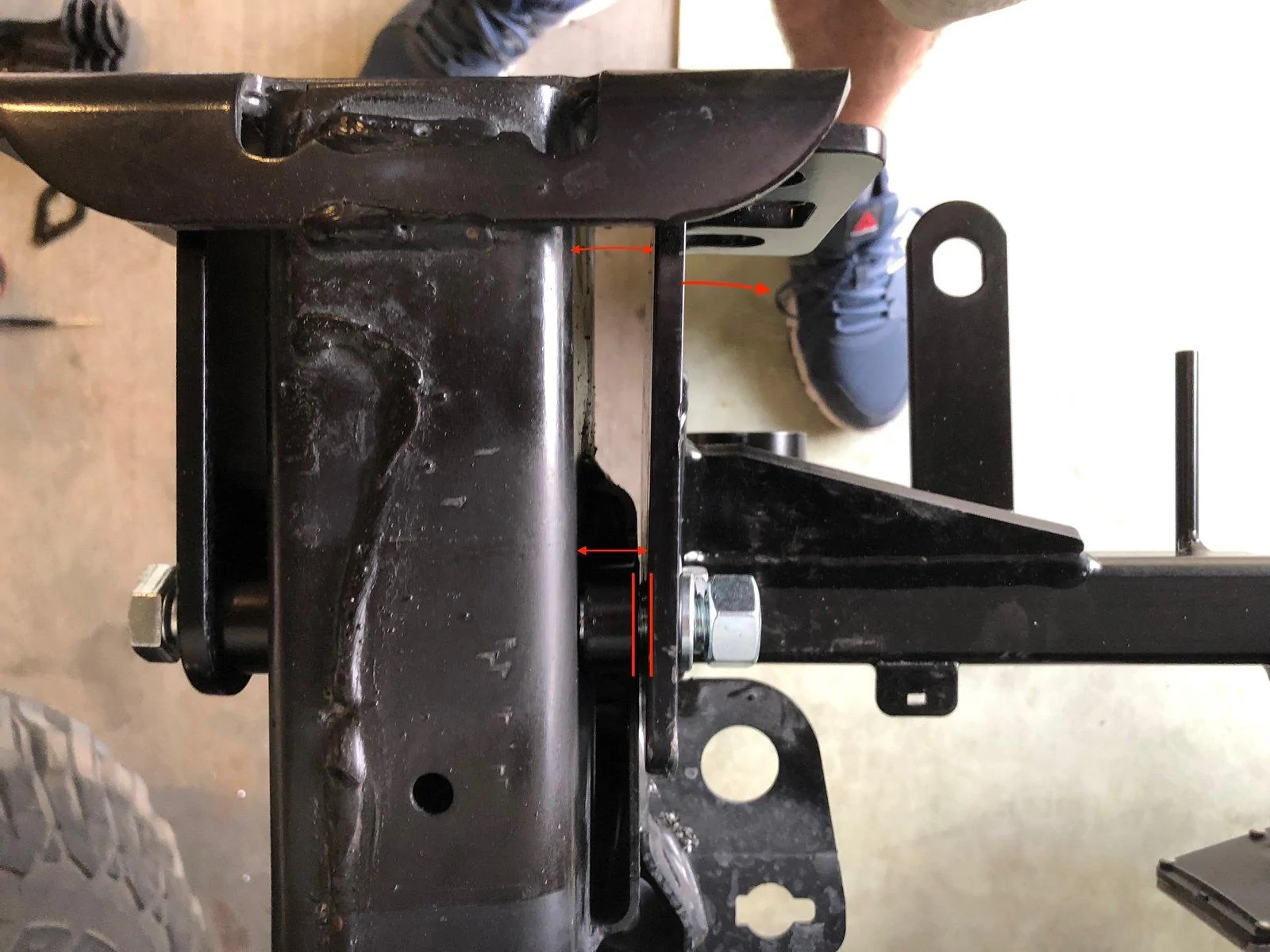

Has anyone here who's installed a Roadmaster tow plate to their 2018 JLU (with steel bumper) had any fitting issues? If you look at the attached photos theres a substantial gap between the sides of the tow bar and the frame of the Jeep. I could solve that with some washers since I do not want to torque the frame rails. However, with the sized of the tow bar being bent in, i cant seem to get the inner nuts on the bumper screws.
Also, I really like that Maximus 3 set up. Their site doesn't show much about this. Does anyone here know if its possible to use them for a Roadmaster tow bar?

I installed the Roadmaster baseplate on my 2018 Sahara. I don't have the steel bumper but did have a problem putting the bumper back on because of the issue you are describing. I noticed the gap in the length of the baseplate but did not fill it with anything so when I torqued the plate it caused my bumper bolts to not line up. I ended up drilling out the bolt holes to get the bumper to fit. ( I wish I had used a couple of washers when I noticed the gap.)

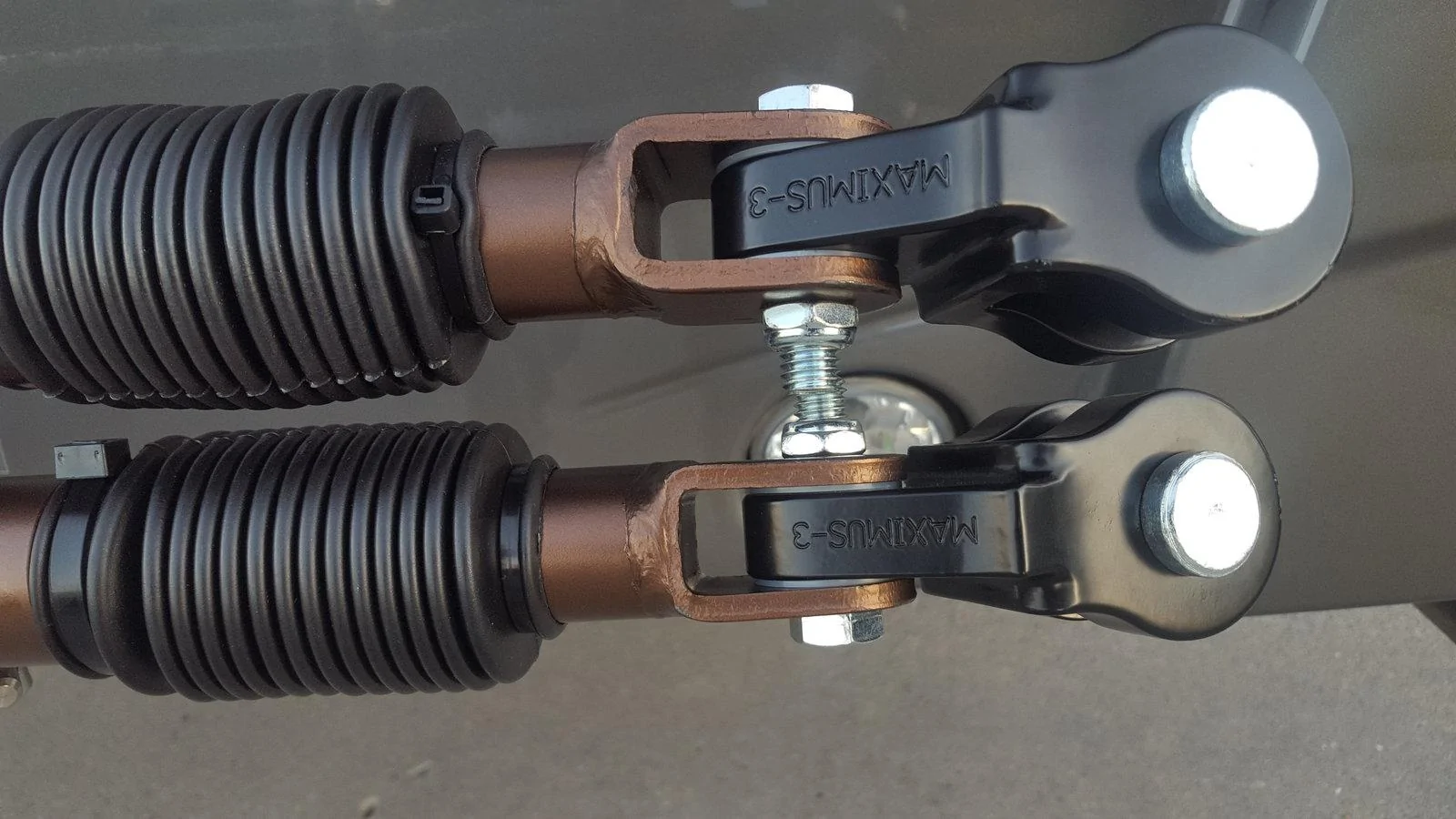

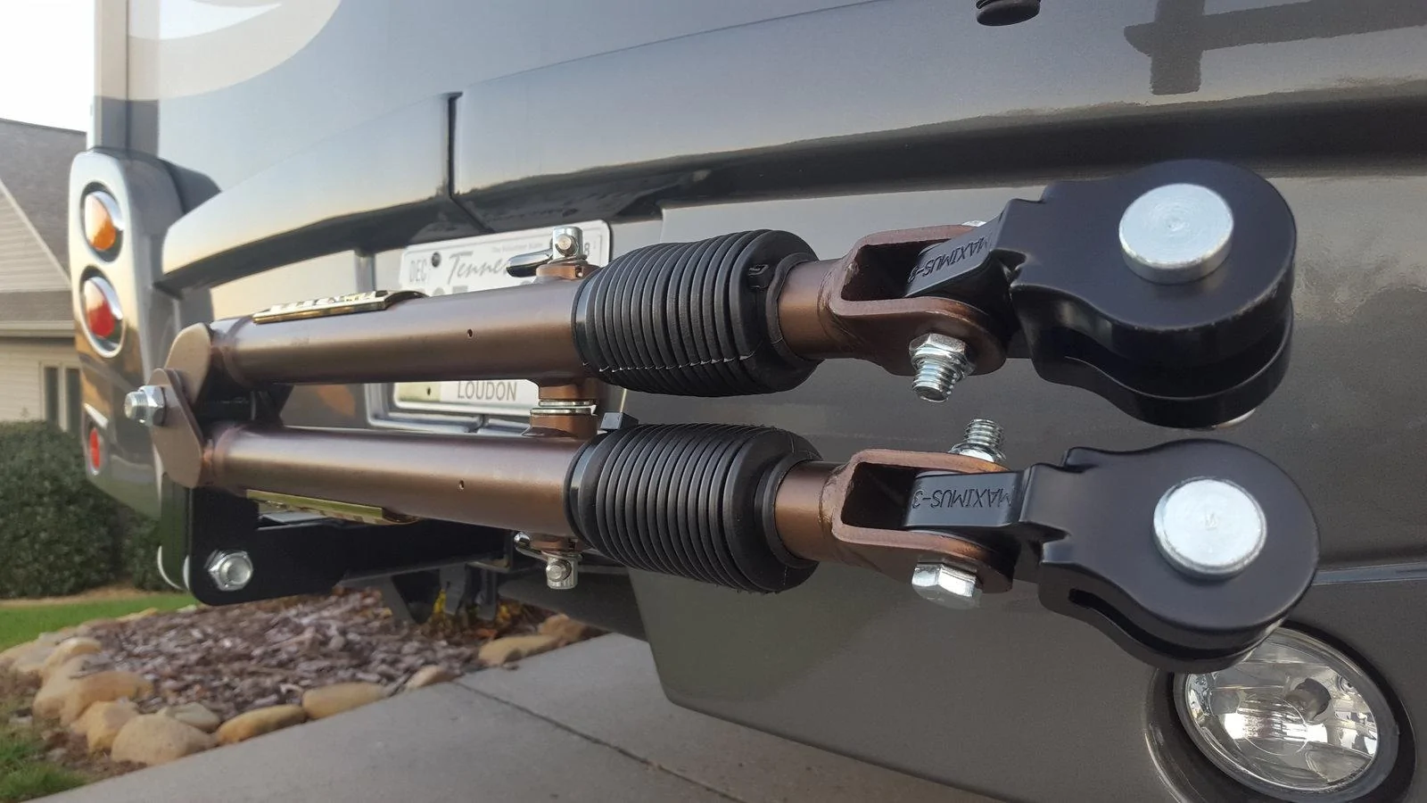

I'm slowly making progress.
Towing with 2015 Navion J Class C Mercedes Benz Sprinter 2500 Chassis, with V6 Turbo Diesel.
Maximus 3 Tow Points.
Maximus 3 Blue Ox Adapters on the tow bar.
6 Inch drop.
Blue Ox Avail Tow Bar.
RVI2 Braking System.
Hoping for Curt or Hopkins Connectorized lighting system for wiring but I have spoken to each and they don't have a release date yet.
Will have to do some splicing I guess.

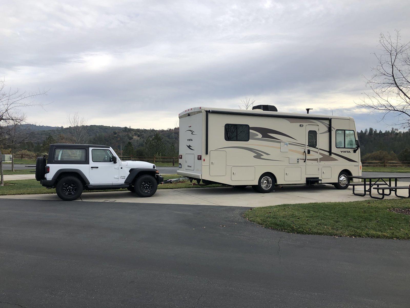

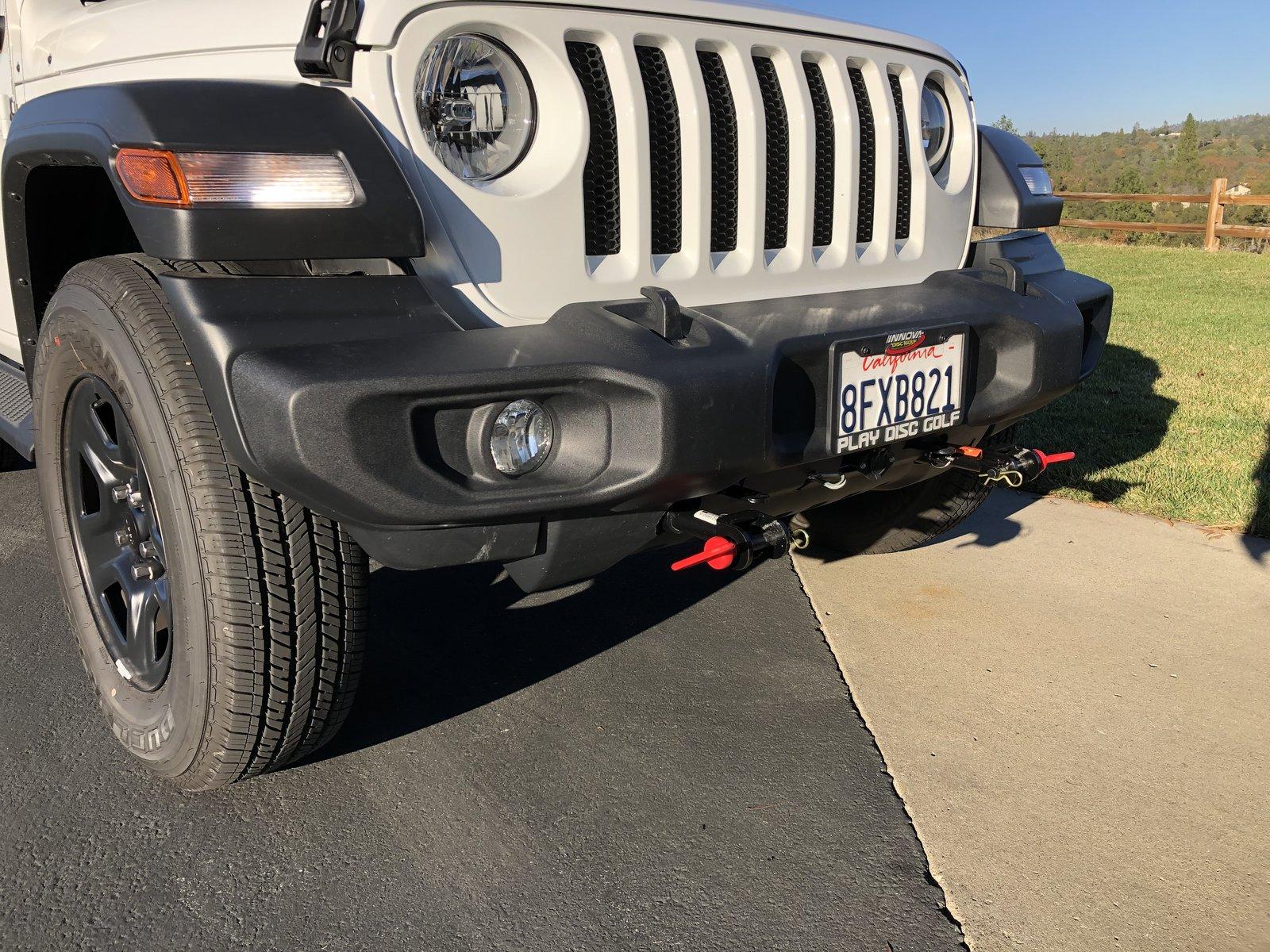

2018 Wrangler JL 2.0 Turbo & 2015 Winnebago Vista 26HE

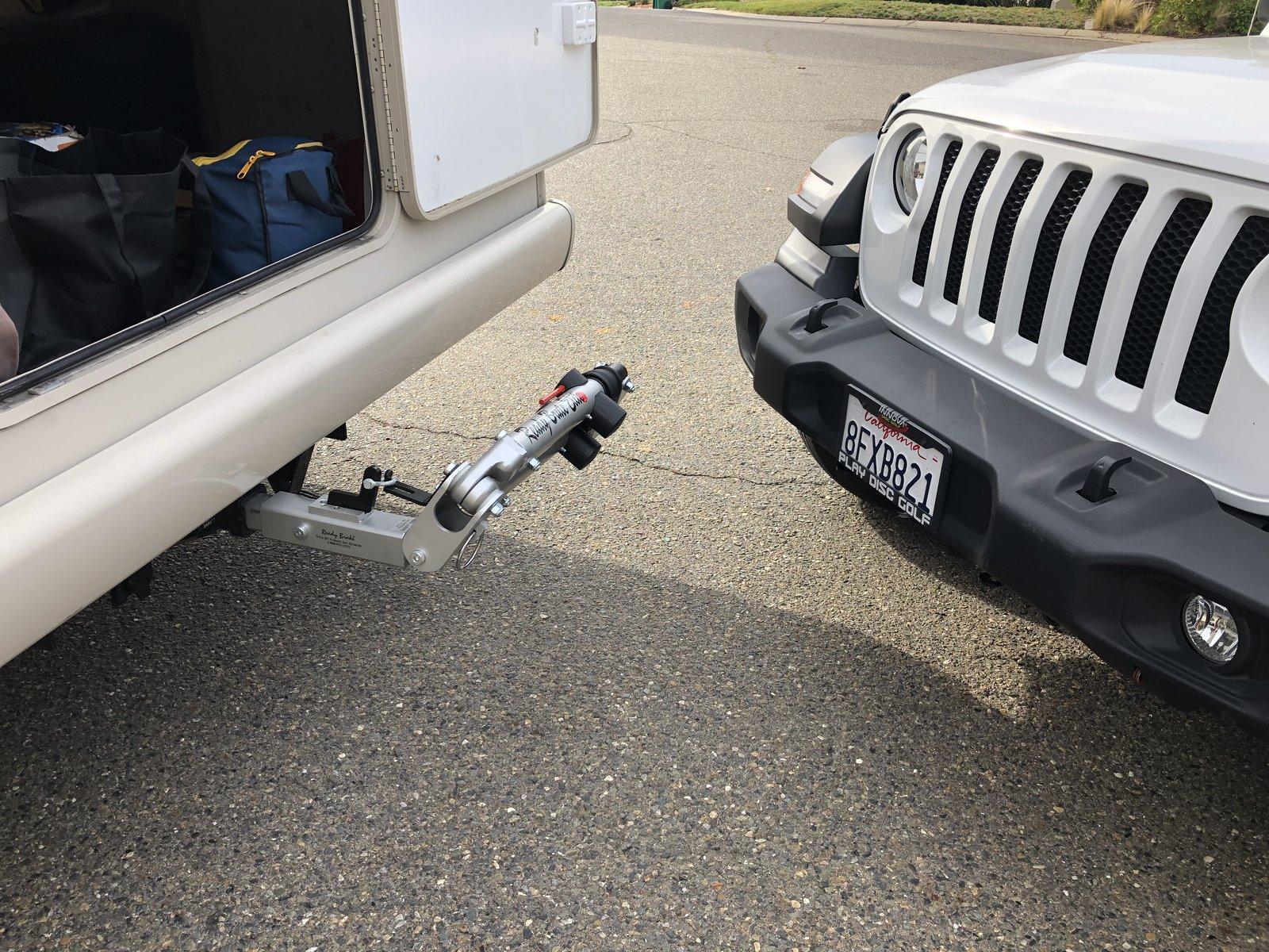

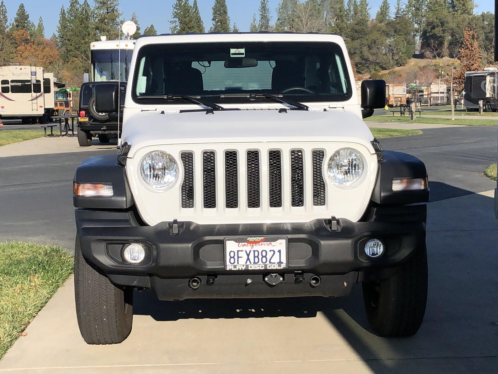

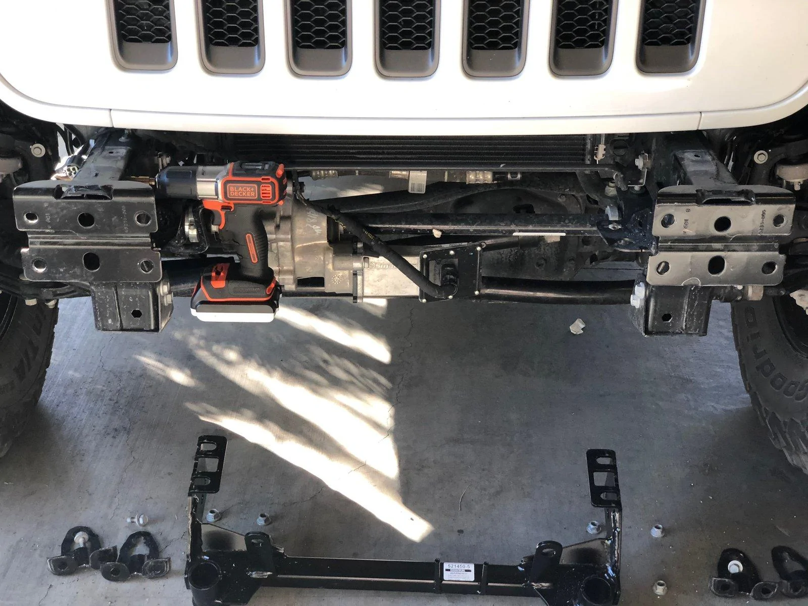

I went with the Roadmaster base plate and Roadmaster wiring kit.
I used the ReadyBrute tow bar setup and the Ready Brake break away kit
The baseplate kit was very well matched to the JL and I measured and used a hole saw the keep the shield minimally cut for a super clean install look
