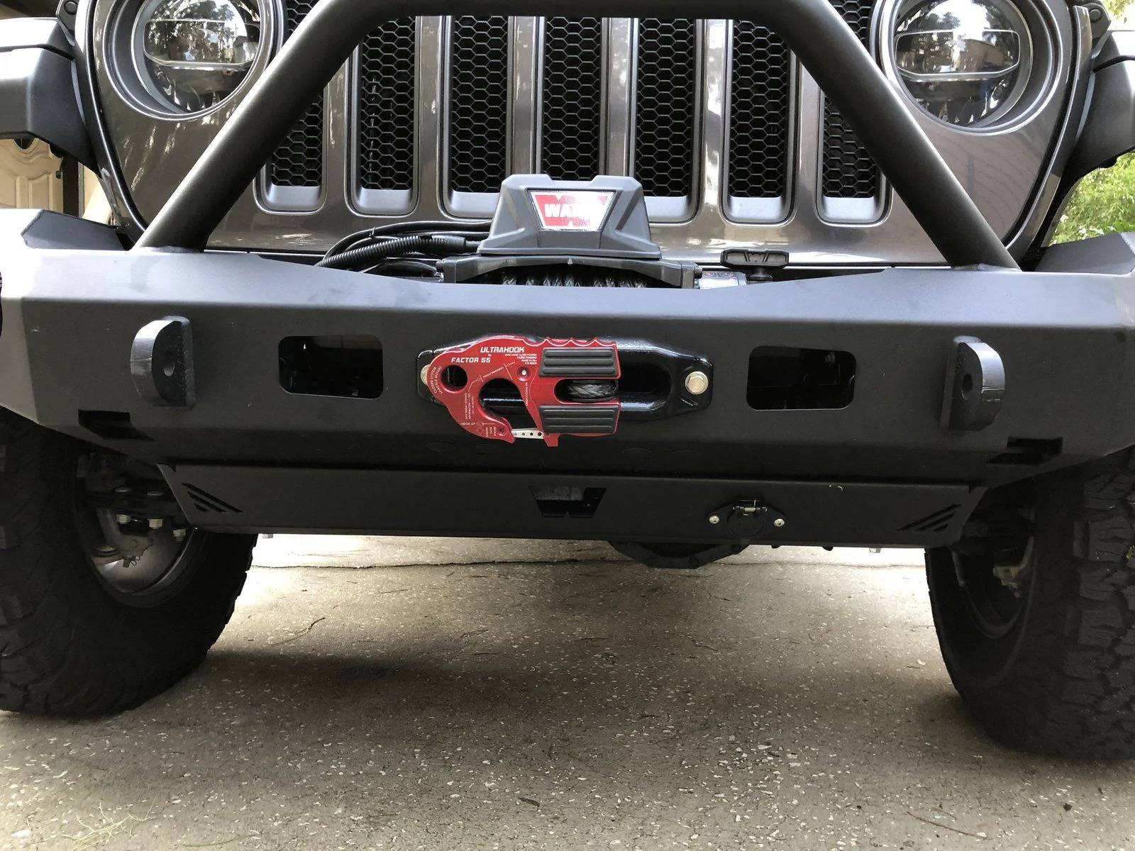

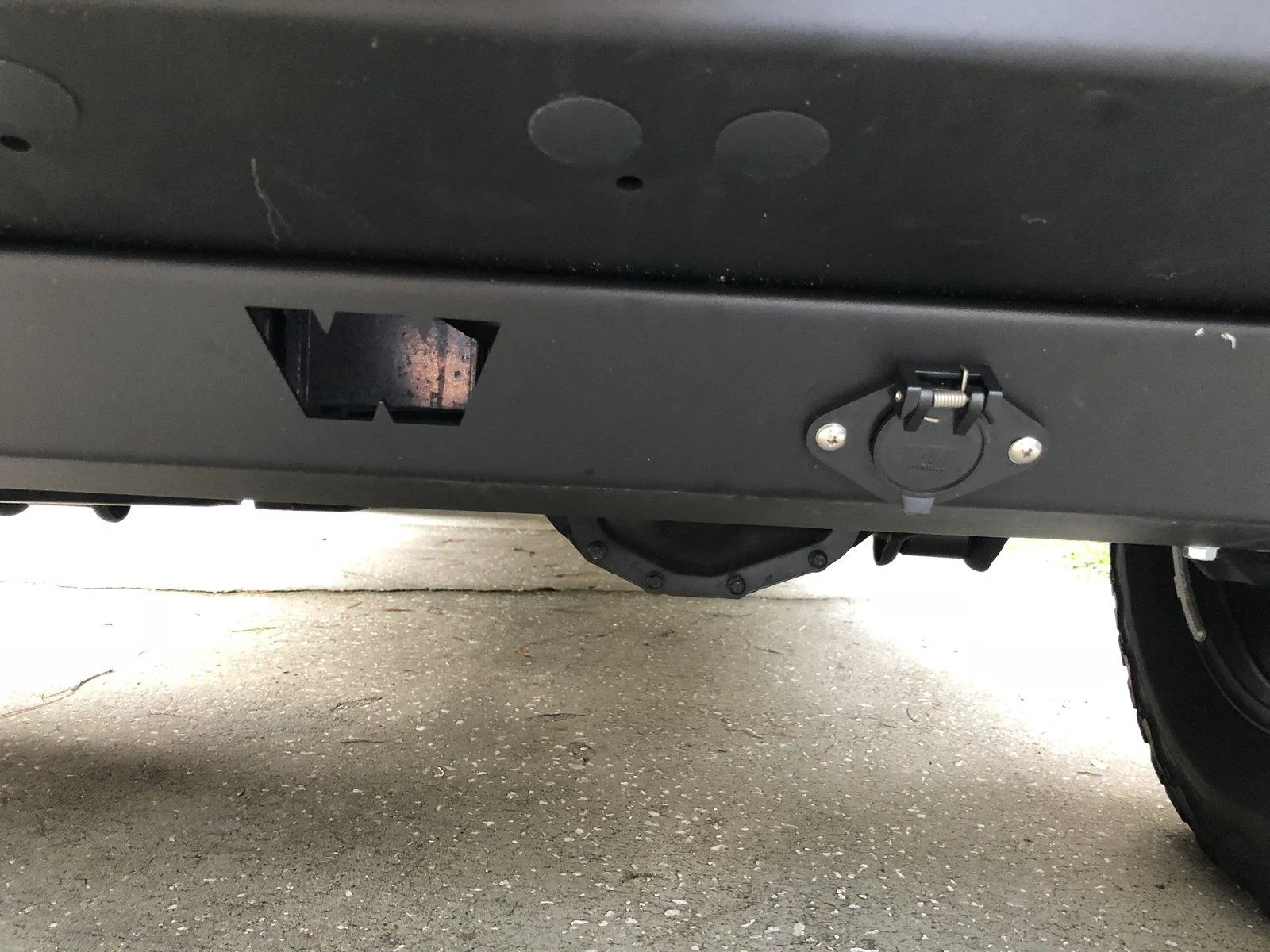

Thought I would share my latest winch and tow loop set up on my JL. Winch plate, winch hook anchor, filler trip plates, and JL tow loops from www.maximus-3.com. Winch is the Rubicon version of the Warn winch but I bought from www.moparonlineparts.com as they seemed to have the best price at the time and had it in stock.
Tow loops are not on the Maximus-3 website yet due to very limited quantities but they are heavy duty and fit great - I think they are the cleanest setup I have seen. Did not want a square-tube bar mounted under my bumper for towing. You do have to cut slots in the bottom side of the bumper but that was not too hard as long as you have a metal cutting hole saw ($10 at ACE Hardware) and a cut-off wheel for your grinder. The instructions included show using a 1.5" hole saw and making a 1.5" channel in the bottom of the bumper. With the tow loop being 5/8" thick, I chose to use a smaller 1" hole saw and cut a 1" channel and had no problems (forgot to take a picture of that).
On the winch plate install, I did have to do a little grinding on the winch plate to make it fit. Mainly because there was some excess weld on one side of the Jeep near a bracket and that bracket on the Jeep appeared to be in a slightly different location from the left side vs the right side. Maybe 1/16" different but that was enough to need to grind down the winch plate slightly so the bolt holes would line up (did not want to grind on the Jeep). Easy fix though.

I called Maximus-3 directly and ordered the JL Tow Loops over the phone. The guys there are super helpful. $199. I wanted black but they were out and only had one set of red in stock. I ordered the red and I actually glad I got the red after installing with the other red accent pieces on the front bumper.

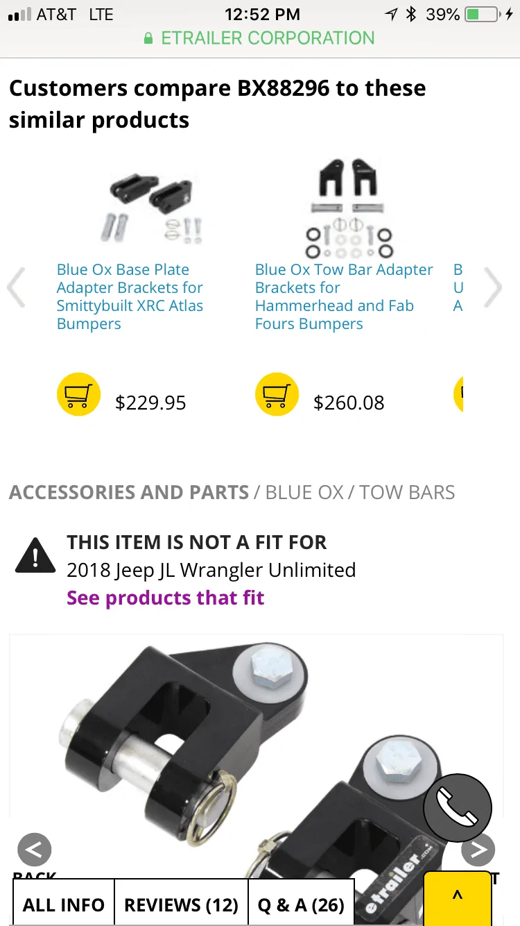

This looks awesome. I put the blue ox tow bar adapter on and it is WAY too low, I've hit it more than a few times. Totally willing to pull that in favor of this IF it can be adapted to BlueOx towbar.... I have a message into them to ask.
Biggest problem is going to be pulling the adapter currently on the jeep. I used red loctite and it's going to be VERY difficult to remove....

Just do a search for Blue Ox adapters, you'll find a number of them.
Maximus 3 that sells the tow lug actually has adapters for the blue ox bar as well. Just fyi
