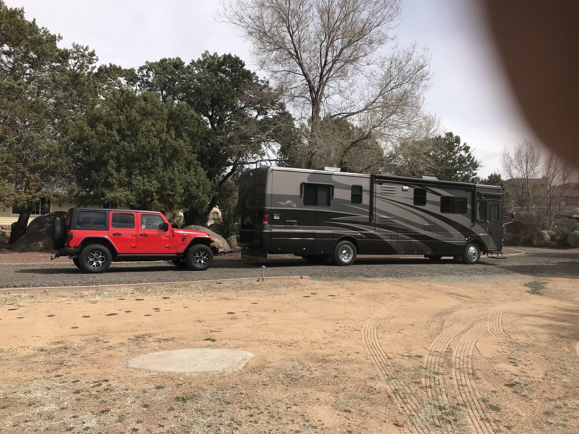

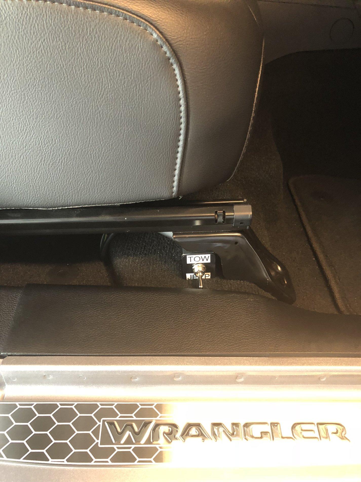

Excellent Dcmtfam - I just towed the Jeep from Fresno to Pismo Beach, CA.( 300 miles round trip). Towing & Lights(with the Cool Tech) performed perfectly. Definitely the way to go. Goodbye magnetic lights.cmcclintock...I just installed the Cool Tech harness. Was fairly straightforward install. Works awesome.

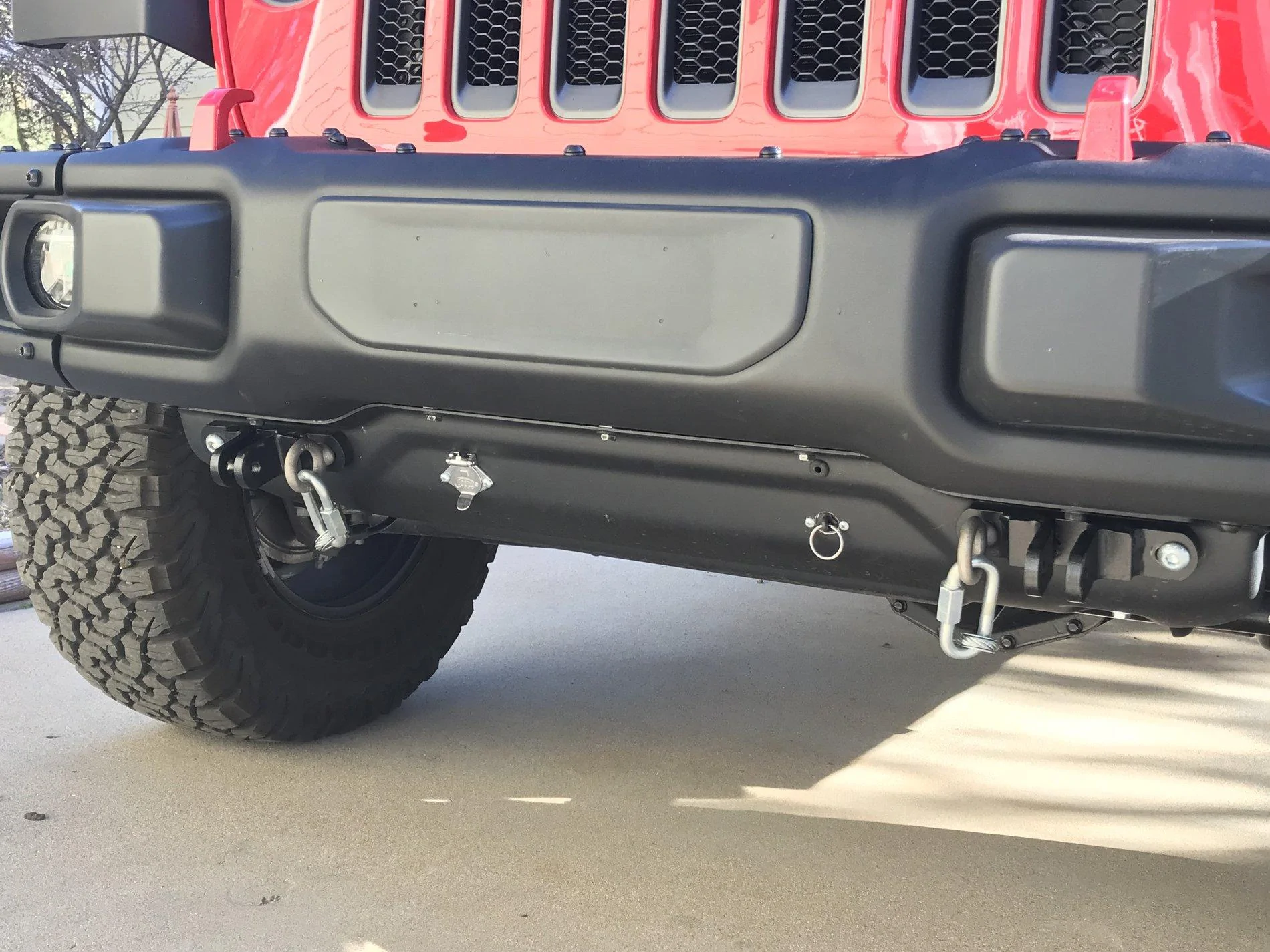

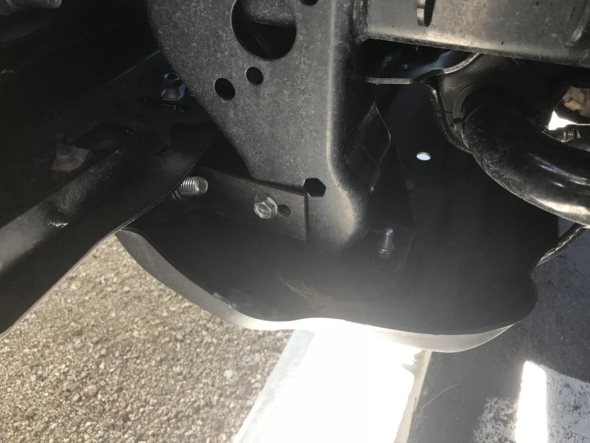

I like this but what did you do to get back to the frame - there's a bit of room that low behind the skid plate? And what tow bar will you end up using?
I used a 1/4” x 2” strap bent to fit from one of the bolts that’s holding on the Rock Hard Blue Ox tow tabs back to the frame. See the attached photo. The factory steel bumper and skid plate are plenty thick and attach directly to the frame and all the bolts are hardened metric equivalents of grade 8. The system is plenty strong. I also used some Blue Ox safety cables looped around the frame back out to the safety chain loop just for extra security. I have the blue ox tow bar.
