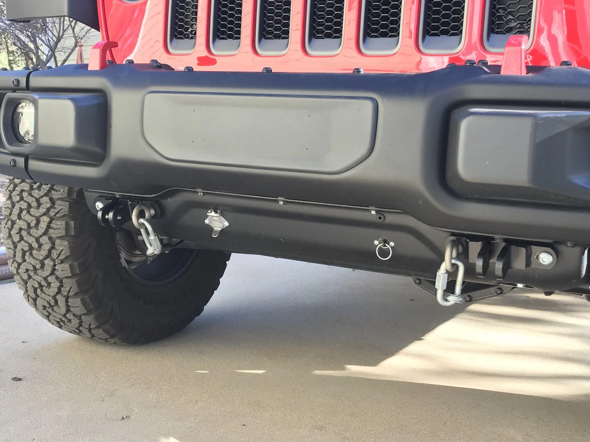

Here’s my completed tow bracket setup on my JLUR with the factory steel bumper option. I installed some Blue Ox tow bracket safety cables to go from my brackets and wrap around the frame just for an added layer of protection. Took it on a nice bumpy test ride and everything worked great.

So, you have no base plate attached to the frame? You have 4 bolts into the steel bumper that secure the females where your draw bar attaches. I have flat towed Wrangler's (behind Class A) for thousands and thousands of miles. I question your type of set-up versus a baseplate install. I myself will go with a baseplate install. Admit in the pic your install looks pretty but...
To each his own I appreciate your concern

I have towed my 2007 JK Unlimited that I bought new for well over 20,000 miles Behind my 39 ft DP. This set up is a replication of the tow plate made by Currie industries.Behind the bumper I added two straps to the frame as well as safety cables wrapped around the frame going to the brackets. I’m comfortable with it.

Yes, to each his own as you say. Curious, why you did not opt to go with a base plate set-up versus your steel bumper mod ? Trying to save ?, got tired of waiting for base plate offerings? .....

Always liked the Currie tow plate option for the JK. When I saw how substantial the steel front bumper and skid plate were on my new Rubicon I decided to replicate the Currie application. I wasn’t going to replace my front bumper and I don’t care for the looks or the clearance issues on the base plates for Wranglers. Besides anybody can put a base plate on. What a conversation piece this is around my jeep buddies.
