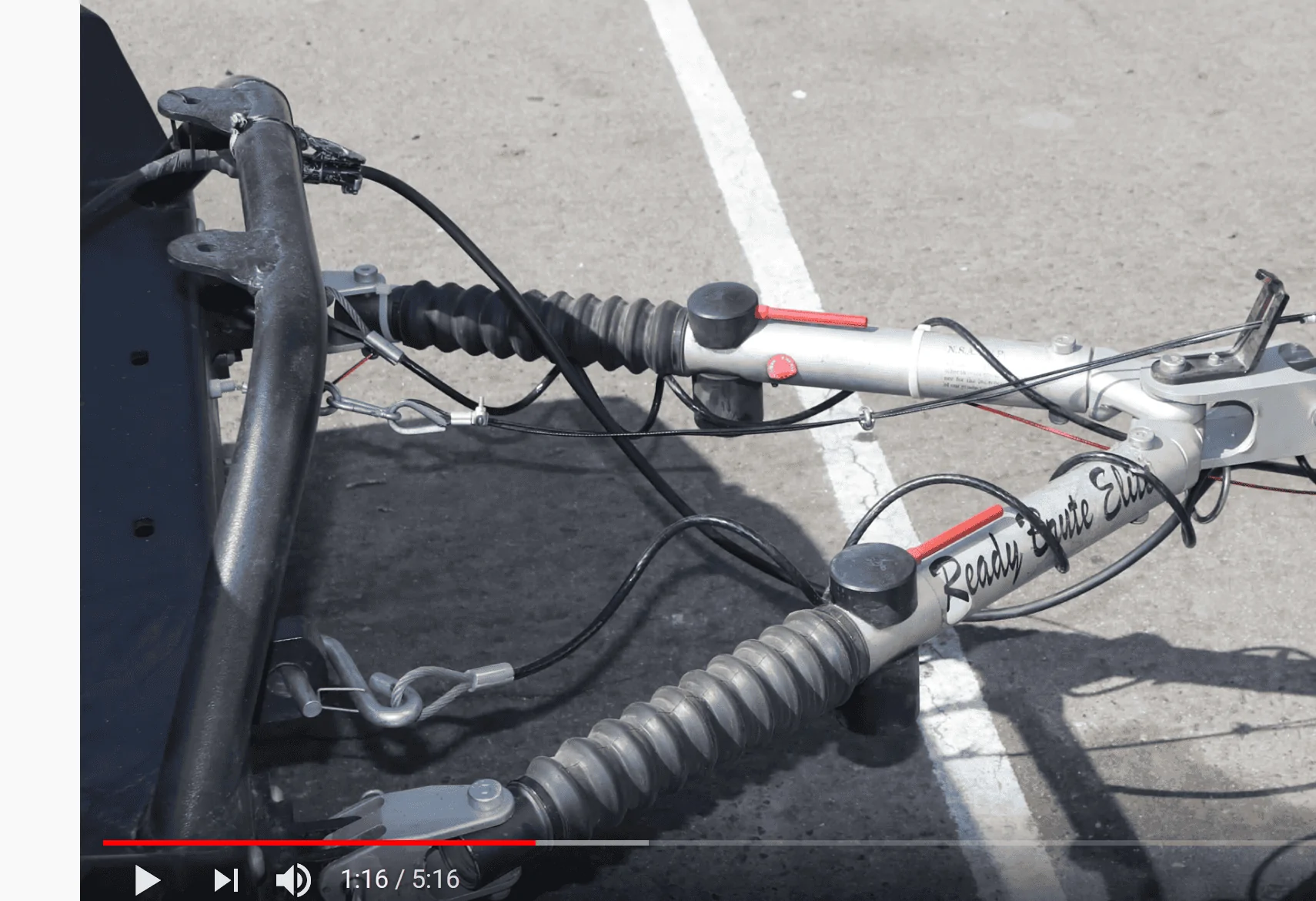

The problem is if the tow connection on the maximus and the safety connection is only 1" away and is so close it is subject to damage if the tow connection is damaged. Look just takes a rock hit or scrape to potentially damage the Maximus loops (both potentially since they are so close). Tow bar connection do occasionally brake.
Again -- I am asking you to research...all the companies connect to the same structure. Most have it within 1". Some have it as far as 4". Doesn't matter how close or far...it is the same metal. All the companies use less metal than the Maximus3.
I did the google search, and posted a video link below of ReadyBrute Force - another player.
Watch the whole video here:
Here is a screen shot
Jeep Wrangler JL Best Setup for RV Flat Tow Annotation 2020-03-09 165204
And to address your earlier comment. I am *NOT* an engineer. I do have common sense, and ability to look on the internet and see how other companies are doing things. I also have taken the time to call Maximus and discuss the connection *prior* to my purchase, and ensure that it was tested and certified for use as a tow point.
It was during this conversation with the company that designed, and insured the product for this application, that I learned just how over engineered it actually is.
I chose to stick with my Roadmaster tow bar since Blue ox does not service tow bars that are older than 10 years, and they have such a high failure rate. I had the same discussion with Roadmaster, and they reviewed the Maximus connection and said that it was a good option. Of course they wanted to sell me their solution, but readily admitted the Maximus looked better and offered many more features.
I don't post this information for anyone to take at face value. Its on the internet, so it should be checked and verified. Forget all the "theory" - go to the source. Talk to your towbar company. Talk to Maximus.
So a Vlogger is your AFICIONADO. Look no one is arguing that the Maximus is not a good tow connection, it just lack good safety connection. Look all they had to do which some have done on their own is add and eye bolt or plate at once of the frame bolt connections as that removes the safety connection from the tow connection. Easy peasy, would cost Maximus another $5 max to provide that. But I suppose that ti high a price for added safety and compliance.
