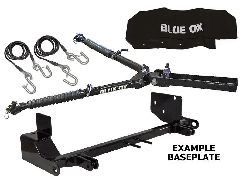

I challenge you to post a single solution that is sold that uses a redundant safety point.
Jeep Wrangler JL Best Setup for RV Flat Tow std_alpha_2_bundl

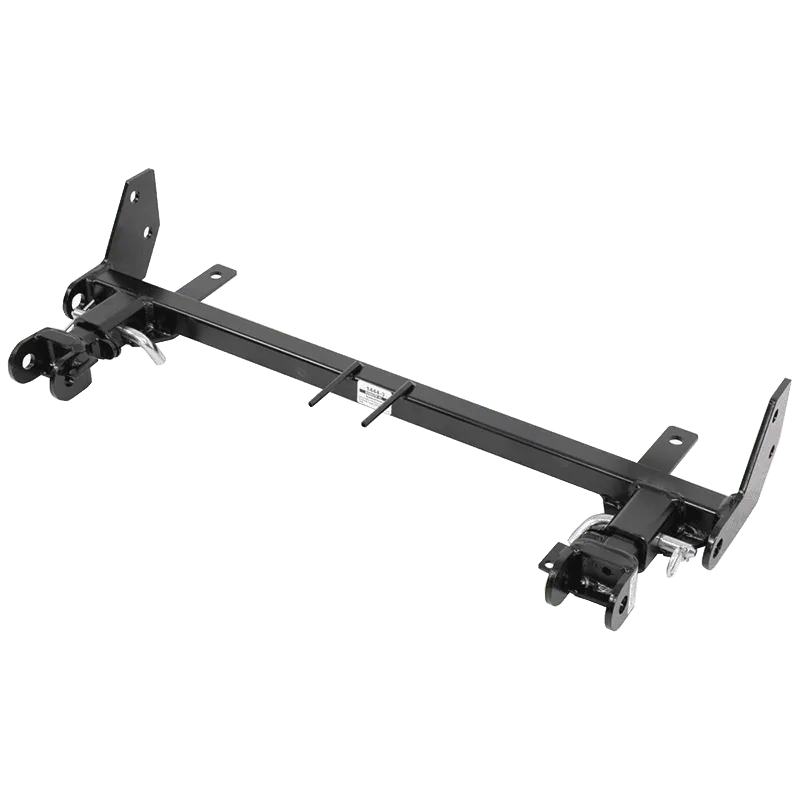

This is blue ox.
Jeep Wrangler JL Best Setup for RV Flat Tow 0002515_roadmaster-13-18-jeep-wrangler-crossbar-style-base-plate-kit-with-removable-arms-1444-3
This is Roadmaster.
Combined they are over 80%of all towbars used on the market.
Just for completeness here is the other major player
Jeep Wrangler JL Best Setup for RV Flat Tow Screenshot_20200308-135025_Amazon Shopping
That is the demco.
All of them use a single point for towbar and safety bar.
You only have a single frame that you are pulling. There is only one place to connect to the frame.
The Maximus is 100% as safe as the others posted. It uses heavy duty bolts and much thicker steal than other tow bar base plates because it is meant to do more than they are. It is a jack lift point, a tow recovery point, and a towbar connection.
