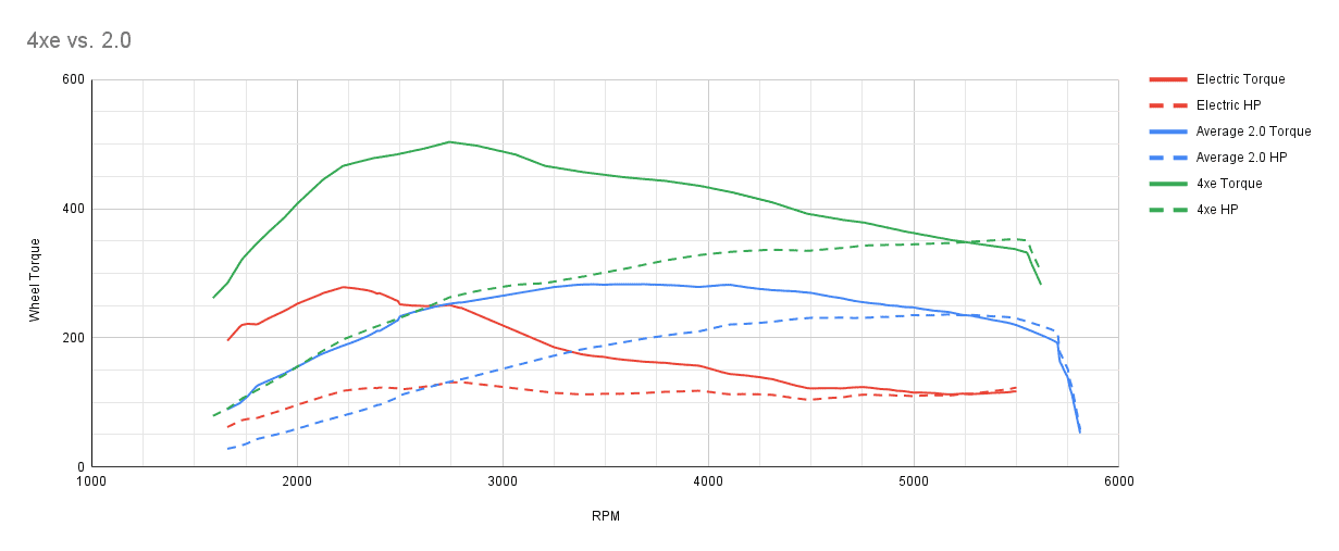

Dyno chart for 4xe - ref for how the torque curve compares to a regular 2.0. There is a ton of low end torque (not ecodiesel level, still way more than 2.0 and 3.6)

No way is that dyno of Wheel Torque according to the labeling of the X axis - that would put the 4xe over 600ft lbs of torque at the engine, depending on dyno.

The green line is the actual torque. The other two is the split up of what comes from the 2.0 engine and what part comes from the electric motor. On the x axis the green line peaks out near to 500 - which is basically close to the 470lb torque rating of the 4xe.

I get that piece. I'm just saying it states 'wheel tq' - or at the wheels - on the graph. Companies quote engine hp/tq. With 4WD you will see at least a 25% drivetrain loss and even if dyno'd in R/2WD it would be 20% loss. This would put the 470 engine tq in the 350-375 wheel tq range - nowhere near the 500 wheel tq range in that graph.
Unless that graph is mislabeled, and it is showing 'engine tq'....

not my graph. This was shared on the engine and gearing chart thread as input to updating AnnDee444's gearing calculator.
Could be just a typo on the x axis label - as the 2.0 torque curve matches what we have seen before from other's reportnig their dyno
