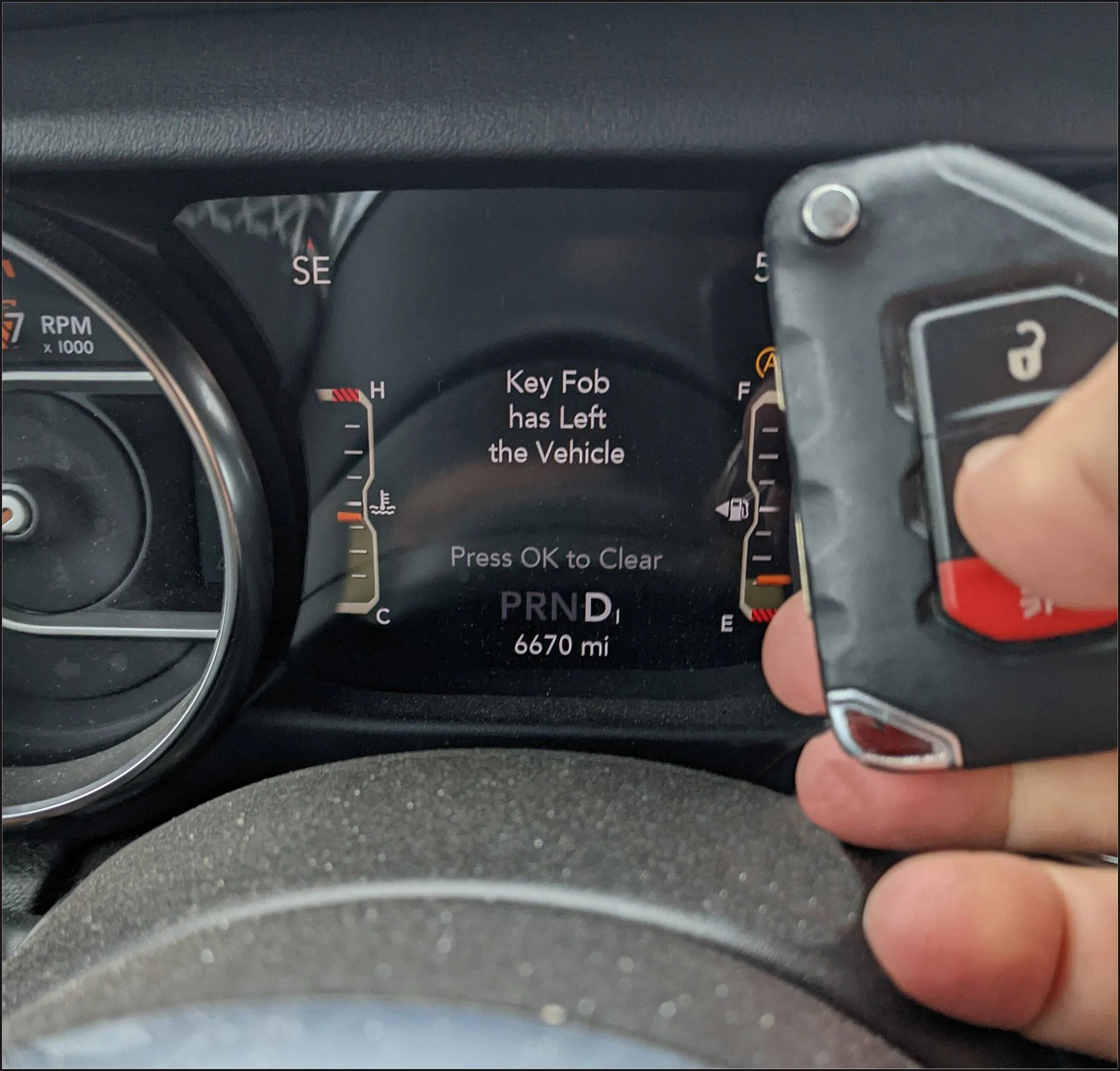

Key Fob has Left the Vehicle ... when your fob is in the vehicle, replace your fob's battery!
Jeep Wrangler JL Be aware...  Keyfob battery will bite you. 567gvhbn
CR2450 Fob battery... Whether you have a clunky factory fob or a custom design, smaller Threedom fob, you will need to routinely replace your fob battery.

interestingly, i had just ordered replacement batts when this thread came up.
i have noticed that now that i've had my rig approx 2 years that the range on the Remote Start was getting down to under a few hundred yards, whereas when everything was fresh it was much more.
(FWIW, i've always kept my fobs in a little RF-proof storage when at home.)

Keeping that spare battery in the jeep, with all that heat will kill it's shelf life. Usually, the Fob will start acting up, by saying it isn't being detected, intermittently, before the battery totally dies.
Or in the cold will deplete the extra batteries.

As per the owners manual, you can start the jeep using the fob to push the start button if the battery dies.
Have had to do this when the fob battery was so cold it would not function and it works perfectly. Had a bit of anxiety once when for the same reason the fob would not unlock the doors... until i remembered the key. How could i forget about the key when it always seems to want to deploy like a spring-loaded jackknife?! LOL

I've never seen the 'fob has left the vehicle' warning and it died last week. I couldn't start it by pressing the fob on the switch either, but I may have been using the wrong end ?!?. Anyway.....I had the spare fob in the house. Battery now changed out. All good !

Undoubtedly, you used the wrong end of the fob... or you did not have your foot pushed down firmly on the brake pedal when you were pushing the correct fob end firmly into/on the start button.
As for Evic message, key fob has left the vehicle or message indicating battery on fob is a muck is not always lets say a given. You may not see such a message.
For your own edification, do consider removing the battery from the fob that you originally tried and try again to start your JL, doing as I just mentioned..
