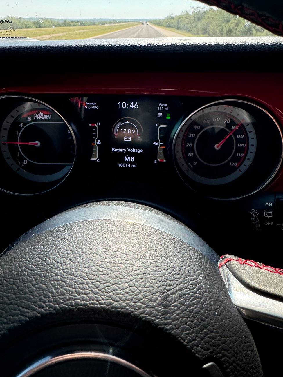

Battery Voltage Too Low?

i would have expected the battery voltage to be around 14V while cruising, I’m getting 12.6-12.9V. Any thoughts or experienc?

I see similar numbers, occasionally going up to 14.1v.
Aux battery deleted, diesel, 2021. It’s a little disconcerting but has been like that for as long as I can remember.

i would have expected the battery voltage to be around 14V while cruising, I’m getting 12.6-12.9V. Any thoughts or experience?
12.8V is just above what I'd consider a healthy resting voltage when the vehicle is parked and off...but not when driving (at any speed.)
If you've the original battery in your '19, consider this a possible sign that it's nearing the end of its practical service life.

I think the battery management system turn the alternator nearly off to save fuel when it can. I've noticed if I charge my batteries fully then I'll see 12.6-12.8 ish on the dash display. If I don't and use the starter to prime the oil canister, then I'll see 14 ish volts after starting.

i hope when you wrote "battery" you meant "batteries"; you want to replace them both together because one going bad will drag down the other.
fortunately it's easier to access the Aux Batt in the Diesel than in any other configuration; the Aux Batt is in a nice little compartment under the Main Batt accessed via a little trap door. just remember to rest the IBS after you've reconnected Batts and expect it to take several full Cold Starts before Voltage begins to be reported as normal.
there are also volumes written here about how to Delete that pesky Aux Batt, if you're interested.
if you search on this forum you should be able to find reams of detail about the charging systems on these thing; they'll charge hard (up to 14.4/14.5V) when coasting down or when the batts are not fully charged, and that Voltage will drop down a couple of Volts lower once they're charged up, so reported Voltage regularly fluctuates.
(unrelated to your question,) what i want to know is; why are you in Manual 8th gear at that speed?
why not just leave it in D and let that awesome 8HP75 trans do its thing?

12.x volts is normal once the battery is fully charged. It will be at 14v when the battery is charging.

Totally normal. I see mine in the upper 12.x range to 14.x depending on state of charge on the battery.

Thanks for all the responses, makes sense.
