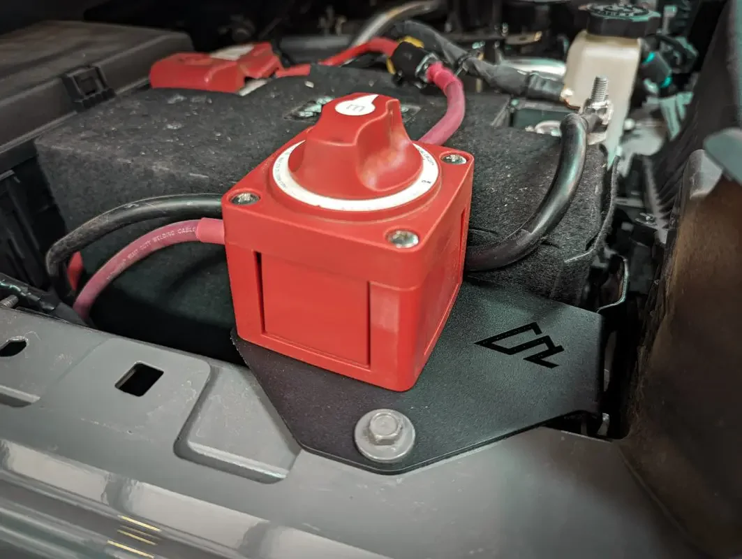

My Smittybilt winch instructions says wire direct to battery. I'd feel better if I had a disconnect switch on the positive terminal near the battery just in case of front end crash, possible drain, etc. My intent is to have the switch 'off' all the time and open the hood and turn switch 'on' when I use the winch (or maybe should use Aux 1 + relay?).
The Badland 12K winch even includes such a switch, and there are lots of clean out-of-the-box options (switch + mount) for 4Runner, but not so much for Wrangler.
Can you guys show your clean solutions? Thanks!

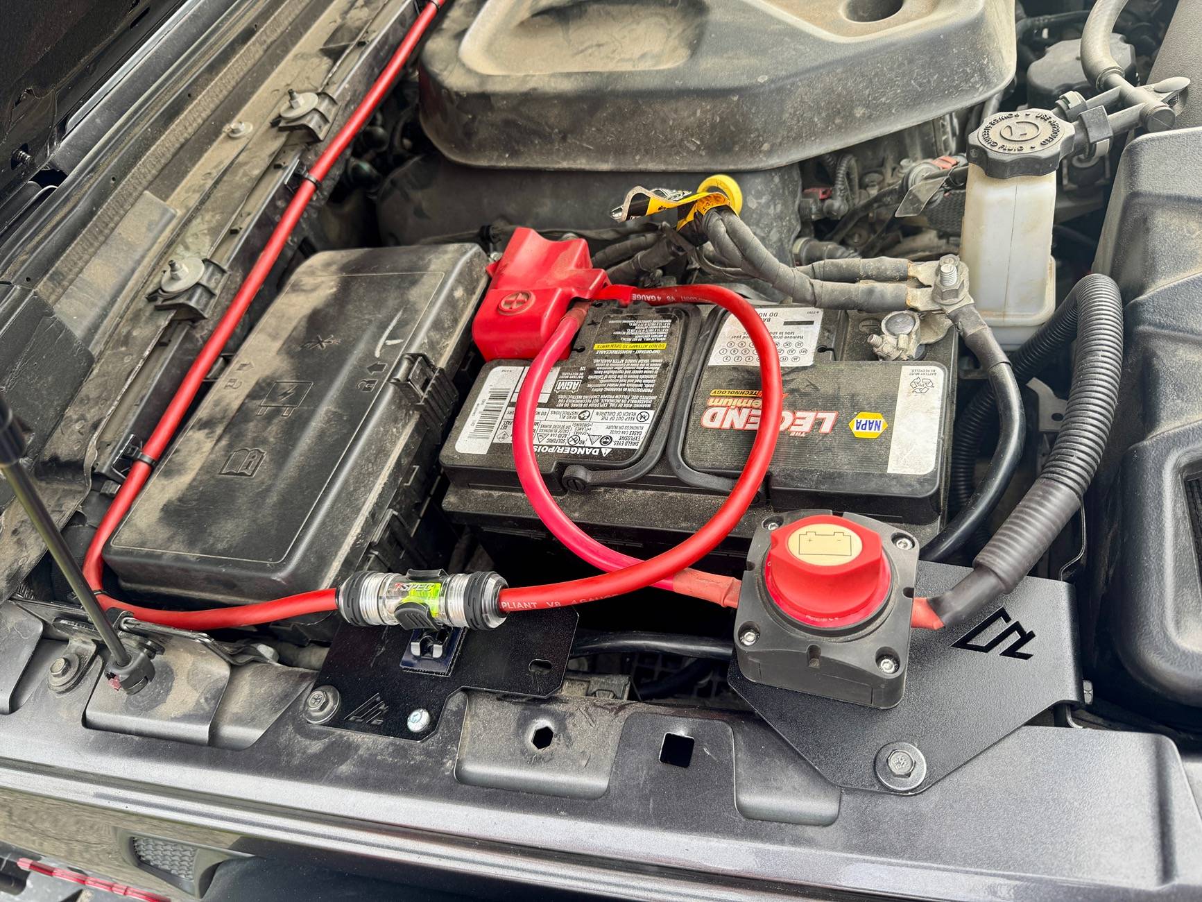

Badland switch on an American Adventure Lab bracket.

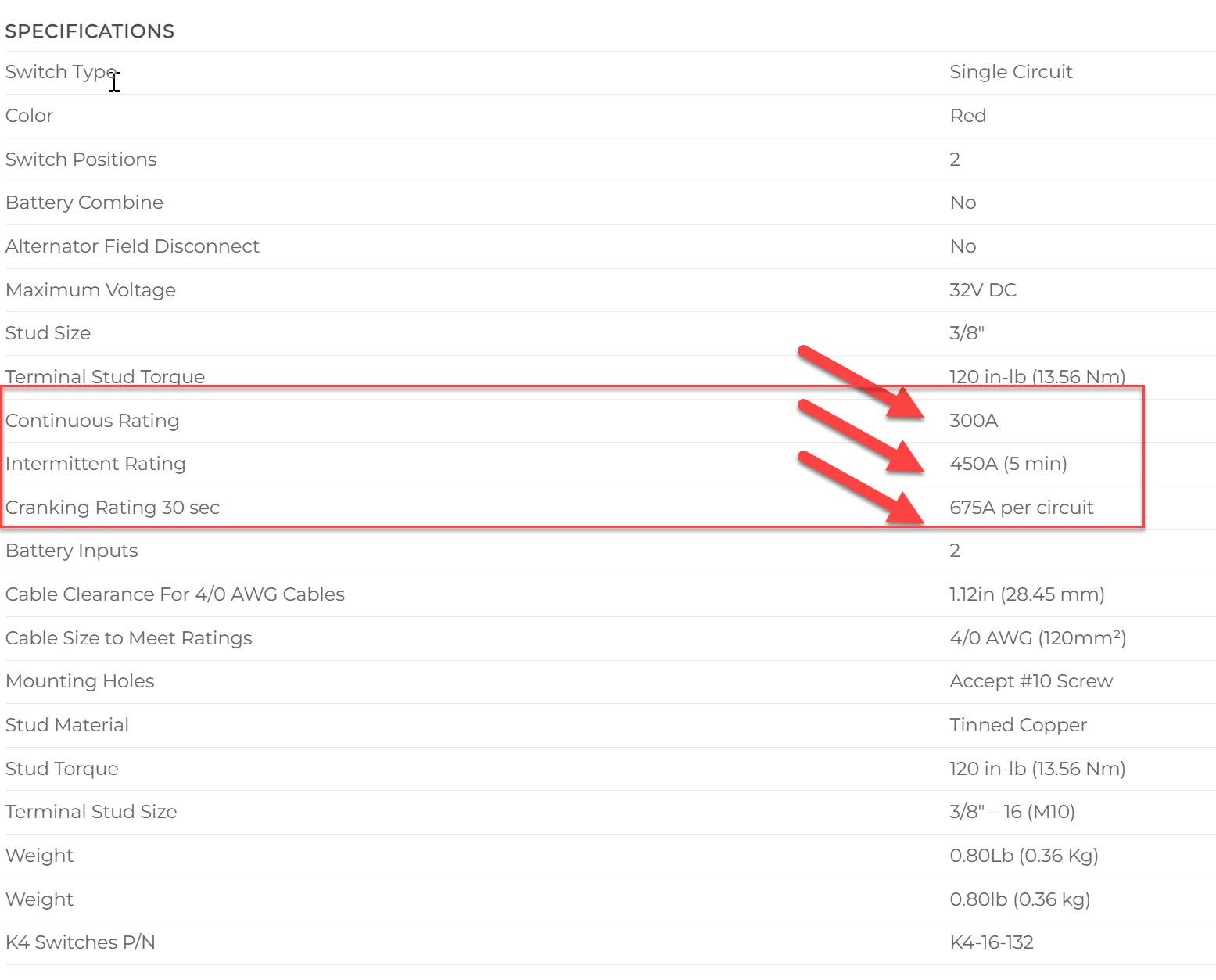

Whatever you do, make sure the switch is rated for the max amp draw of the winch. Some winches draw in excess of 400 amps. Running that through a 200A rated switch would be a bad idea.

See the rest of my post about peak vs. continuous.
Normally with a 200a continuous rating you only see a 300-350 peak surge rating. Do you have the data sheet on it?
You can look it up on Ametek's site. These are the same as the solenoids used in forklifts - peak amperage is 600-800A depending on duration.
That said, even 300-350A is plenty unless you're running a 15k+ winch. Again, these solenoids are spec'd by many winch manufacturers for use with their winches. I believe Warn uses this exact model in fact.
When you do a long pull, you're exceeding the duration for the peak rating and getting well into the continuous range for use.
Unless you just have your winch for appearances and don't actually use it, you want a higher rated switch or solenoid.
A lot of winches, especially in the 12K range draw well over 300-350A. The Badlands 12k the OP is using can peak over 500A.
That solenoid may be fine for a Warn 8 or 9K winch, but it's not adequate for the OP.
There is no chance you are sustaining 400A+ for long enough to get into the "continuous" range of these disconnects and ending up with a useable winch afterwards.
You know that Warn uses 300 and 350A contactors on their Zeon's right? The contactor on my Evo is 100A continuous, 360A peak. The disconnect I posted is perfectly fine for anything up to 12k, especially a Harbor Freight example.

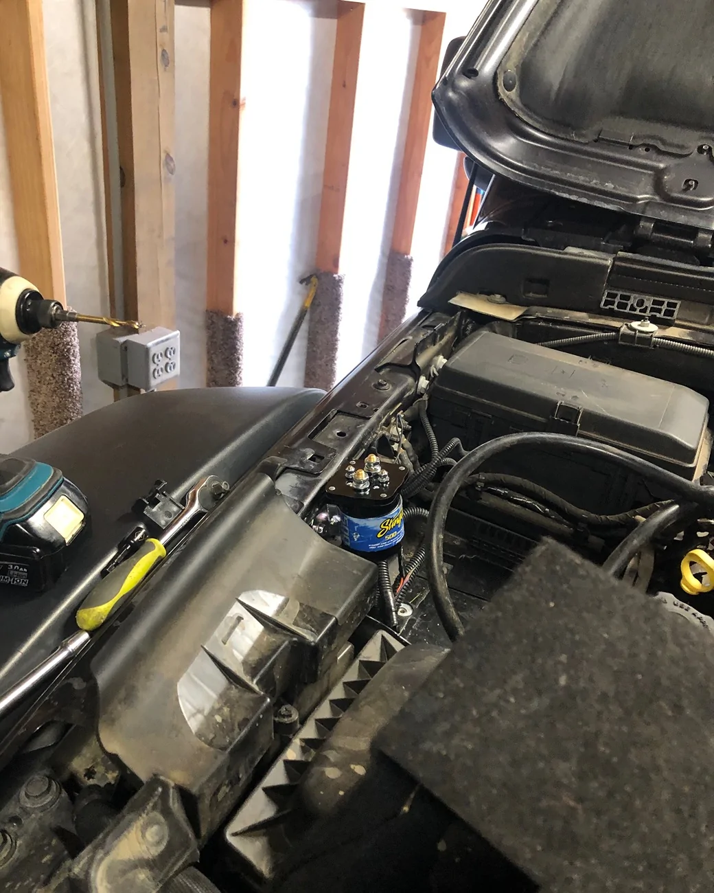

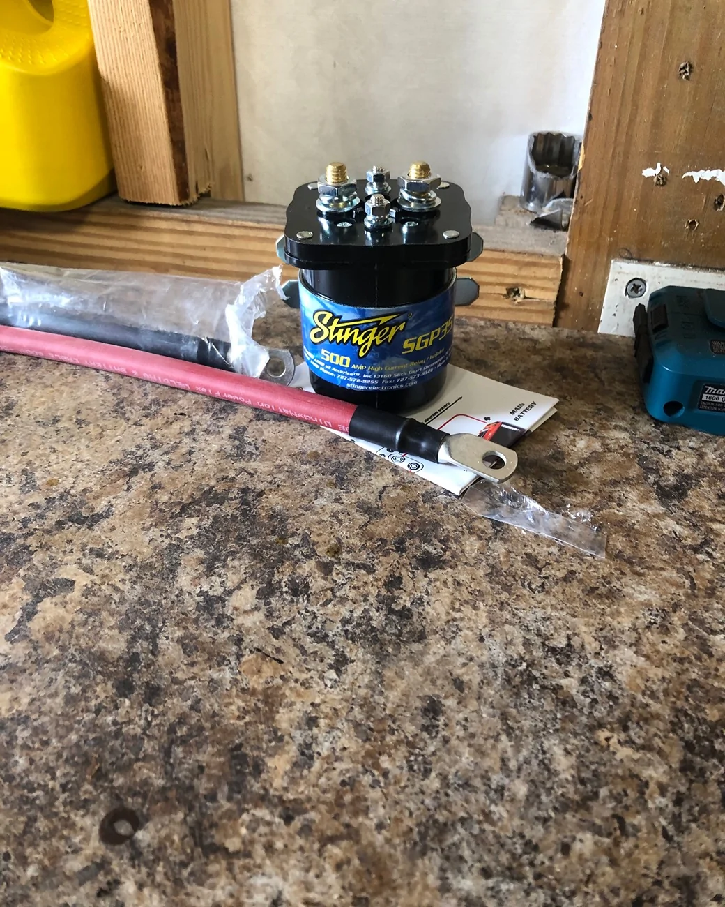

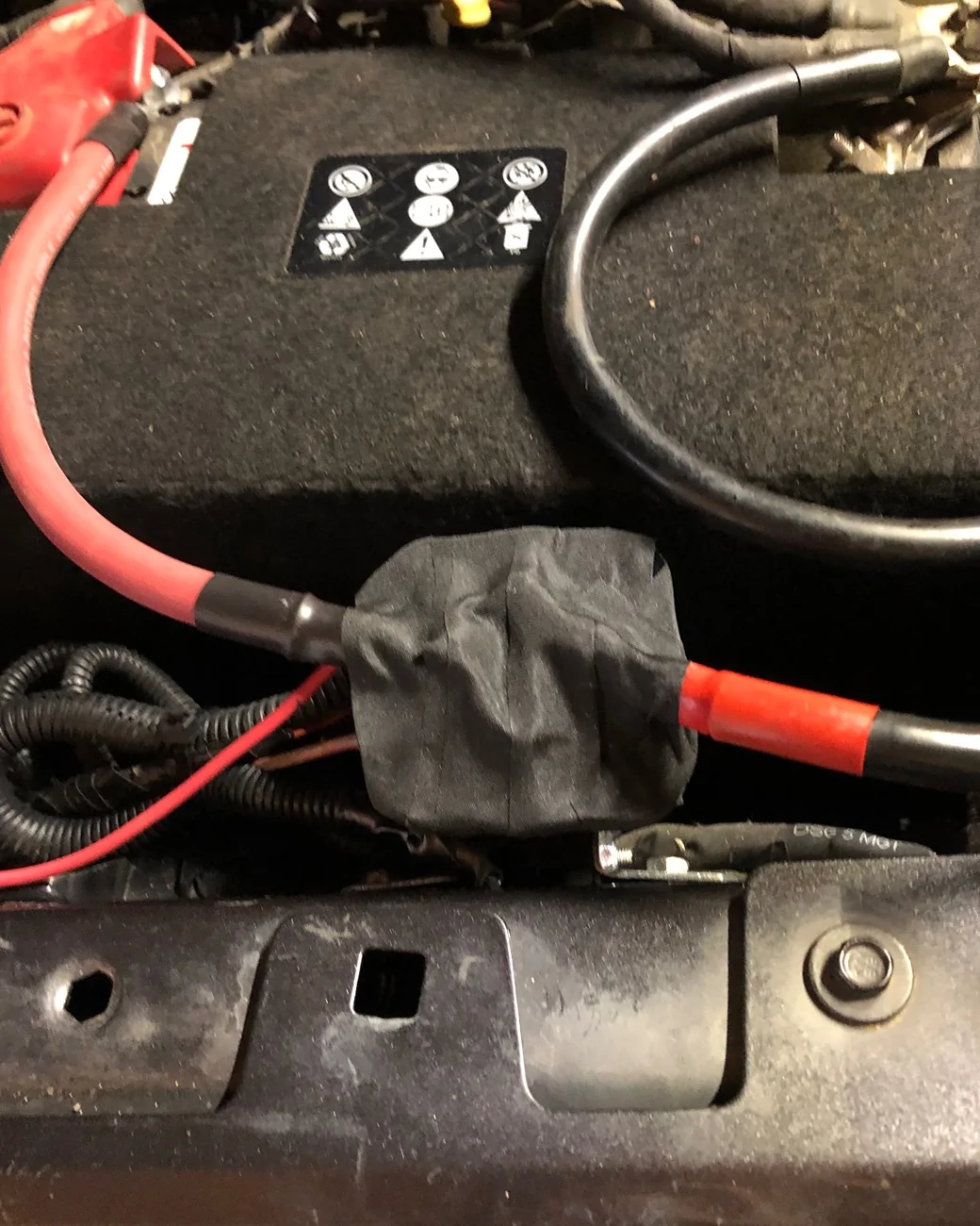

Got mine wired to aux # 2….
Jeep Wrangler JL Battery kill switches for winch ? IMG_5225
Jeep Wrangler JL Battery kill switches for winch ? IMG_5227
Jeep Wrangler JL Battery kill switches for winch ? IMG_5239
