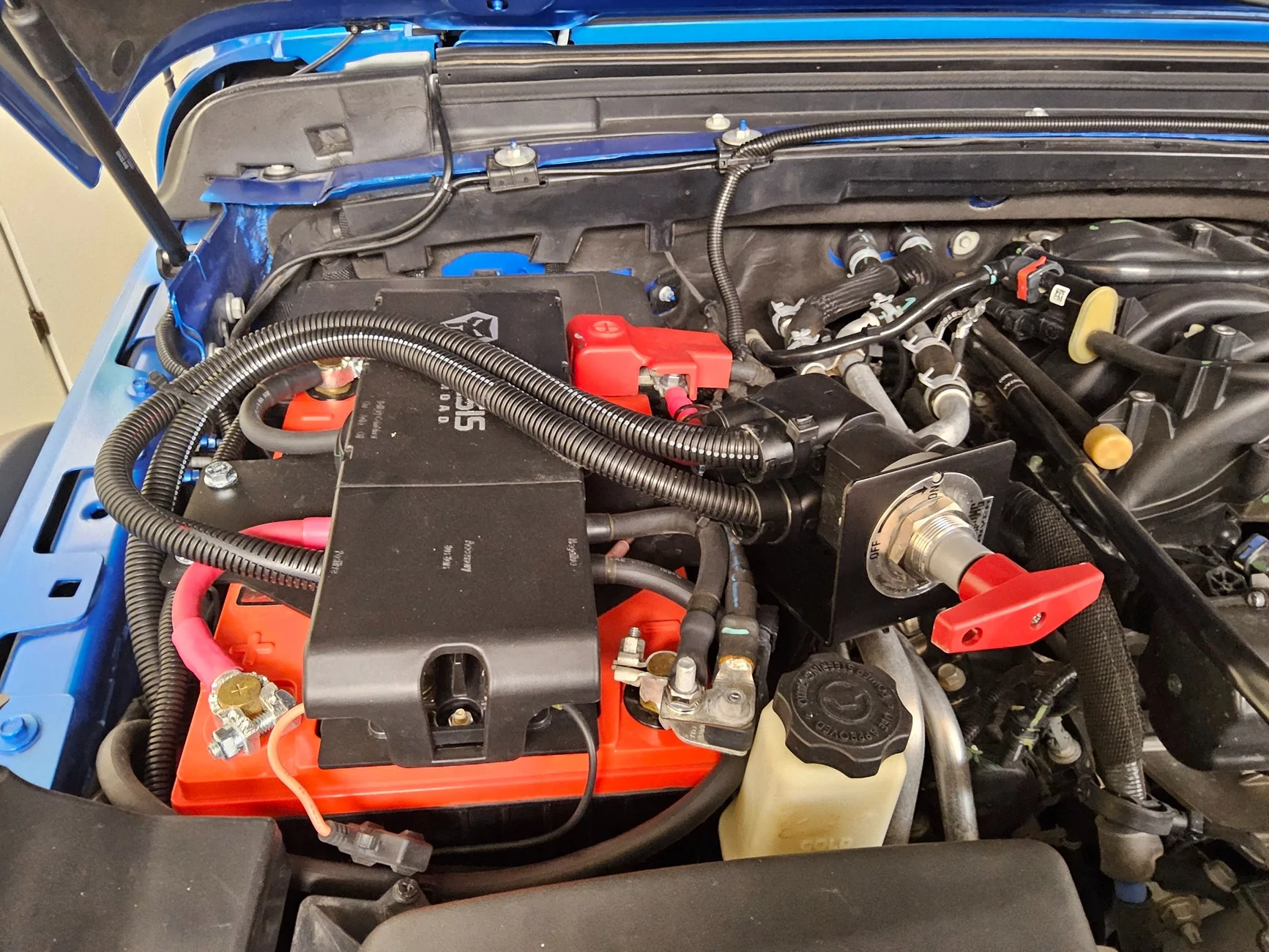

My Aux circuits are being used for lights and 4 two-way radios.
So, I decided to use a 500 Amp battery cut-off switch to cut the power to my winch.
My winch is powered from my secondary battery and the duty cycle rating is the same for both open or closed contact closures.

Also just wanted to note - if you want to go way overboard and be covered for 500A continuous, you are going to need at least 500kcmil cable...and I don't know if you've ever tried to run cable that big but bro...you'd better have some cannons.
Interesting and honest question - does an automotive disconnect rated for 500A continuous actually have terminals large enough for wire that will handle 500A continuous?
If I recall correctly, the continuous power draw for my Evo 10S is rated from 360-385 amps.
