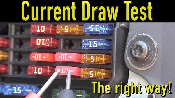

IIRC, you can pin test for current draw across each fused circuit to identify which one it is.
Park it, pop the hood and pull the fuse box cover, let it go to sleep.
Get pins out for your multimeter, set it in a low amp reading and go to town.
I'd expect you're seeing over an amp of draw if it's killing a brand new battery overnight.
