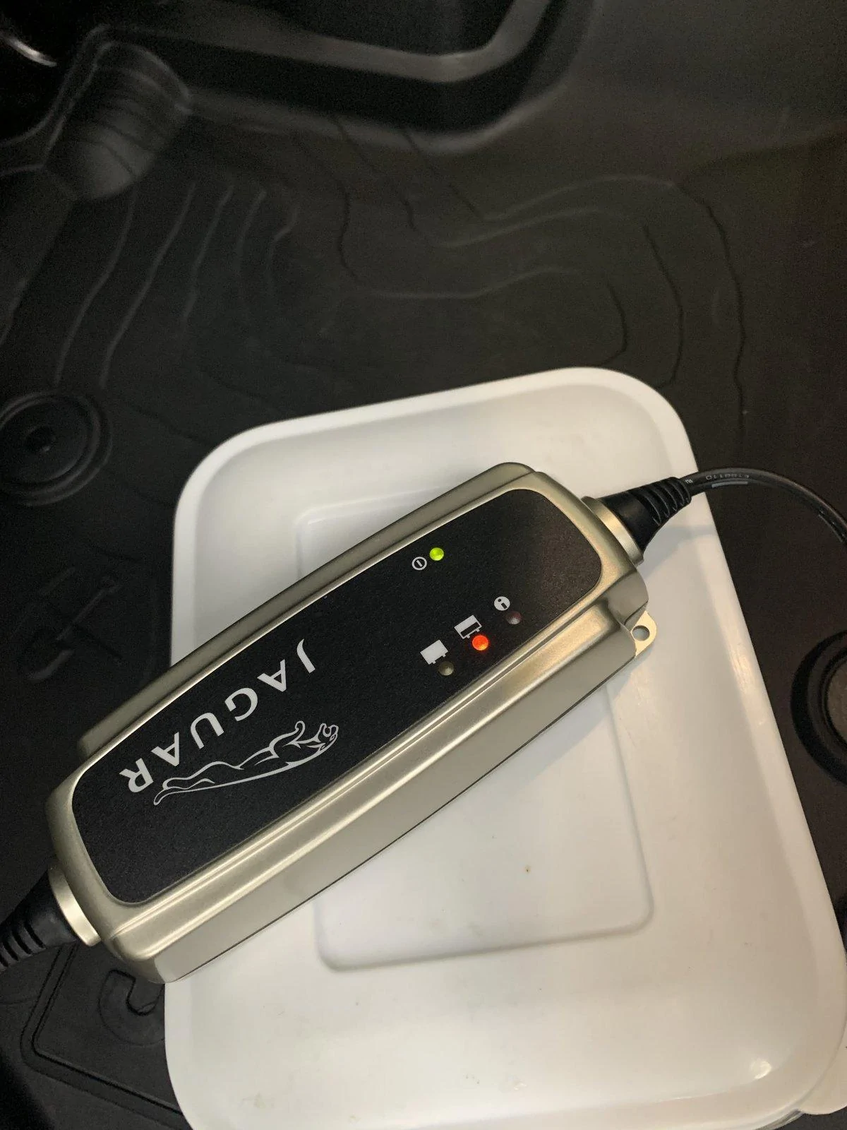

I have a spare Jaguar branded CTEK charger (pictured below) which is for the cigarette lighter socket. I want to use this or similar from the 12v socket in boot if I can.
do the specs on this jag charger look compatible?

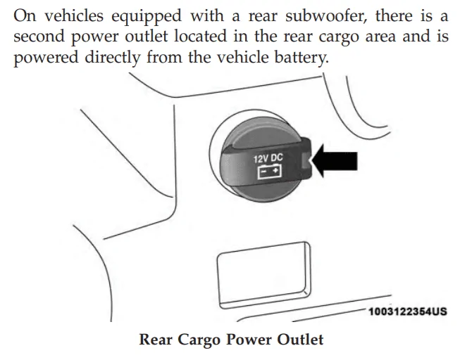

From the owner's manual > > >
Well, the owner's manual with the graphic cited above is wrong insomuch that I too have an unswitched 12V power port in the rear of my Sport, which does not have the factory subwoofer.That’s great. It’s just that I read somewhere that the handbook was wrong
I thought it was odd that the port being always live was specific to those with the subwoofer. I don't know why it wouldn't be for others. Thank you for clarifying and pointing that out.Well, the owner's manual with the graphic cited above is wrong insomuch that I too have an unswitched 12V power port in the rear of my Sport, which does not have the factory subwoofer.

I have tried the Jaguar CTEK battery conditioner and it works.
The rear cig lighter is constantly live.
The battery conditioner is lit as it should be and shows that it is doing it’s job.

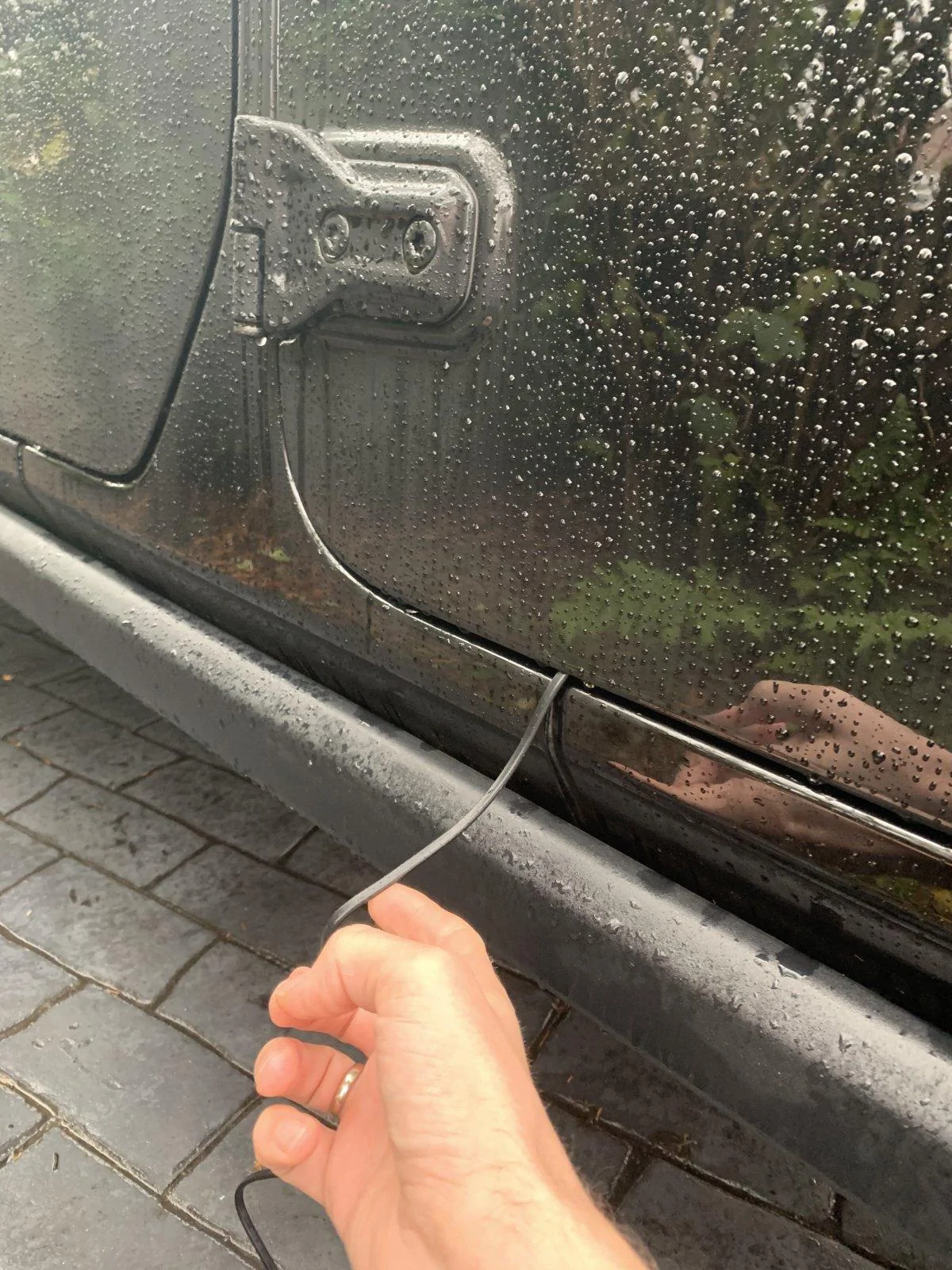

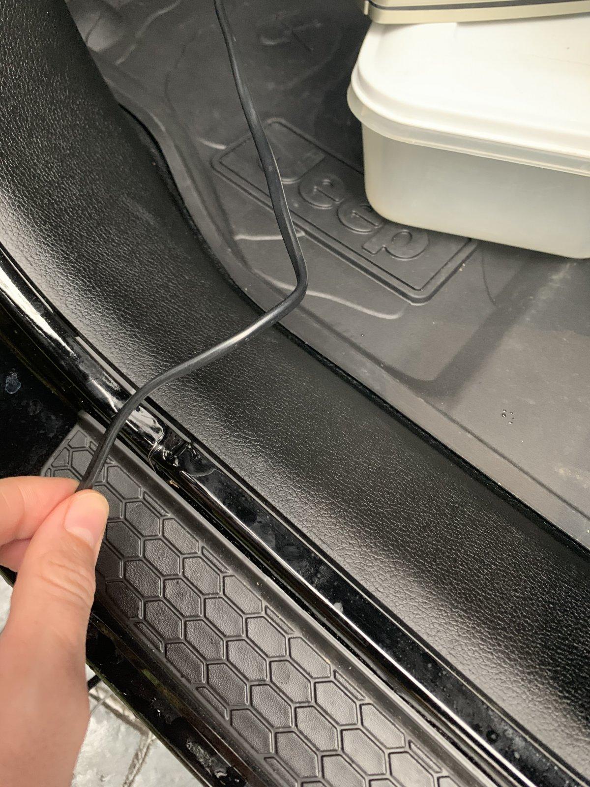

I fed the wire through the rain channel on bottom of door with no issue as can be seen. The charger can then be pushed under seat when not in use. Simple and easy.
The plug and socket that feeds power to the CTEK will be housed in a dry box under the car. The CTEK wire is IP65 and will only be dangling and not layer in water puddles so all should be good for outside battery conditioning.

It’s been working fine. Exactly like it does on the Jag. It took probably one afternoon to reach the setting (the led pictured next to the full battery image) which means its conditioned/floating and it remains like that as it should under a constant low volt trickle.
I do trust the Jag branded ctek. I leave these on all year round (for months at a time).
