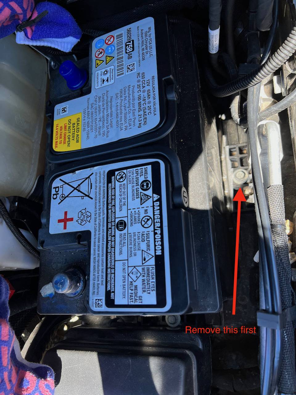

I wanted to share some information on replacing the 12V batteries on the RHD JL for Australian owners. This isn't a step-by-step guide, as it's essentially the same as the LHD process other than how the auxiliary battery is accessed.
Removing factory batteries

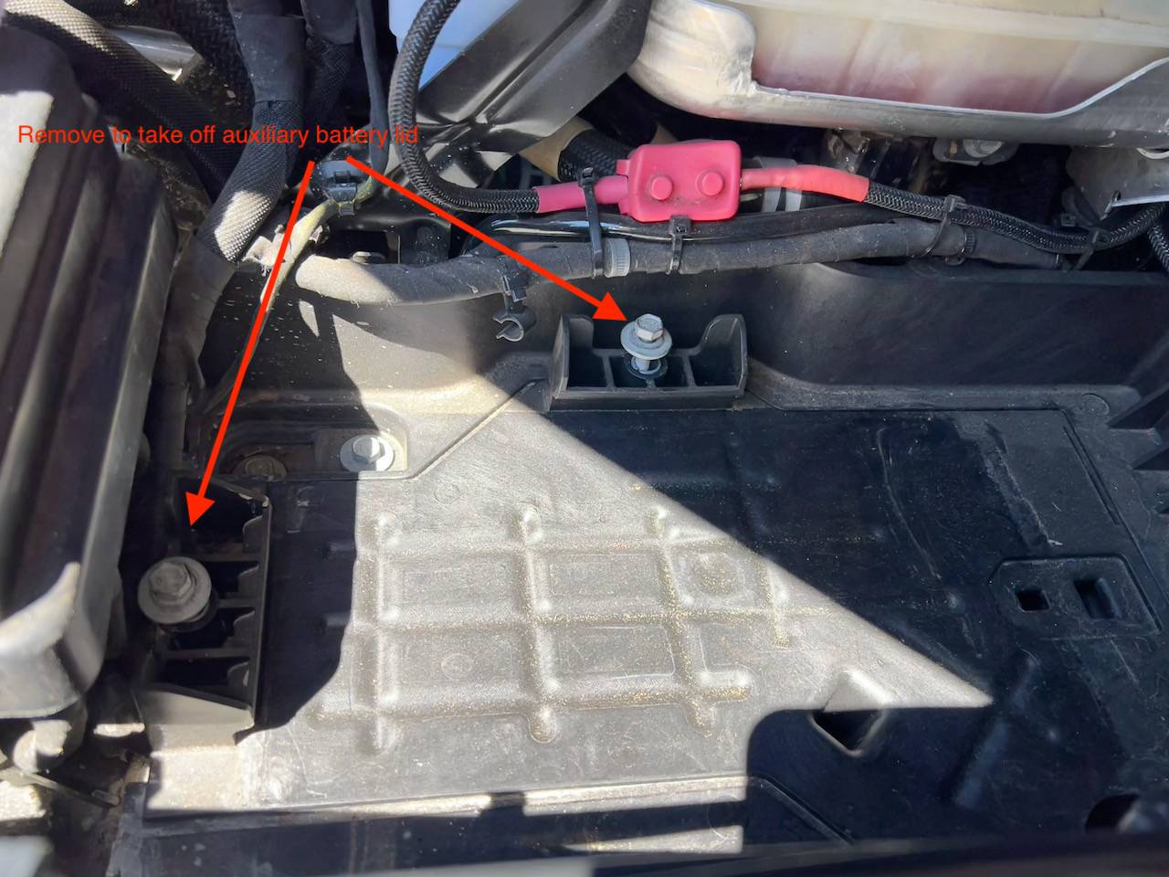

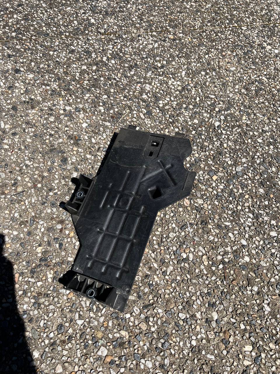

Disconnect and isolate the auxiliary negative first, and then disconnect the wiring from the main battery terminals. You will then need to remove the battery base clamp closest to the fender with a 10mm socket to lift out the main battery. This will reveal that the main battery tray is also the lid of the auxiliary battery compartment. The lid can be opened by removing the two 10mm bolts from the remaining base clamps, which are moulded onto the lid.
Unlike the LHD models, you will not need to remove the Power Control Box or the fender flare to access the auxiliary battery.

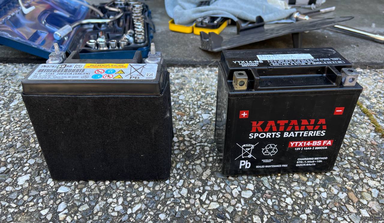

Replacement batteries that fit
For the main battery, I went with the Century ISS Active Stop/Start Car Battery DIN65LH AGM MF (720CCA 70AH). I chose it mainly for convenience as SupercheapAuto had it in stock (Aussie freight network is a nightmare right now), but also, it's a decent brand. This is a H6 battery, which is essentially the same size as the factory battery. The dimensions are 276L x 175W x 190H. I believe you can fit a longer H7 sized battery (e.g. Century DIN75LH AGM MF 800CA 80AH) as there is some spare room on the battery tray adjacent to the firewall.
For the auxiliary, I went with the Century/Katana Powersports Small Engine Battery YTX14-BS FA (200CCA 12AH), which is an AUX14 group sized battery. This is essentially the same size as the factory auxiliary battery. Unlike the main battery, there is less flexibility on size with the auxiliary; the bottom of the auxiliary battery lid has a protruding part that pushes against the recessed area of the battery's top to stop it from moving. So a smaller battery than AUX14 would bounce around, whereas a bigger battery will not fit in the compartment.

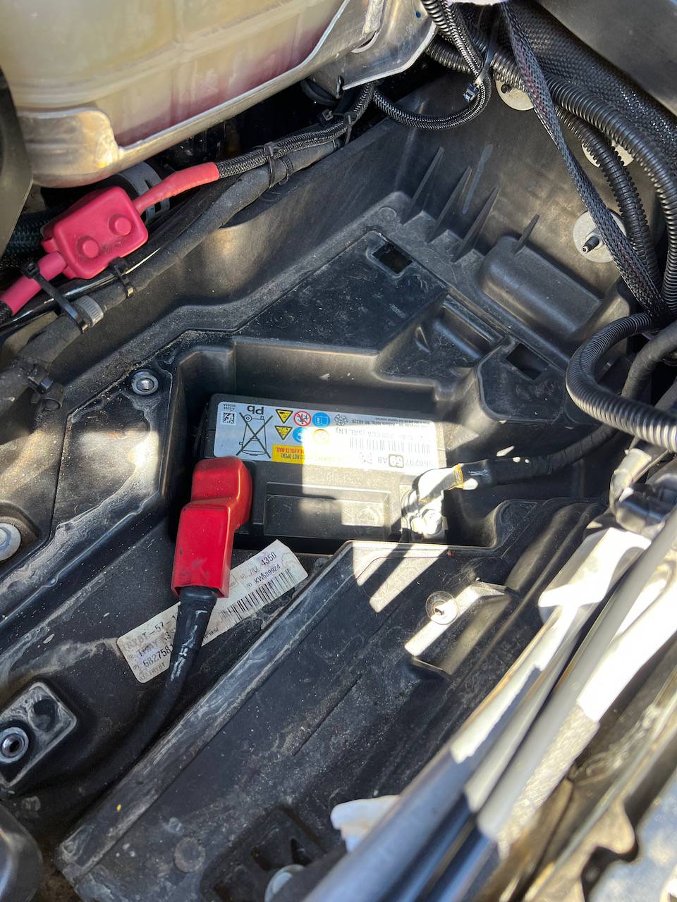

This is very similar to the LHD diesel JL, where the aux battery is under the main battery tray.

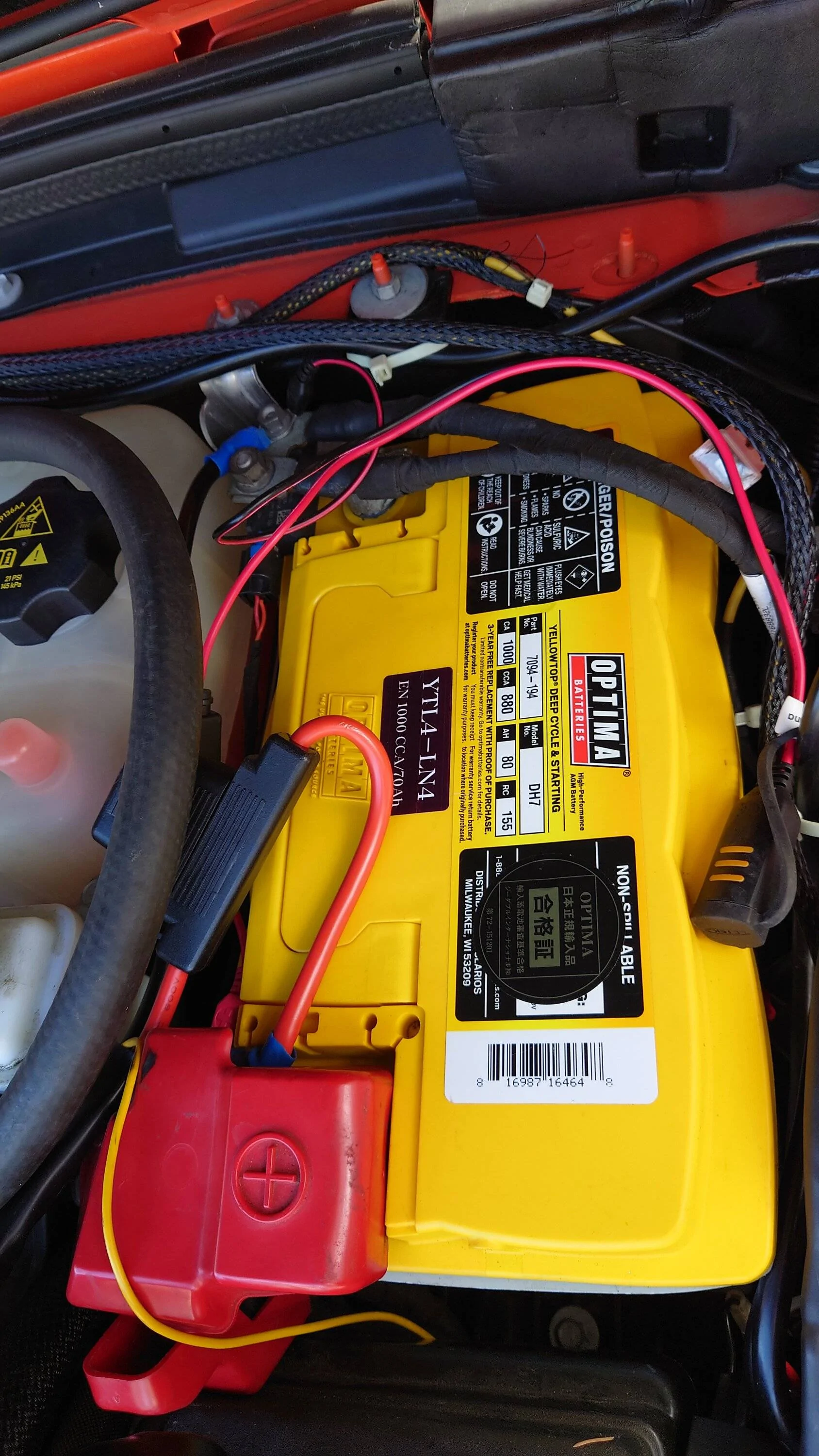

I drive a 3.6JL, RHD in Japan.
If you remove the square spacer on the AUX battery lid, you can install an LN4 battery (I have an Optima DH7) without interference.
There is a few millimeters between it and the coolant reservoir tank stay.
I also removed the aux battery when installing the Optima DH7.
The Optima DH7 alone outperforms the two stock batteries in CCA, Ah, and RC and has not caused any errors in the vehicle.
All you have to do is connect the cable that is connected to the positive terminal of the AUX battery to the positive terminal of the main battery.
Depending on the year, the cable connected to the negative terminal of the AUX battery may not be necessary, or it may be necessary to connect it back to the negative terminal of the main battery.
In a few days, a friend of mine who drives a Wrangler will post a YouTube video on how he converted his RHD to a single battery.
I am not familiar with English, but I wanted to share this with RHD JL drivers in Australia and other countries.
