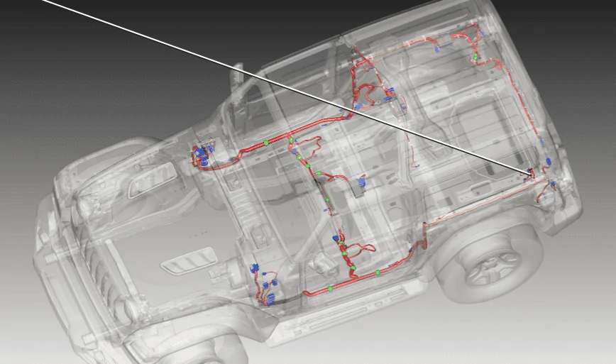

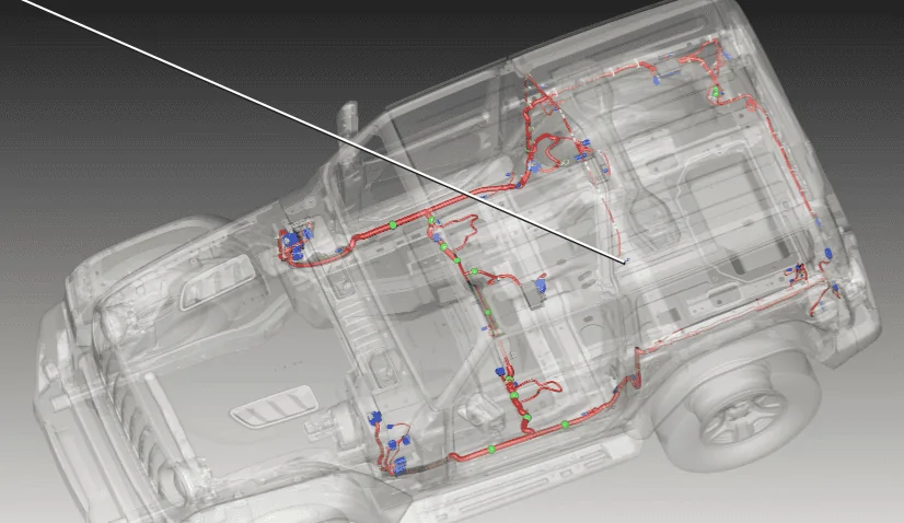

Looks like there are four mics, I think it's pointing to the sound bar for the first two, and the side panels in the cargo area right by the tailgate for the other two.
Any chance you accidentally covered one up or something that could be impacting?
No -- I haven't added much. I think it's working as intended, I'm just not used to it yet.
(Great diagrams!)
