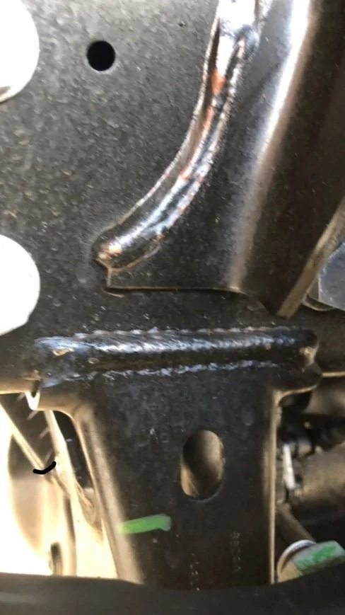

Good luck with that. I’m preparing a post to be put up in the next couple of days, chronicling my weld woes. Short version is, my 18 Sahara was part of the track bar frame bracket weld recall. It was repaired before I took delivery by the dealer, but the repair looks worse than the off-seam weld probably did. After I had 3 independent inspections by three qualified welders, all who stated the repair was unacceptable, jeep will still not correct the faulty weld repair. I am in the process of exploring all legal remedies.
Approved tracker bar bracket weld
My tracker bar bracket repair weld
Yeah that looks like bat shit. It looks like the weld was "cold" and, it's hard to tell in pix, but it looks like it lacks penetration. Is it stuck? Probably. Is it worth fussing with? If it were mine,I'd probably just take it to a shop and have them grind out the weld and re-weld it. Not a "jack of all trades" shop, a weld shop.
