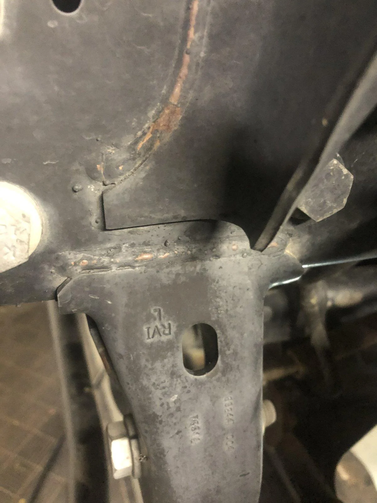

looking at the welds on my jl and wondering what if anything jeep with do

The weld on the track bar bracket is pretty off line. So is the end of the coil bucket weld. There was a recall for this. The dealer is supposed to take pictures and send them to FCA for evaluation. If repairs are necessary, FCA sends a welder to the dealership to grind the bad welds and re-weld them. I had this done on my 2018 and the guy actually did a good job (can't say they all will).

just makes me wonder.... there are many welds on my frame that look like this and i never got the recall notice

I would reach out to @JeepCares for guidance, and they will also work with your dealer if necessary.

Good luck with that. I’m preparing a post to be put up in the next couple of days, chronicling my weld woes. Short version is, my 18 Sahara was part of the track bar frame bracket weld recall. It was repaired before I took delivery by the dealer, but the repair looks worse than the off-seam weld probably did. After I had 3 independent inspections by three qualified welders, all who stated the repair was unacceptable, jeep will still not correct the faulty weld repair. I am in the process of exploring all legal remedies.
I'd add the Rusty's brace for $100 to help the area.

Cut through all the B.S., With the dealerships, if you dont have the time, and take it to a reputable welder. He should be able to touch up about anything, in a few minutes. Then get a can of spray paint to keep it from rusting. People over think these things.

agreed...... I fix anything I can myself, or what I can’t, I get it done by my buddy, who is a welder. I’ll let the dealership deal with any computer or electronics problems, as it’s above my pay grade...lol. This will only cost a minimal amount of money, if any, maybe a few beers. But it’s worth it for the piece of mind... I know some people believe they need to have Jeep fix everything or they feel like their getting ripped off, but I’m getting older, and don’t sweat the small stuff anymore......:)

Prep is everything in welding. If you decide to take it to someone to fix it, don't expect it to take a "few minutes" or to pay in "beer". Do either of those things...and you're likely to have a shitty job done.

Maybe...maybe not. How qualified are you to judge a good weld from a bad one and the processes involved?
My point, if you can't do the welding yourself...you likely don't know enough about the process to do so....it's usually not that you simply don't own the equipment b/c I've never known anyone that could weld that didn't think it a necessity to own one. They are simply one of the most useful tools you can have.
Granted, there've been guys that couldn't own one due to some outside force...lost a job, living in an apartment so no place to store/use it, got divorced had to sell, etc....but all of them planned to get another one as soon as their personal situation allowed for it.
Im very qualified, been around it most of my life, I just suck at it. My point was, and maybe I said it wrong, or not detailed enough, if you know someone that can weld, why not fix it yourself. That’s it, I’m not going to argue with you, I have to much respect for you, your knowledge and your capabilities. Find another worthier opponent....:)

Well actually, unless we are x-raying the welds, we really don't know if they are "good or bad". We only know that they aren't aesthetically pleasing.
