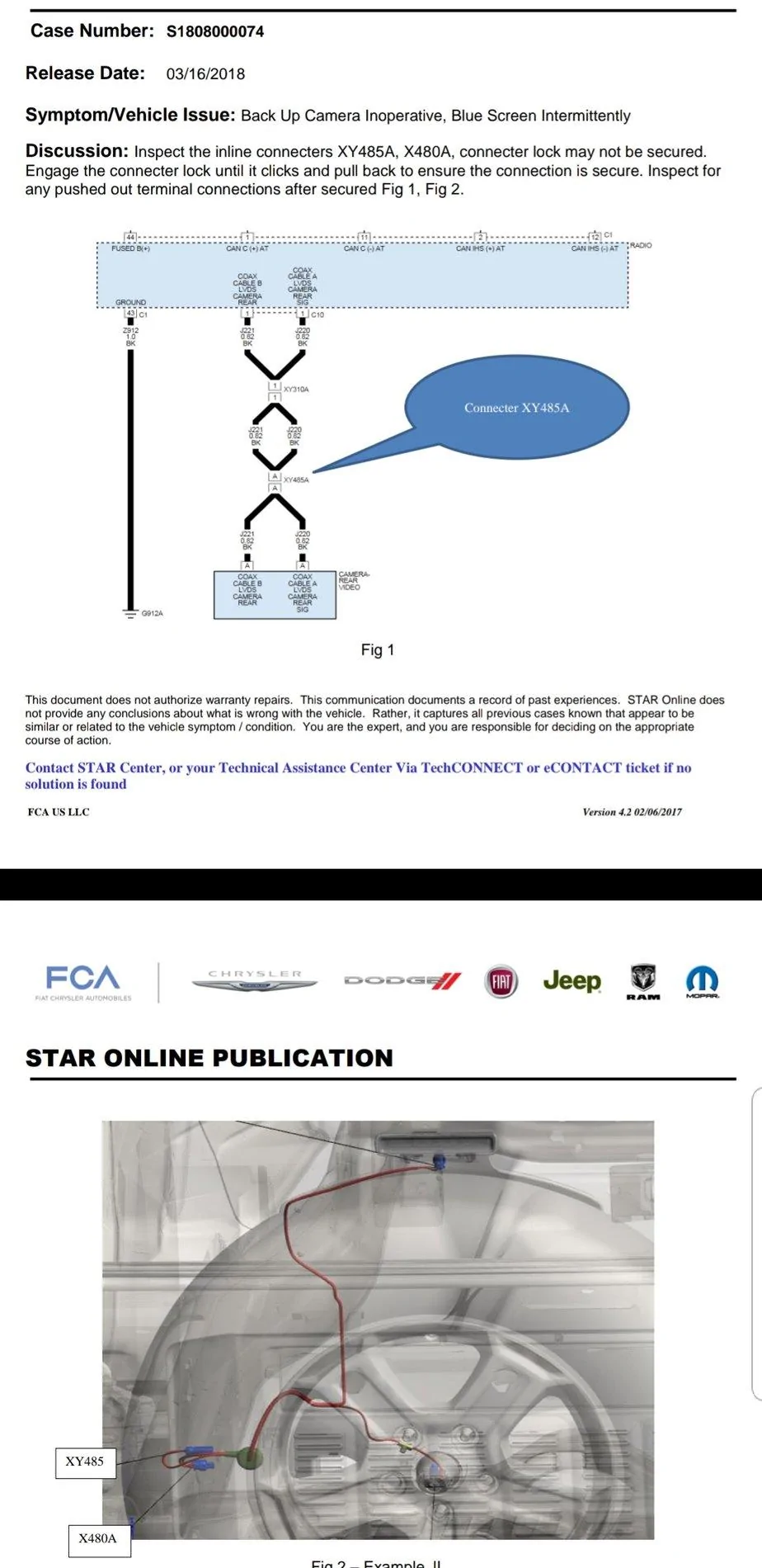

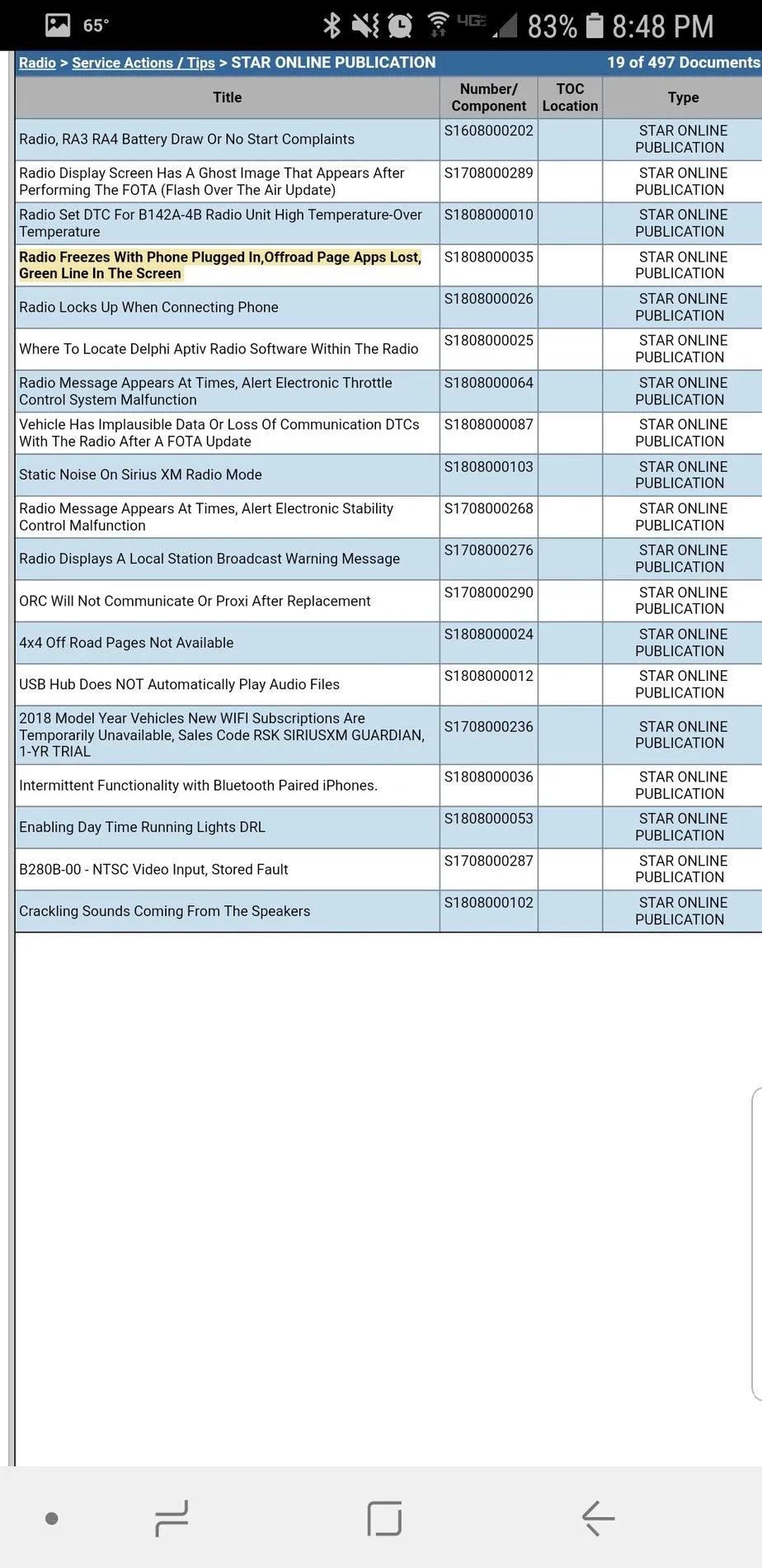

Here's a couple of things, one shows how many concerns/known issues FCA is having with the radios and the other is a blue/green screen concern for the backup camera.
Thank you for this post. I will check out my connections if it happens to me again. I thought about my iPhone and if it was the problem.

Note it could be the connector issue, above.
