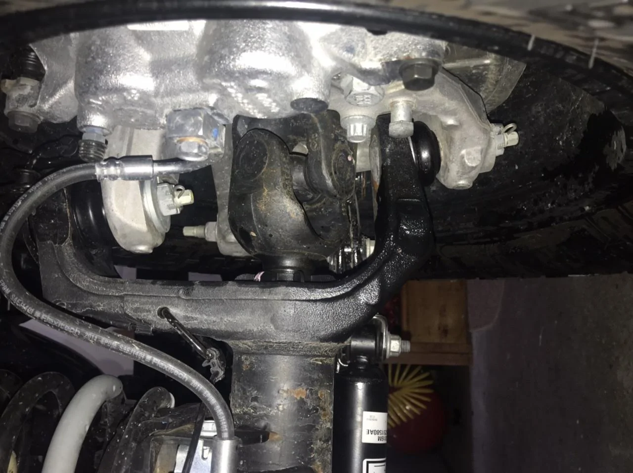

My Brand new 2020 rubicon recon is leaking out of the front passenger side at 450 Miles . It’s been leaking likely since I purchased it since I’d noticed the drips on my garage for 2 weeks now and finally crawled under. damn.

Oh no, that leak looks almost exactly like mine lol. Front passenger as well.

@Arterius2 did you get a confirm on which axle seal was leaking? I haven’t called the dealer yet, and I just love to learn how things work on my own to have a clue when I bring things in for service. I’m wondering how this could be the inner axle seal inside the differential.
Just doing some research, it appears these Dana axles now have front axle disconnects on the passenger side to help fuel economy. On the outer side of the FAD (watching some tear down videos) It appears there is a seal there as well. Seems a hell of a lot less intrusive to get to vs cracking open the differential. But given where the leak is, the seal on the FAD would have to be bad (also perhaps?). It’s a brand new Jeep and will end up going to the dealer, I just am wondering if I have time to monitor it Given the tiny amount I have seen drip and that I have wiped up. And its really dark black like grease vs. oily like diff fluid. Maybe I’ll be lucky and its not a seal at all, but just some grease around the outer axle shaft from install.

After wiping it down And checking them diff fluid (It wasn’t overfilled) and then driving 60 miles on the highway I checked again and its slowly weeping out again. This time it is clearly gear oil. Have an appointment at the dealer Tueday AM to drop it off. Hopefully it’ll be quick and it 1 trip!!
