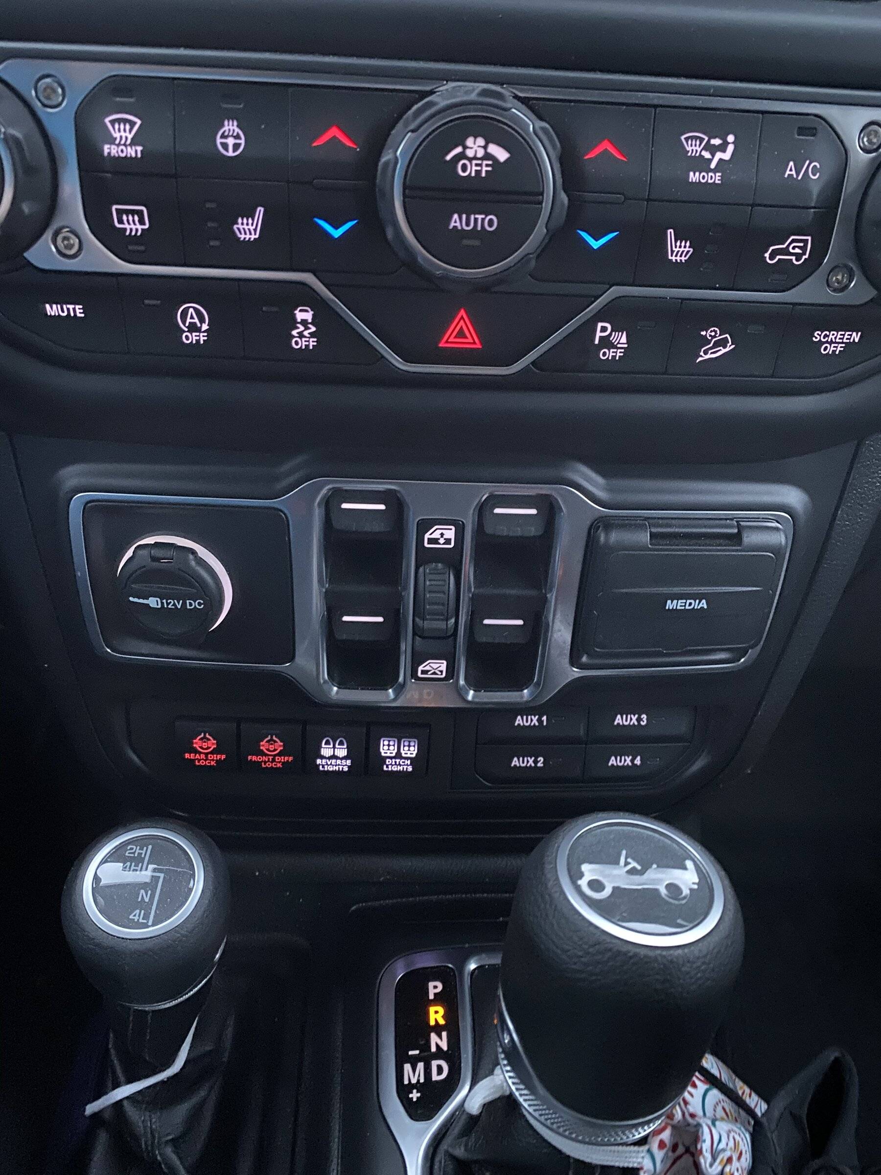

I have the 4 aux switches but needed a few more so added the 4 Stech switch for my lockers.
Jeep Wrangler JL Aux Switch Panel - OEM vs aftermarket? 701F4F78-1F08-4D31-8BE3-44C2EE6C197F

I was wanting more switches on top of the 4 factory aux, and wanted them in a more convenient location to use on the fly without pulling my eyes too far away from the road. I opted for the SwitchPros SP9100 switch panel and controller. It's more money than the mopar system, but it's super easy to install, due to only having to route a coms cable from the underhood controller to the switch panel at the base of the a-pillar grab handle. This is the bundle I got from Northridge 4x4...

I already have my factory aux switch #3 hooked to a winch solenoid and #4 is slated for a higher powered inverter than the one associated to the 110v plug on the rear of the console. That leaves only the 2 lower Amp rated ones, which isn't enough for my lighting goals.
I wanted independent control of my lighting, and just forward lights alone takes up 4 out of 8 SwitchPros switches. The left half of the panel is the lower Amp switches and the other half is higher. If memory serves, it's 20 and 40 amps. #1 is for the pair of white Squadron Pros floods on the a-pillars, turned 45° out to the sides for flank and ditch lighting. #2 is the pair of white Squadron Pros spots on the a-pillars aimed straight ahead and adjusted to serve as a much more powerful high beam. #5 is the center pair of amber LP4 Pros and #6 is the outer pair of the same lights, both on the front bumper. Currently, all 4 have spot/wide cornering lenses but my plan is to change the center pair to a dedicated spot as soon as Baja Designs makes them available.
After the holidays, I have 16 Lux rgb magnetic rock lights to install. 12 of them will be dedicated to minimizing shadows from the tires, and will be controlled by #4. 2 will be used for under hood lighting and the last 2 will go in the cargo area. Those 4 lights will go on #5, because I'm always in the cargo area when the hoods open. #7 may end up with a whip light or 2 to serve as chase lights. #8 will be for auxiliary reverse/work area lighting that I don't want coming on every time I back up. I've been blinded by someone backing out of a spot in a lit up parking lot. I don't want to be that guy.
