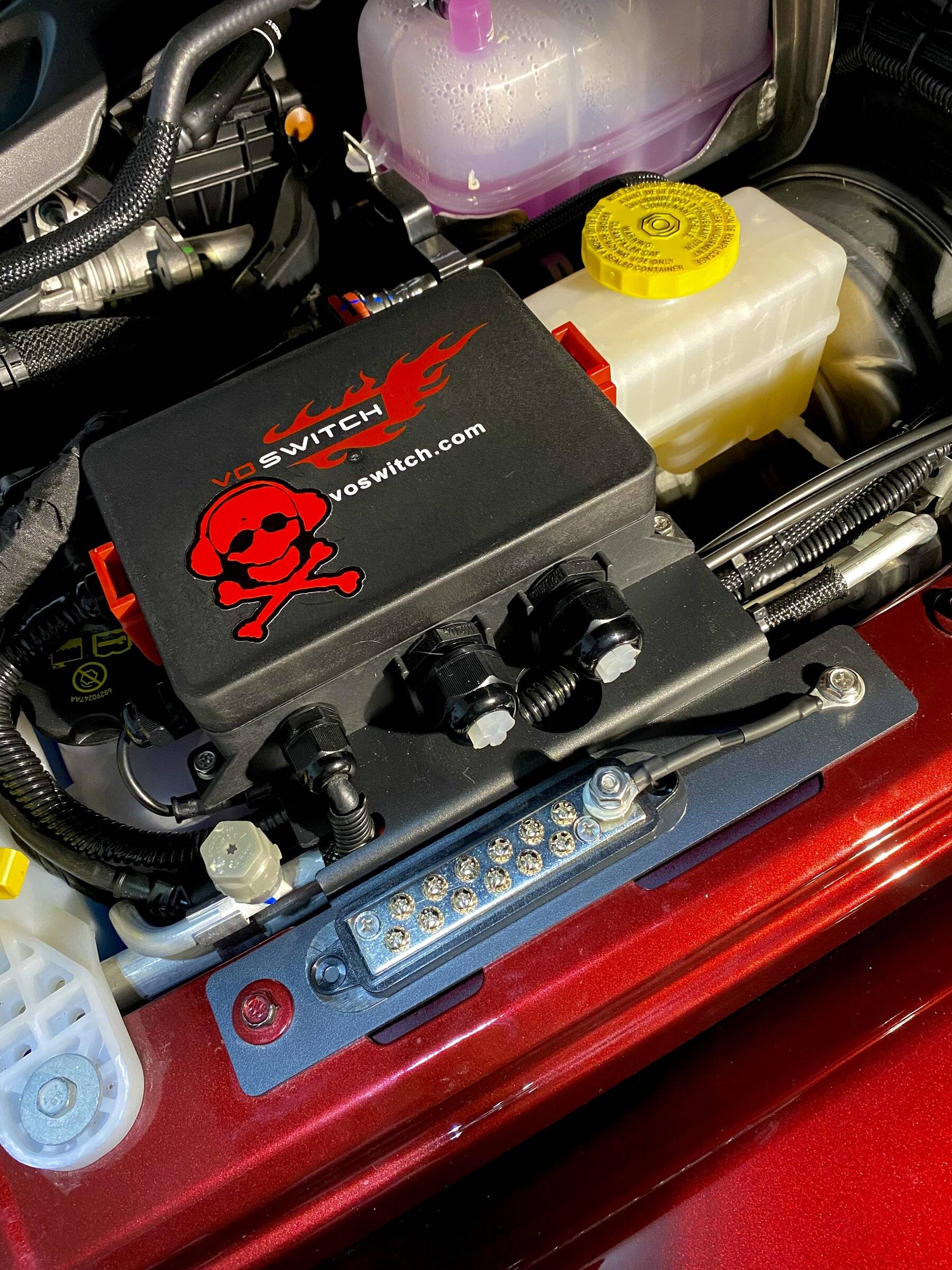

Lots of threads on this already, but the reason I went with the OEM module (and paid quite a penny for installation/programming) is that it gives you 4 wires already fused and ready to just hook up t lights (no in-line fuse necessary) under the hood, AND....the same 4 wires inside the passenger footwell, with 2 additional ones: Battery/constant on, and Ignition on...meaning 6 wires total inside. So you can wire up a whole slew of lights and accessories both in and out. Plus, you get programming on your Infotainment which lets you choose what you want the electrical system to do when you hit an AUX button and whether you want it to remember the status when you restart the vehicle. The aftermarket options are plentiful and customizable for sure, but with the OEM setup you get great capability in and out of the vehicle. Not an advertisement, just put it in mine and the options for wiring are crazy convenient and the system works great for me. Good luck!

Yep. 2 under the hood at 40amps, 2 under the hood at 15amps. The four inside: 2 @ 40amps which is the same circuit as under the hood (ie--push the button, wires activate under the hood AND inside), 2 @ 15amps which are the same circuit as under the hood as well. 2 more, one which is "always on", and 1 which is "ignition on only". Regardless, I feel it was worth is for me. I put lots of effort into wiring...ie--creating wiring harnesses for my lights which are protected, sealed water tight, and with Deutsch DT connectors. Was worth it.

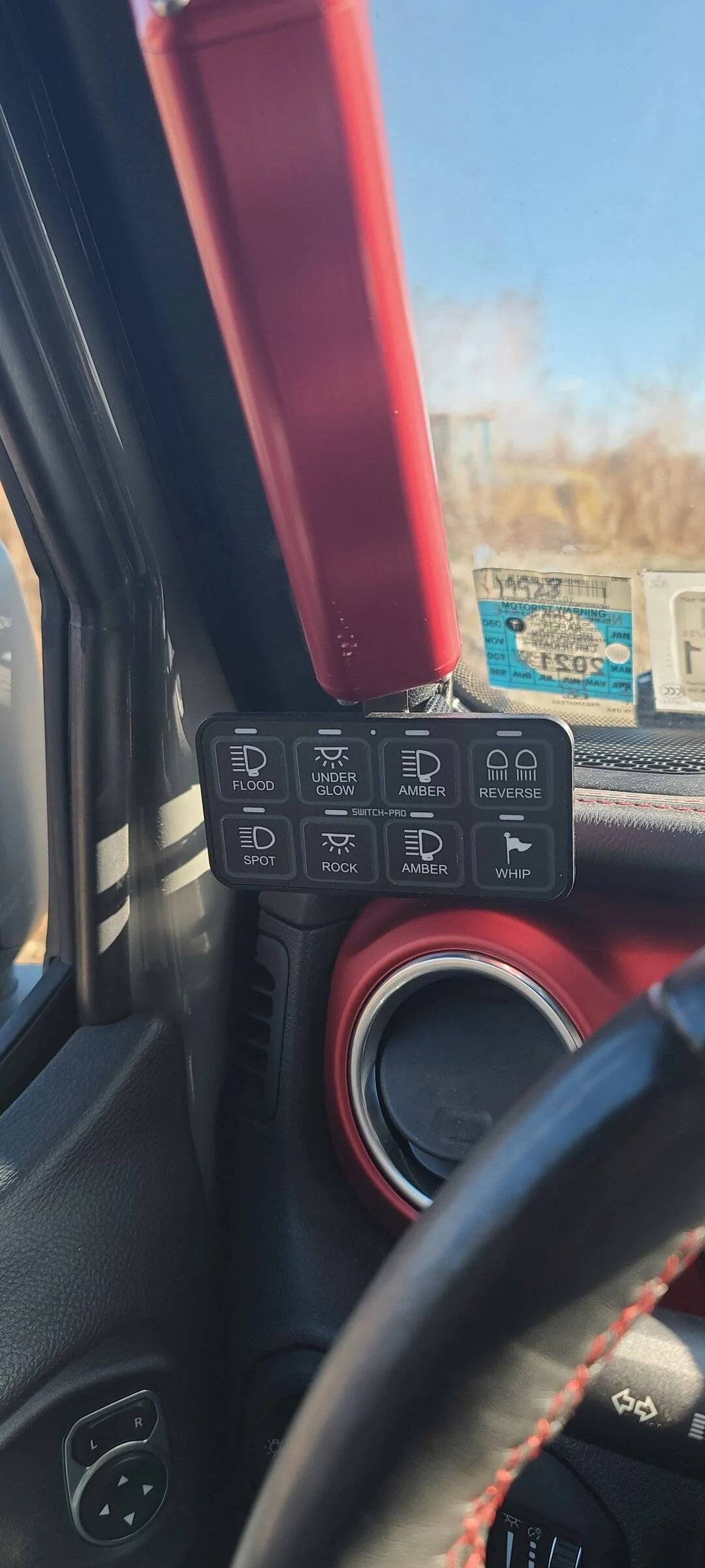

I was wanting more switches on top of the 4 factory aux, and wanted them in a more convenient location to use on the fly without pulling my eyes too far away from the road. I opted for the SwitchPros SP9100 switch panel and controller. It's more money than the mopar system, but it's super easy to install, due to only having to route a coms cable from the underhood controller to the switch panel at the base of the a-pillar grab handle. This is the bundle I got from Northridge 4x4...

If you go with the Mopar kit, know that you have to take it to dealership to have them flash the computer to see the switches. Was a deal breaker for me. I went with Switch Pros too, and love it. Connects with your phone for programming, many advantages over Mopar. Can you install the switches, sure. Will it work, nope. Not until you make an appt, and pay dealership to flash computer.
