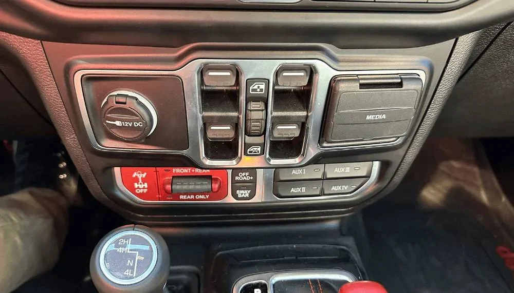

As for the buttons themselves, the quality seems great, the silver trim is actually plastic but seems to match very closely to the OEM metal trim on the rubicon buttons. The buttons themselves match closer to the OEM buttons but seem like they depress a little too much or the spring in them is a bit too soft. I feel like a more positive engagement and spring back could be beneficial here. The text on the buttons leaves a lot to be desired but we supposedly know that going in. The roman numerals are a bit odd, the font seems slightly off, and I think I would have preferred buttons 1 and 2 next to each other rather than on top and bottom of each other but the Mopar switches are arranged the same way. They are obviously not customizable.

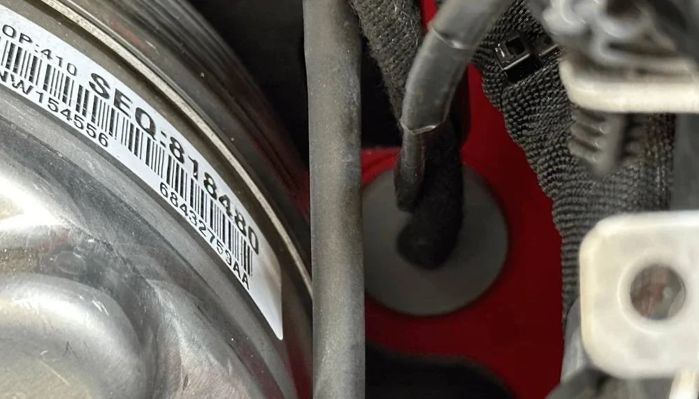

Voswitch took about an hour. The hardest part was drilling a hole through the firewall plastic cover which needs to be done for both aux switch banks and I needed to do it for other mods in my jeep anyways. The manual calls for installation on the drive side. That's where I installed mine. I do however also have a Voswitch JL 400 grab handle aux bank which was supposed to be mounted on the passenger side (or can be mounted on the driver side) but I have a Rugged Ridge snorkel that utilizes the area on top of the battery on the passenger side so that Voswitch is stuffed sideways next to the battery. I think I plan on moving that to the driver side, if I end up keeping the Lasfit which can be mounted somewhere entirely different and doesn't interfere with the snorkel kit.
Installation was fairly easy, with one wire connecting to the switch bank, and all the other wires are run through the engine compartment and to the battery and fuse box. I notice there are separate options to have the aux bank run when the vehicle is on only or anytime, which require an included fuse tap and a low voltage shut off.

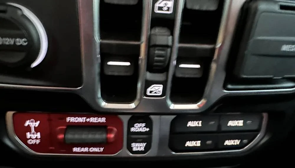

When the Voswitch is powered on, the lights are bright white that bleeds through the edges of the stickers which is kind of annoying, and are always illuminated including the power button which is also kind of annoying. I am only using 4 out of the 6 buttons and put blank stickers on the two center buttons but the light bled through so badly that I needed to put a second layer of blank stickers over the first and now no light bleeds through. Thank goodness I bought an extra sheet of stickers! I'm considering cutting another blank sticker to put over the annoying power button but it will look funny since it's not recessed. Overall, it's great that we can put custom stickers, but not the best quality.

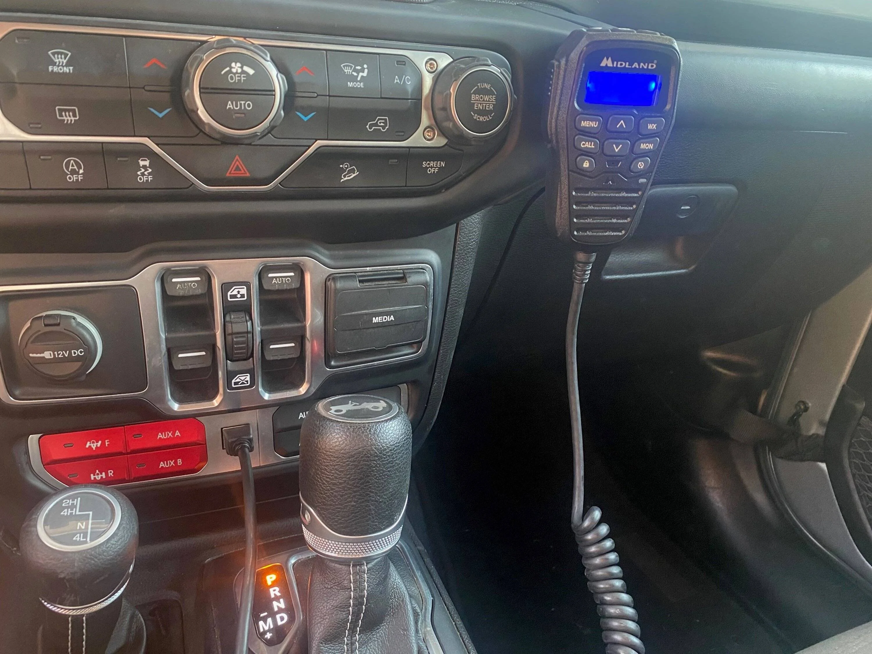

Once installed, it truly looks OEM, minus the button font but I plan on fixing that (See below plans). When the button is on, it shines an amber light and stays on until the button is pressed again. This is perfect for me but others may have a need for a momentary or strobe, etc.
Jeep Wrangler JL Lasfit Aux Switch Panel Vs. Voswitch Shootout / Comparison 8
Overall, I like the fit and finish and feel of the Lasfit better than the Voswitch. A couple of things I don’t like is the backlighting doesn’t quite match as it’s a bit of a warmer color than the rest of the buttons. Also, there’s no memory, so the buttons turn off when the car is off and when you start the car again, the buttons are in off mode. I’d love to have them saved on the on position for my heated seats when turn on the remote start in the mornings.

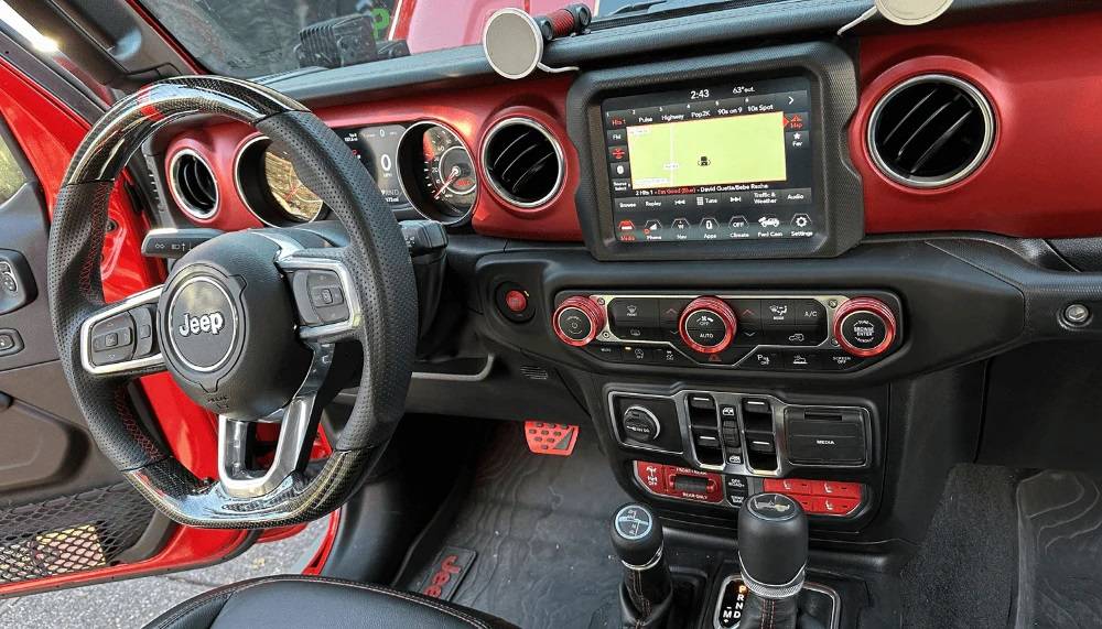

Painted them swapped the metal bezel part from the OEM Aux buttons so it matches a little better. Next to the laser engraver to get my custom seat heater icons put on them. It’s not a 100% perfect match to the red but I’d say about 96-98% matches.
