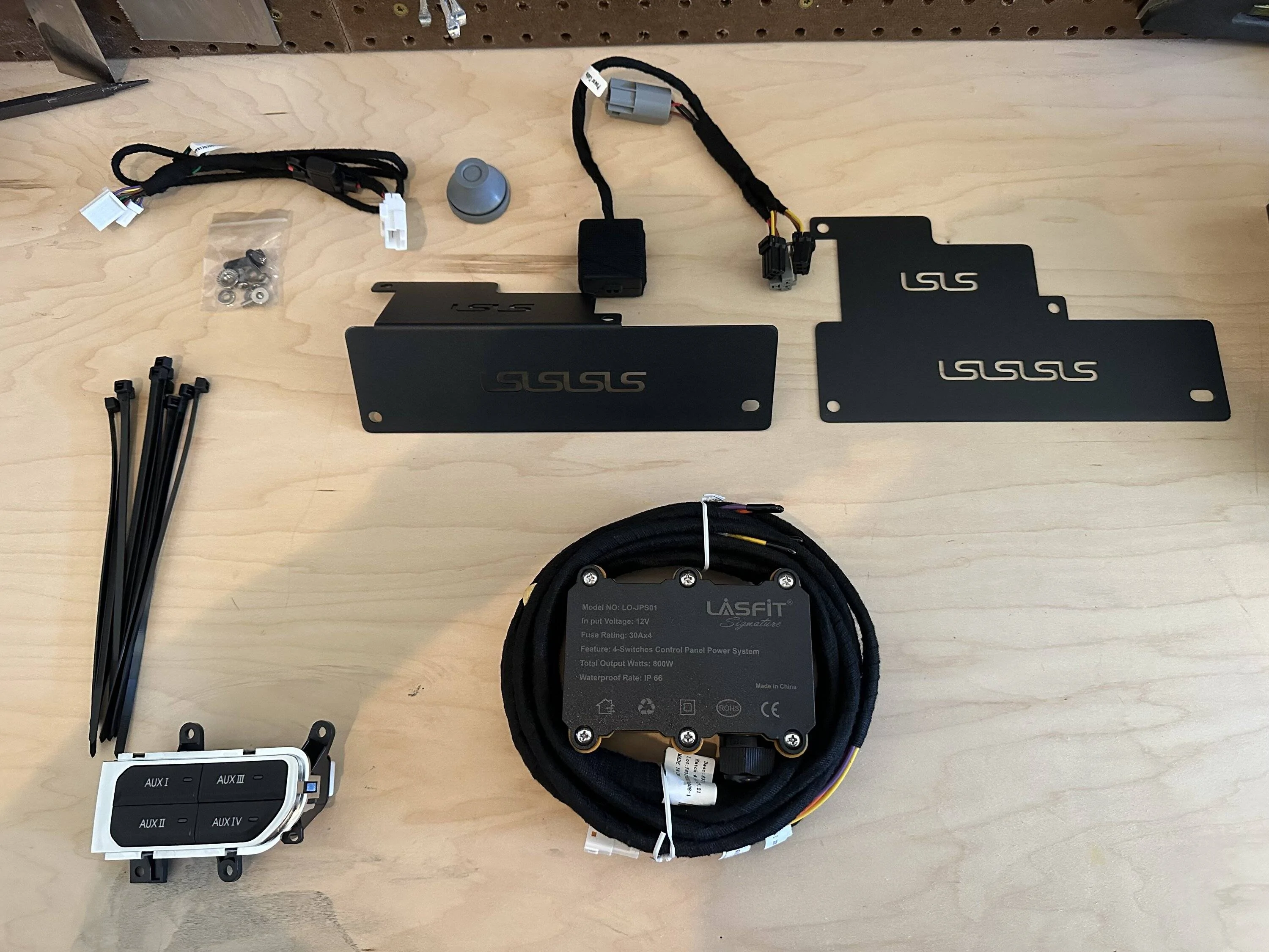

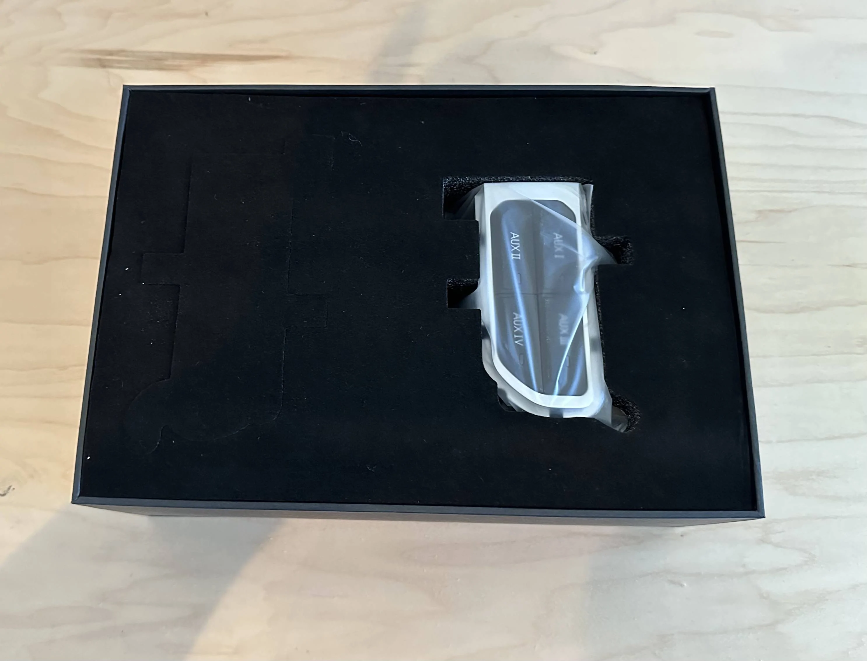

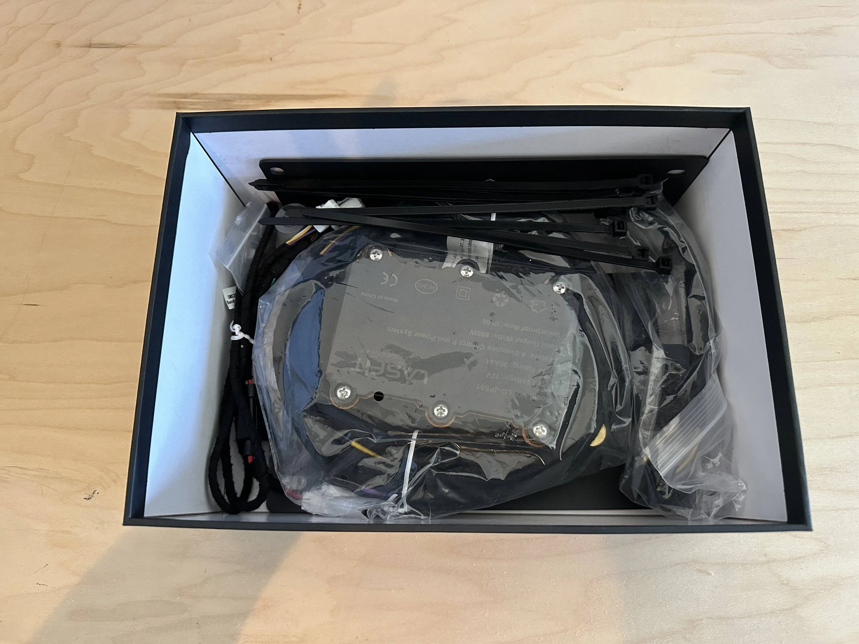

For starters, I thought the panel was very well-packaged and thoughtfully put together. It contained all parts I needed for the install. I used one extra zip tie, but that was honestly just overkill on my part. I wouldn’t say it was a necessary part that was missing. Could just be me, but in my experience the companies that put a lot of thought into the simple things tend to put a lot of thought into the bigger things. No corners were cut by LASFIT.

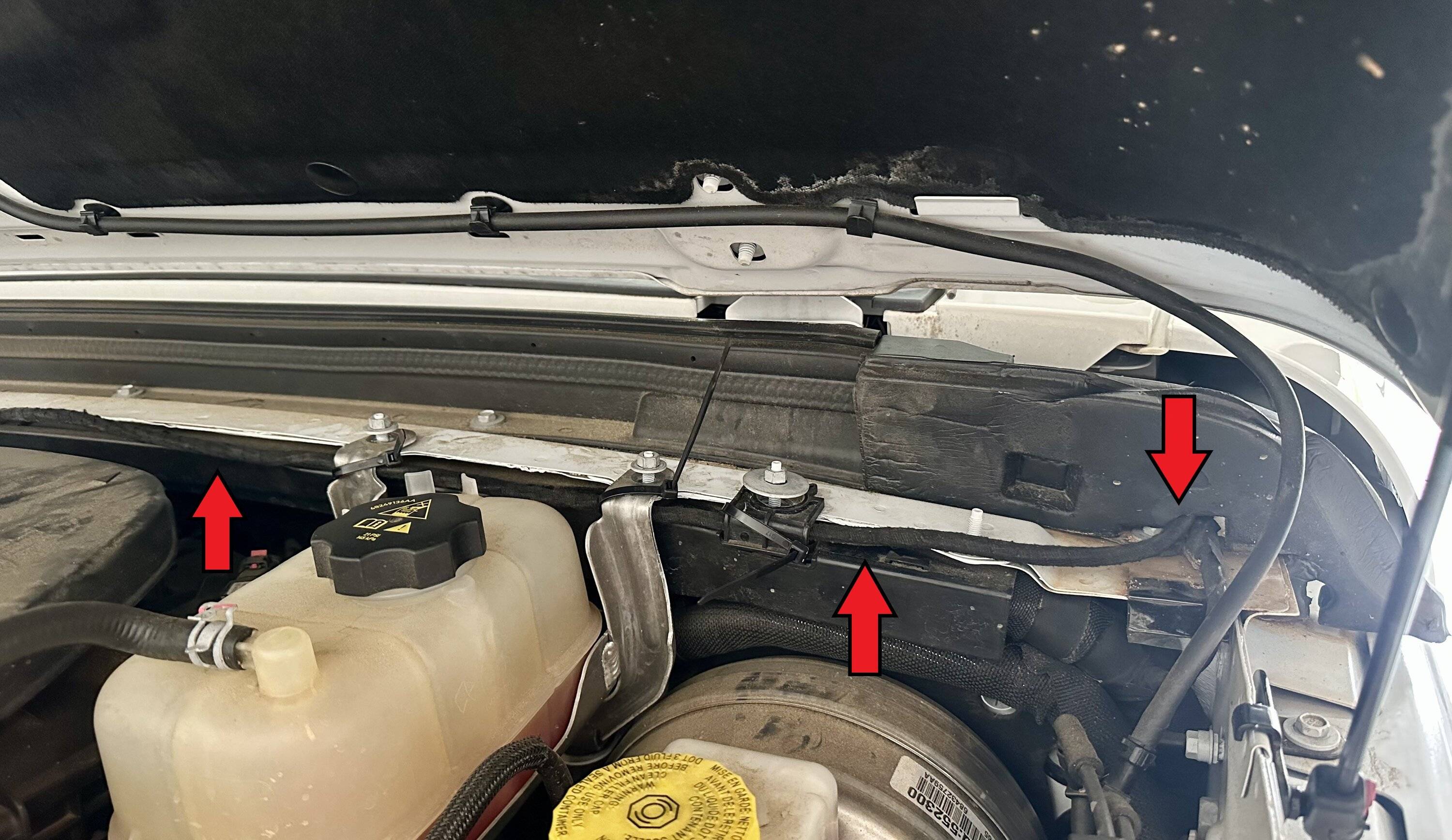

As mentioned before, my JL has the manual transmission. I previously installed some KC Hilites C2 pods as backup lights. For those, I ran the switch wires into the cab on the passenger side the same way I am about to describe for the driver side. No issues whatsoever with water intrusion last time so I decided to route the wires in a similar fashion on the driver side. The box and wires were all ran to the driver side of the engine bay, securing them with zip ties underneath a few clips in the engine bay.

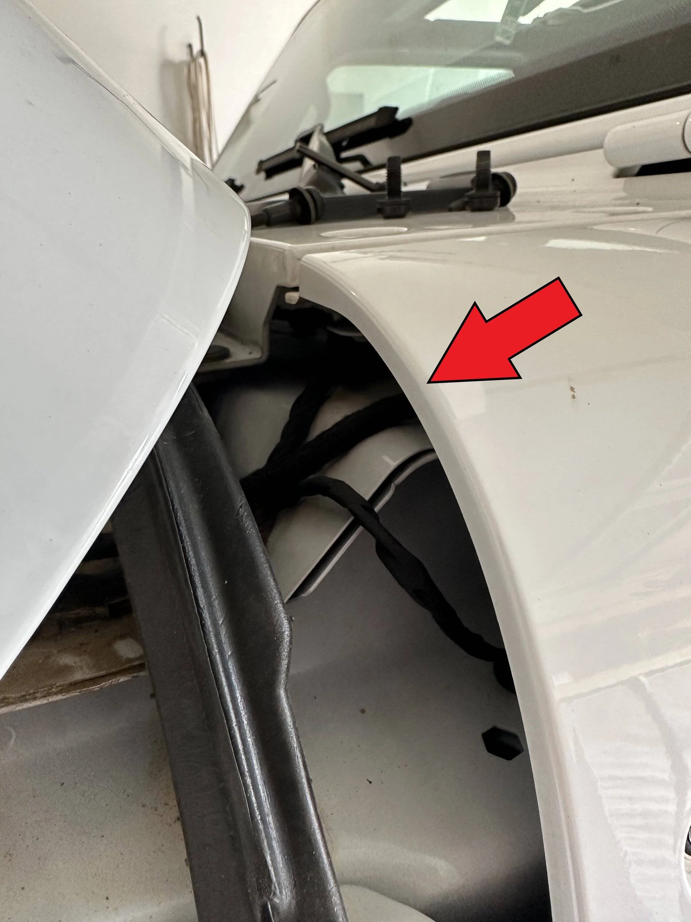

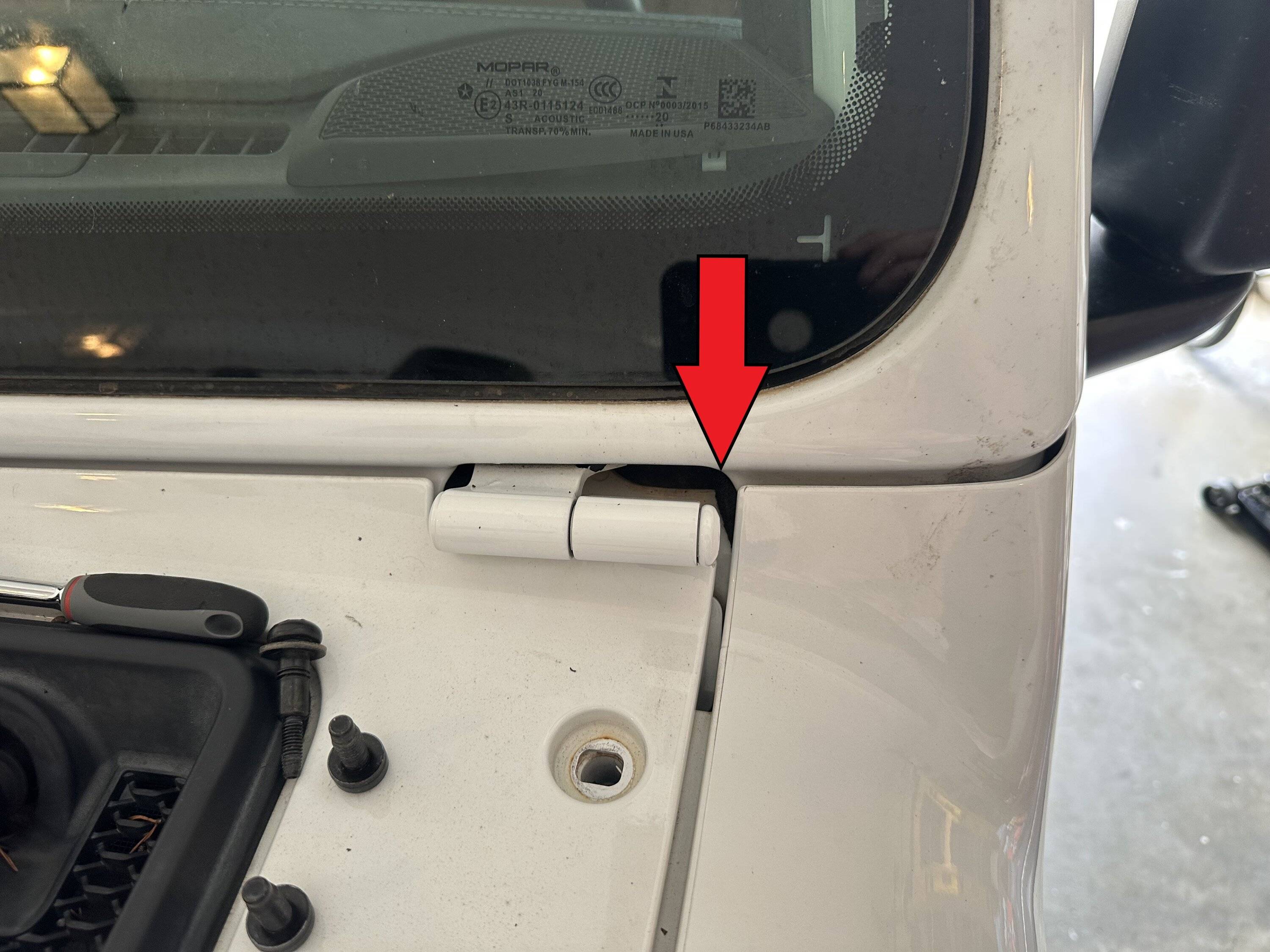

Once I got to the driver side, I popped off the cowl cover and ran the wires through there and underneath the window to get into the cab.

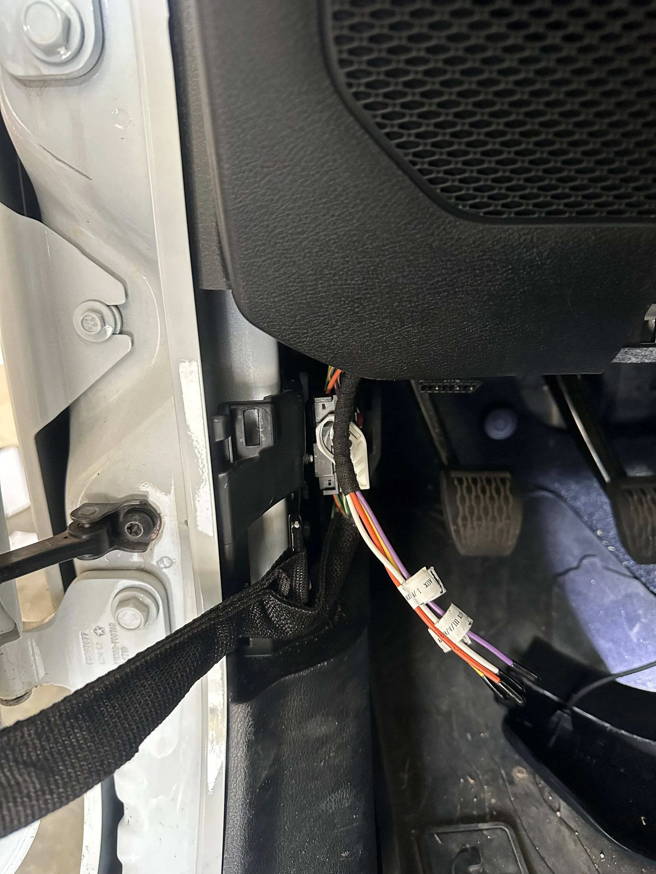

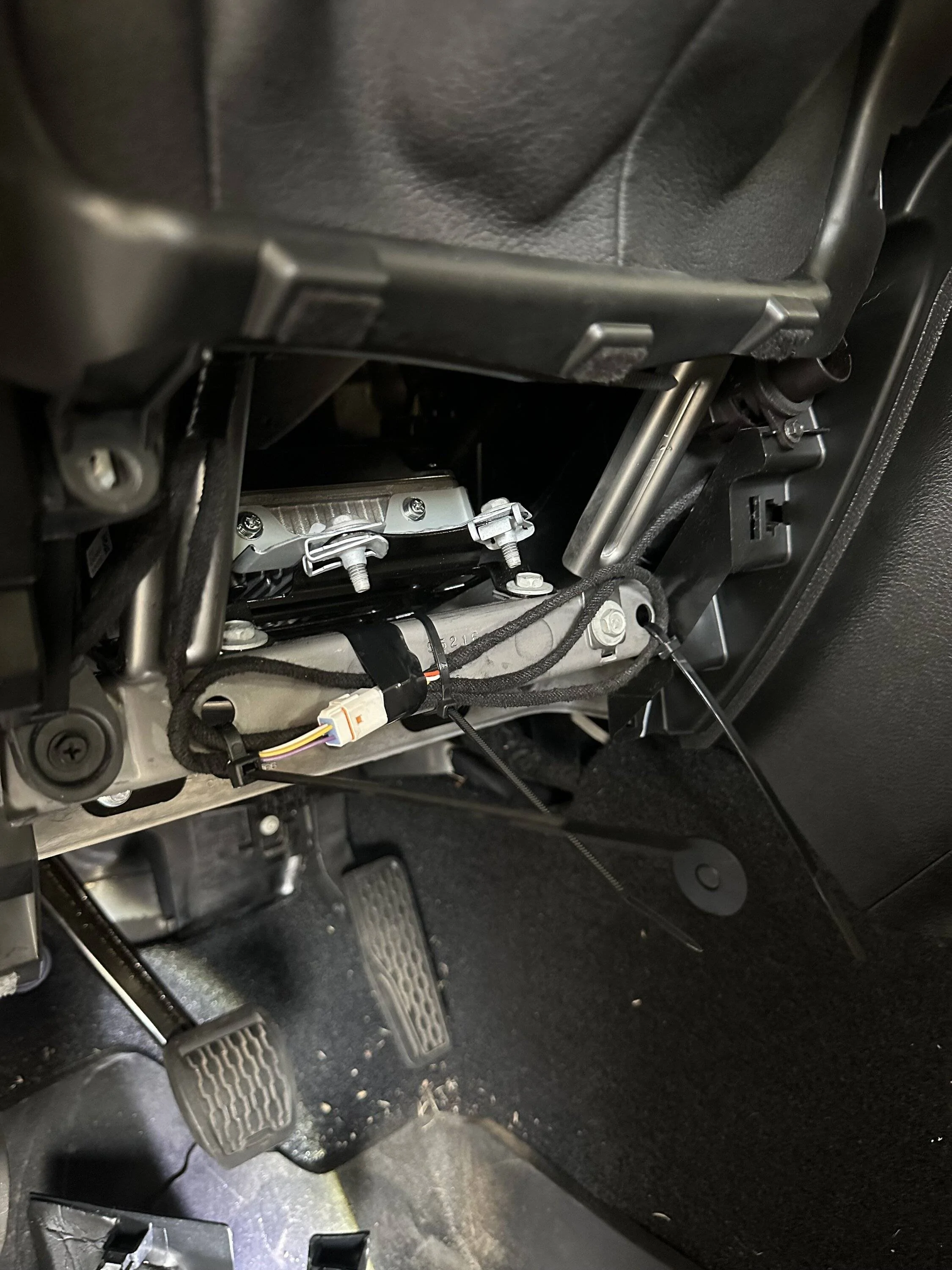

Once inside the cab, I ran the wires underneath the dash speaker. I had to fold the window down a bit and remove the dash speaker to do this. Meant to take more pictures of this part of the process, but you get the idea. From there, it was pretty straight forward to just pull the wires underneath the steering wheel and over to the dash. I decided to run the relay wires to the driver's side kick panel. You have the little panel for when you take the doors off. The panel is easy to remove in case you need to get to the relay wires later.
I mounted the relay connector behind the panel underneath the steering wheel. It was a convenient place to secure the wires and I wanted it easily visible should I need to disconnect the panel in the future for some reason. Used zip ties and electric tape to keep it away from the steering wheel and prevent rattling.

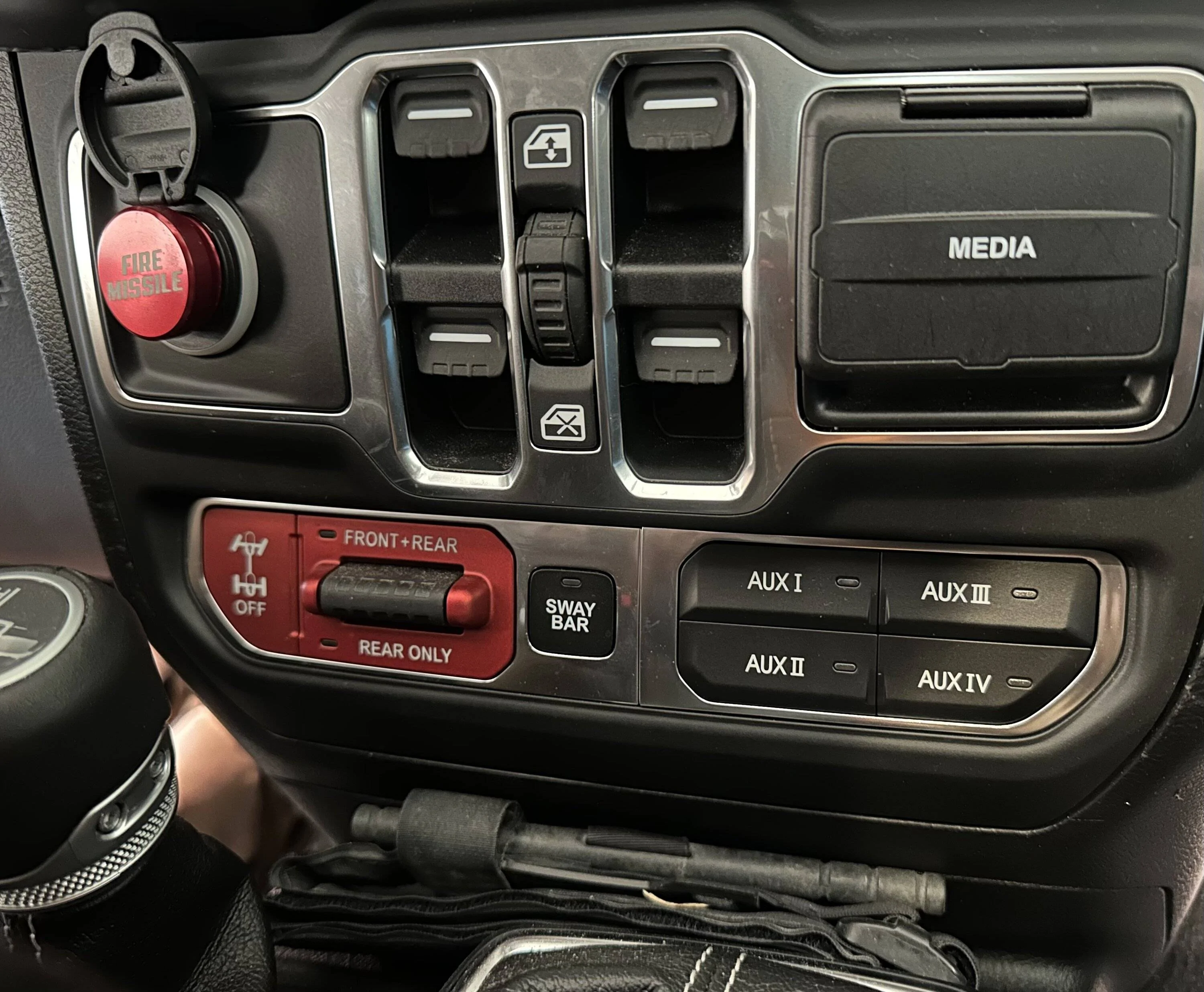

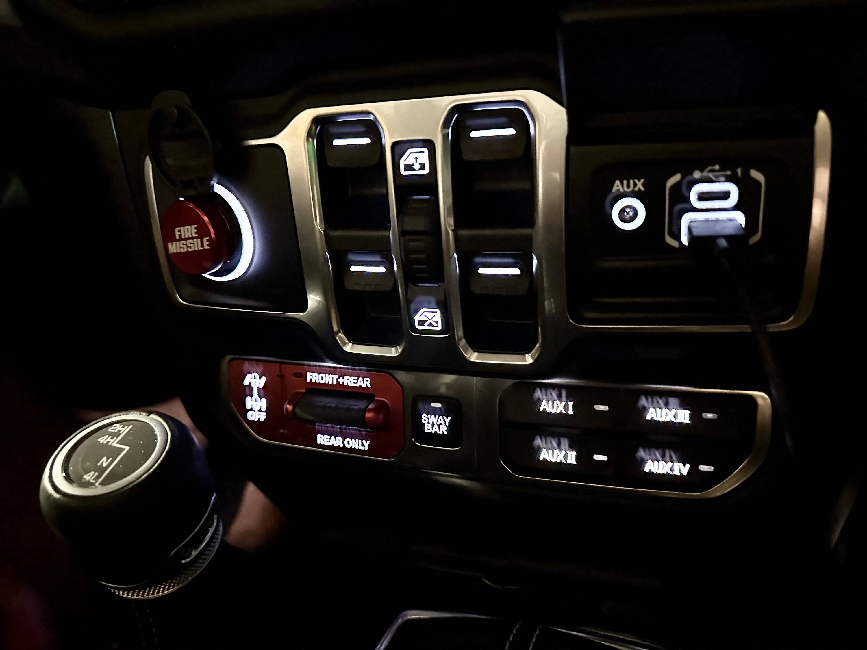

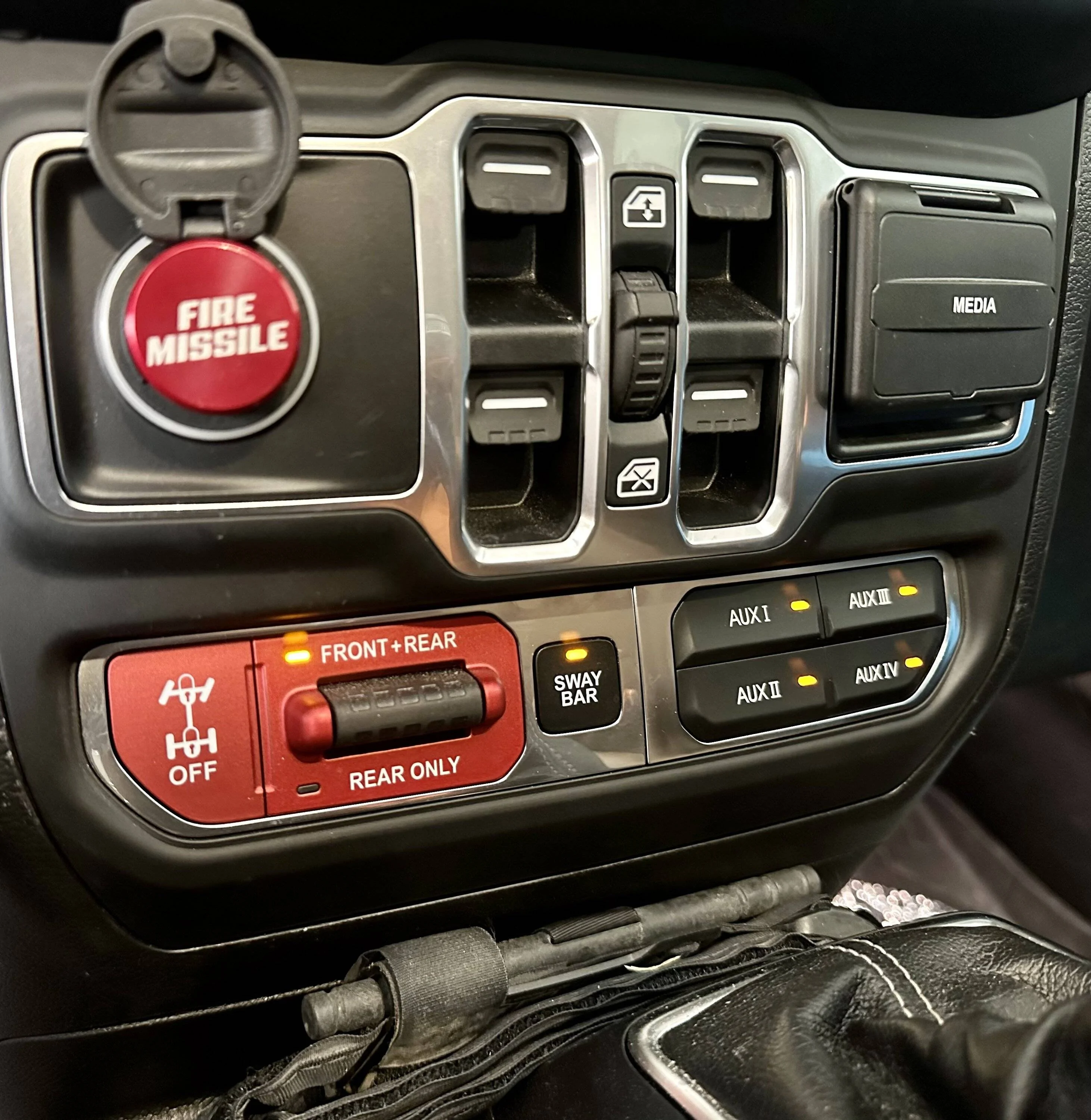

Nothing major to note with the rest of the install. The switch panel looks factory in color, feel, shape, etc. Overall, I would say it is a great option if your JL did not come from the factory with a panel. I have included a few pictures below. The only negative remark I can think of is the backlighting looks very, very slightly different than the rest of the dash. It does not bother me at all but I figured I would mention it since it might bother some folks. I tried my best to get a good picture of the difference, but it was a little hard to capture.
