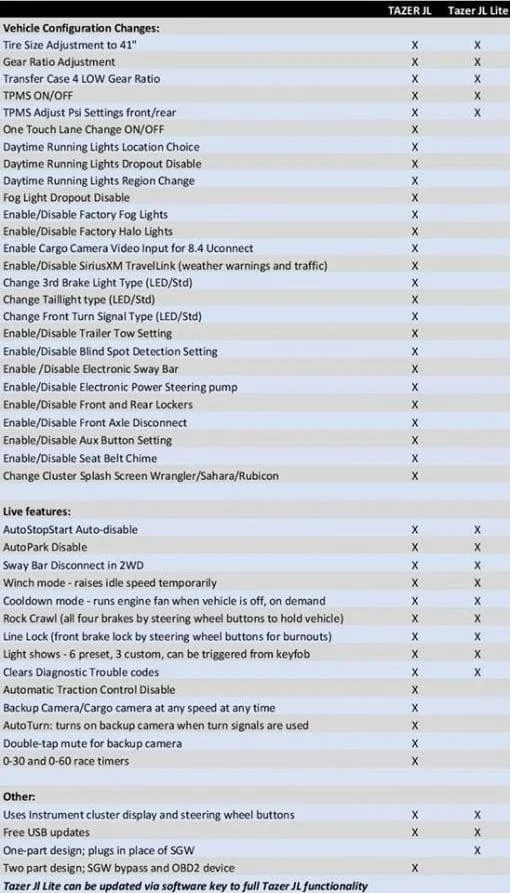

Sounds like they forgot to flash it. I paid an additional $60 for the flash. Call them back and ask them. Another option is to buy the Tazer JL Lite and flash it yourself.
Would have to use a Tazer JL to enable Aux.... A Tazer JL Lite cannot enable Aux, unless the owner pays $125 to enable the Tazer JL Lite, to have full Tazer JL abilities.
BUT, yes, before I paid a dealer to enable Aux, I'd buy a Tazer JL or fully enabled Tazer JL Lite.
Tazer JL / Tazer JL Lite ----- Quick view:
Jeep Wrangler JL Aux Switch Install Features-list-jl-lite-510x893
