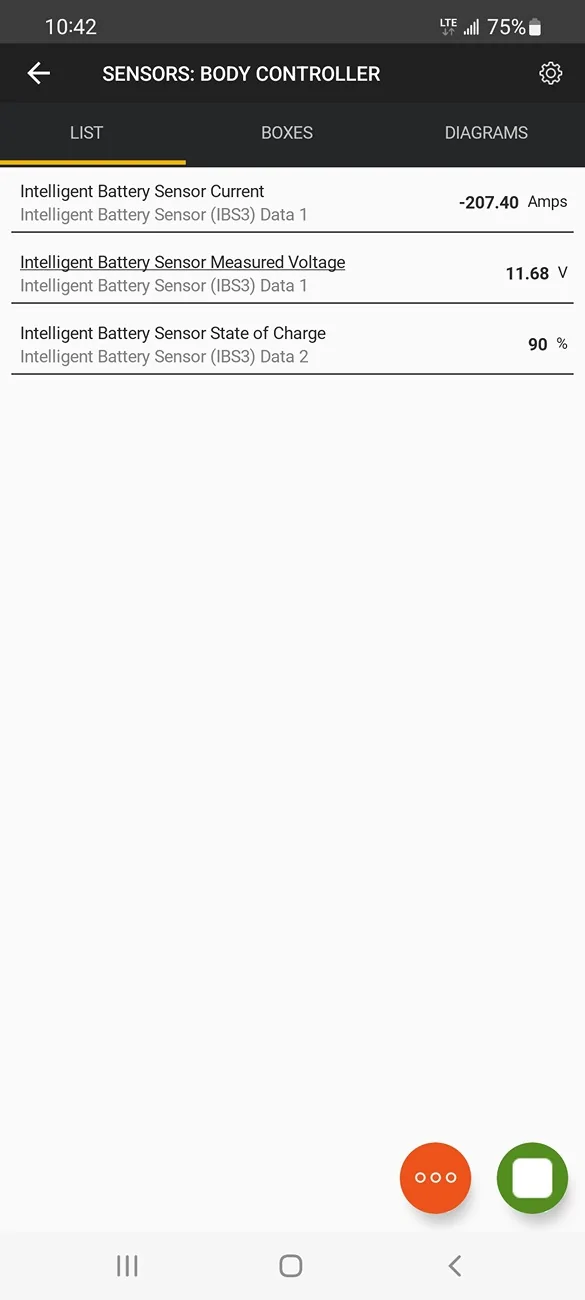

Technically, the AUX (ESS) battery ground wire/path goes "over" the IBS, not through it. The IBS monitors only CR[an]]K battery current.
The IBS monitors ALL power going in and out of the main AUX battery, and except when the AUX battery is disconnected during a ESS event. It doesn't just monitor cranking current.
I've been monitoring the IBS on different jeeps for years and it does far more than measure cranking current.
Example
Jeep Wrangler JL AUX Delete getting cancelled by accessory ground Max draw from 12v
This is me running a 2000w inverter off the H7 battery in my 4Xe without it running,
Example

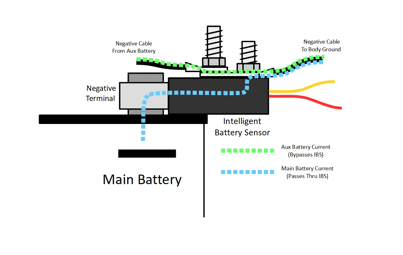

The current paths work thusly:
Jeep Wrangler JL AUX Delete getting cancelled by accessory ground {filename}
(from: 3.6L ESS IBS Information)
So, the IBS monitors all CR[an]K/main battery current, and does not monitor any AUX (ESS) battery current.

I'm well aware of how it works....you had said it only monitors cranking current......which was incorrect.
I have a lithium battery hooked up to my AUX battery with a shunt, so I can watch the current during ESS events, there isn't a whole lot of draw on the AUX battery during a ESS event.

So there we have it. The solution to my mystery is that when I connect my WARN winch ground cable to the main battery negative post, I have power running through the vehicle, even in the case of F42/thick cable isolation.
That explains it!
Of course it appears the safest solution now is to fully remove the AUX battery. I suspect that this will also solve the case above where my winch ground is causing power to flow.
Disconnect the "thinner" cable and remove fuse F42, and your AUX (ESS) battery will be disconnected the way you want.
The winch ground wire won't keep the AUX (ESS) battery connected f you remove the proper ("thinner") cable terminal connector. What happened is you disconnected the body ground ("thicker" cable) instead of disconnecting the AUX (ESS) battery ground, so your AUX (ESS) battery ground ("thinner") cable was still grounded through the winch/cable. You want to break the connection between the AUX (ESS) battery and the 2 body ground cables (factory and winch) by disconnecting the "thinner" cable.
