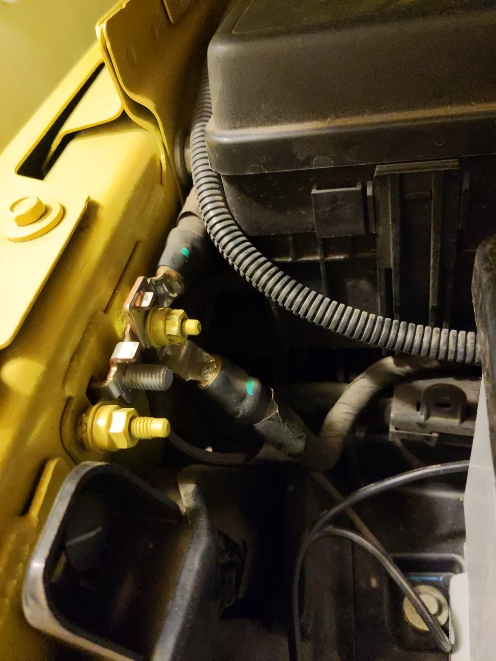

This is the cable I removed (held by a 13 nut), which in the past (when I still had F42), when isolating, would completely cut power from the Jeep (if the whole negative battery terminal harness was also isolated).

Given that you have a 2025, I am inclined to believe you removed the wrong cable: the one you removed being the body ground (which should remain connected) and whose other end connects to the body ground on the passenger's front panel just under the hood. I believe the other cable should have been the one you removed, keep the cable shown as detached, attached.
Please refer here: https://www.jlwranglerforums.com/forum/threads/ess-battery-cable-change.86624/

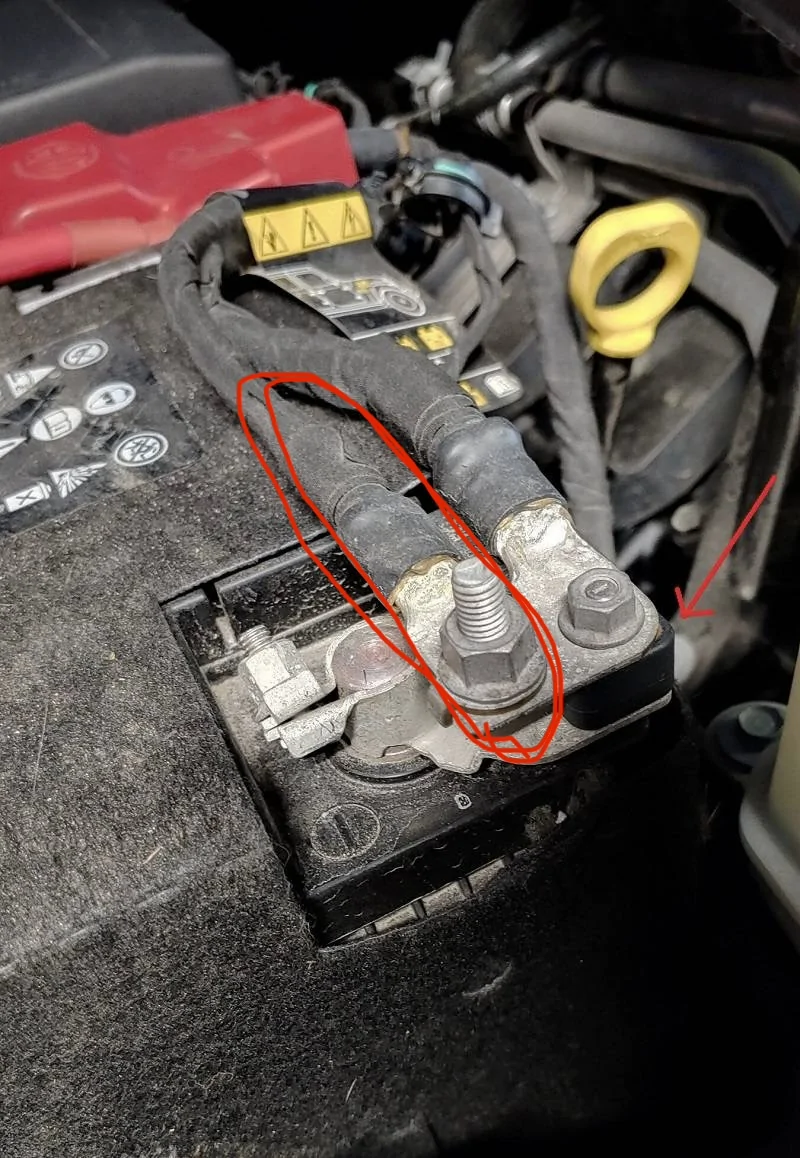

At least on my 2022 the cable you circled is for the main battery, not the aux. Take a look at the negative cable that's currently connected to your main battery. Trace it with your fingers. Does it go down under the power box or does it go across to a ground on the right side next to the battery and in front of the power box (pictured below)?

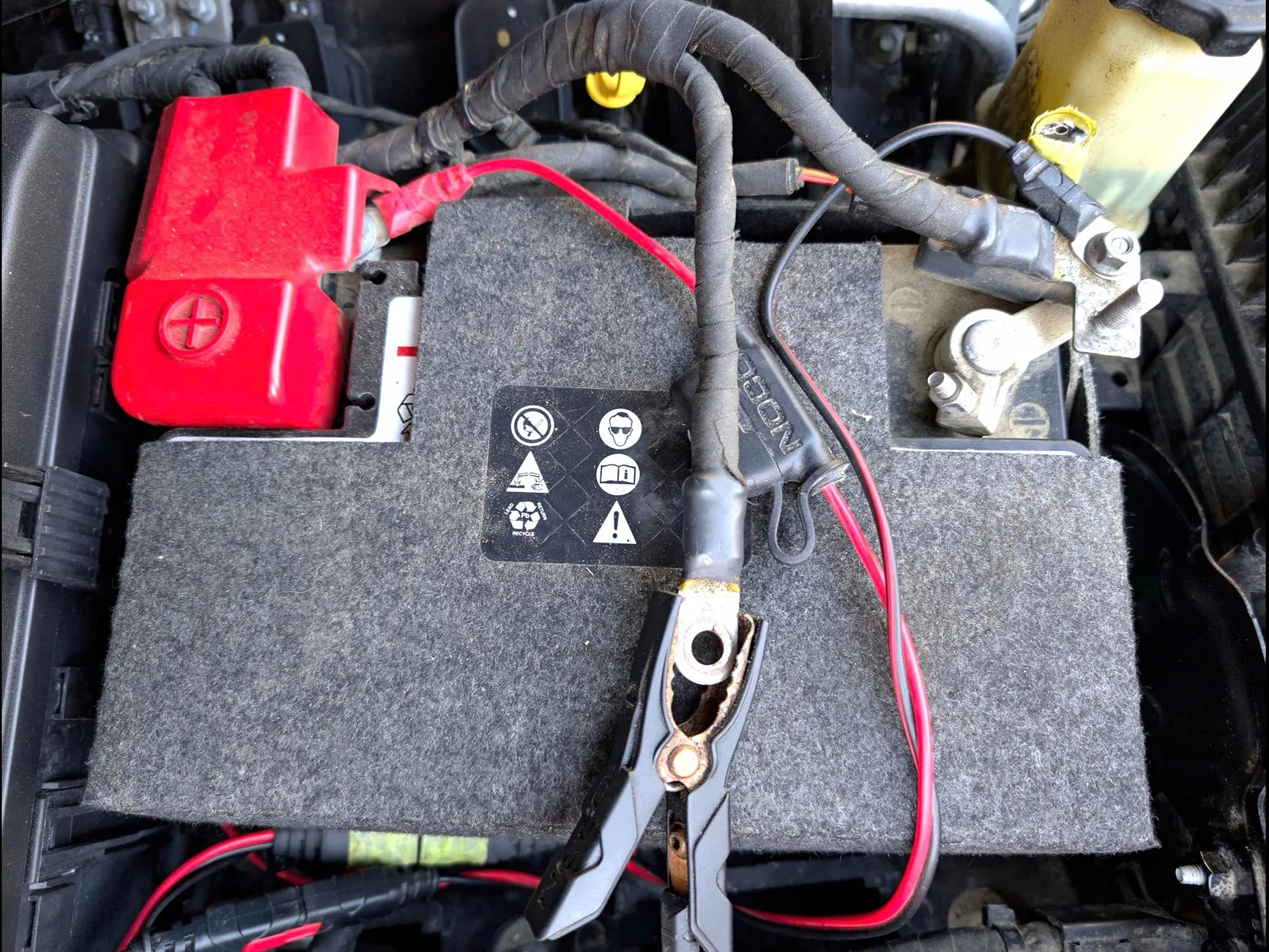

Here is our 2018 showing the alligator clamp connected to our aux neg.
Pull out your multi and check which leads are providing voltage and go from there. You should be able to get it sorted pretty quick after that.
To reiterate my post, what is the correct cable for you and me ('Im also a 2018 JL owner) is likely the opposite cable for the @Tr4ckD4ys, a 2025 owner.
It was thought that the cables were swapped some time in 2021:
