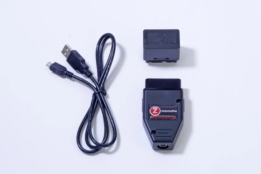

Ya know I was trying to be nice and play dumb by saying I was confused. Thought maybe you would chime in and take the high road. Well that's over. You are completely wrong in your description of how autopark works and your contradicting the manual excerpt above. Just admit it, the Tazer isn't disabling autopark if you still need the seatbelt engaged. Period
@Arrowhead
I never contradicted the manual excerpt. I never tried to explain how auto park works.. I understand about the seat belt..
All I was / am trying to say is with the stock JL, I cannot open the driver's door while moving forward or moving in reverse. IF I do open the door, the vehicle comes to an abrupt halt .... is in auto park. So, if I am backing up a trailer, and I open the door to look back... to see better the JL stops.... is in auto park. This happens whether the seat belt is buckled or not. Happens going forward or in reverse.
Now, if I select ON in Tazer JL settings in regard to disable auto park, I can now open the driver's door when driving/ moving forward or when backing up. I can backup a trailer with the driver's door open. I can drive forward with the driver's door open. Again, I cannot do this without the Tazer JL.
In closing, with the Tazer JL., I am a head of the game regardless................

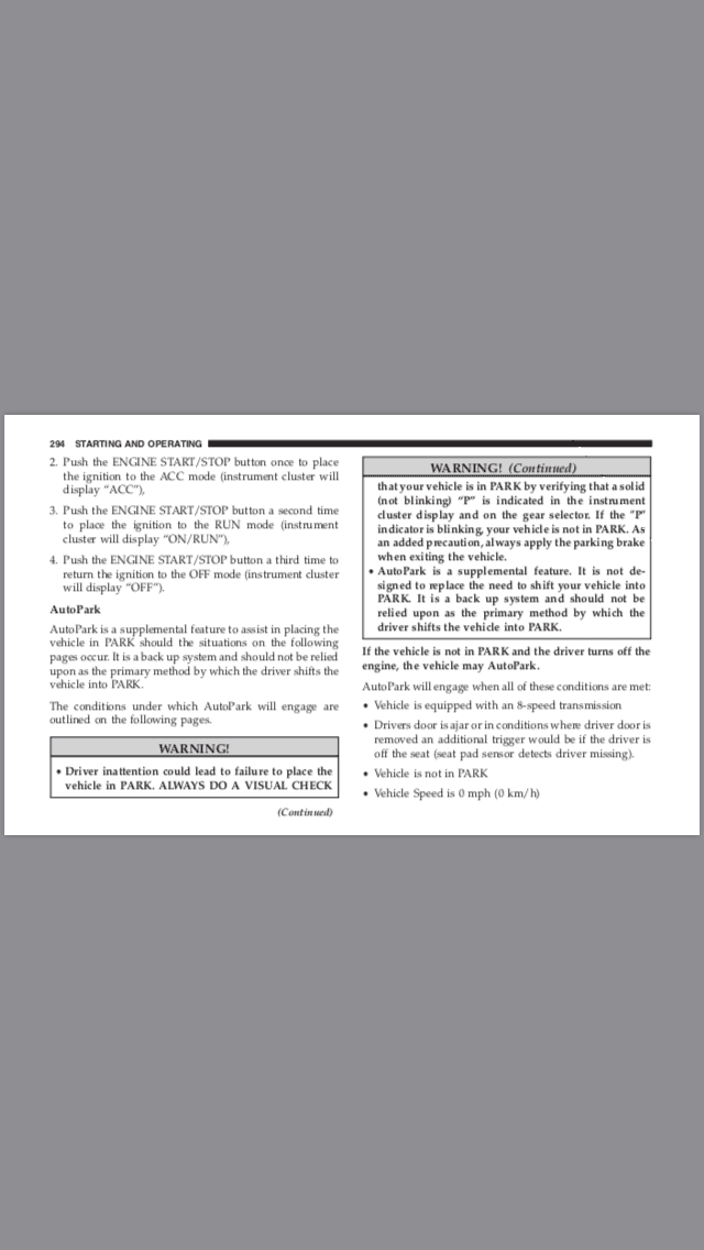

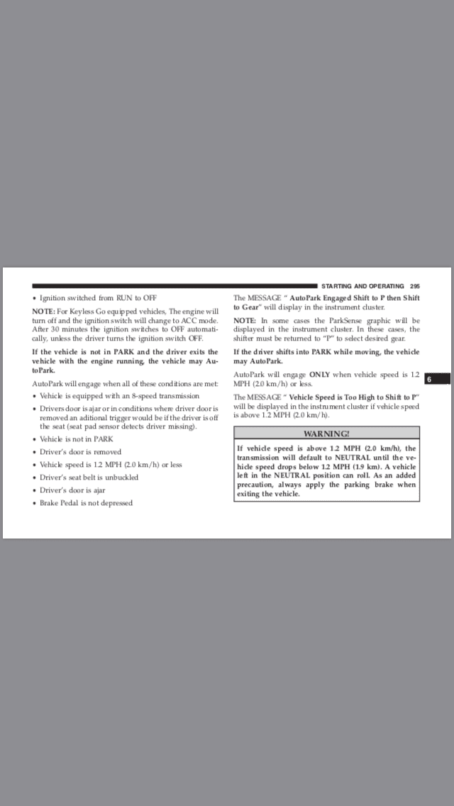

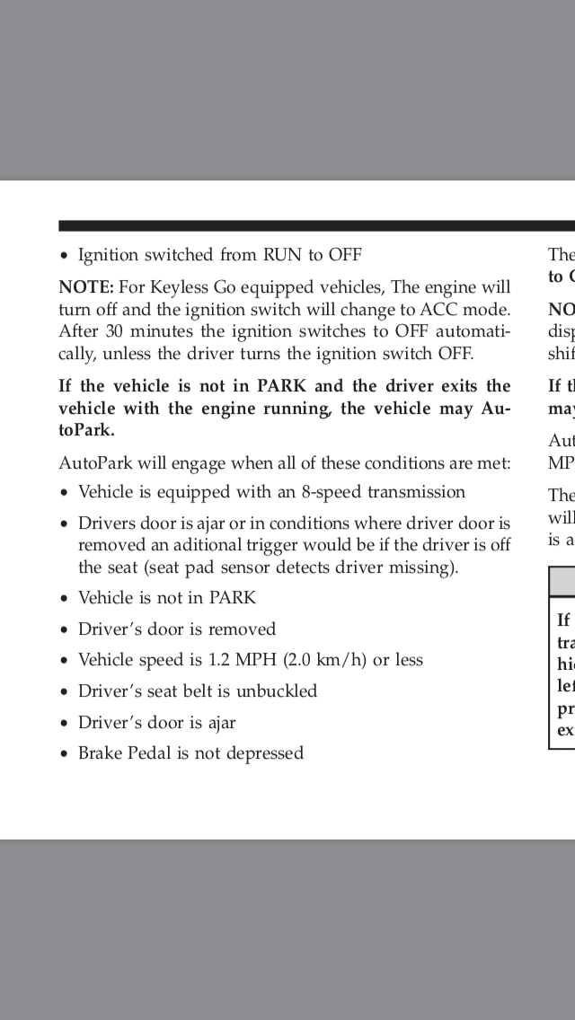

Then your Jeep is not operating correctly and you might want to bring it in for service. The Autopark WILL NOT engage if you open the door with the seat belt latched. If any one of the condition as listed in the manual are not met, then Autopark will not engage - seat belt latched is one of them (yes, I've test it). That's why the Tazer requires the belt to be latched - it really isn't defeating the Autopark function, the seat belt is.
According to the manual “ALL” of the listed conditions have to be met. So if you leave your seat belt buckled it should not autopark when you open the door. Is this not true?

@Arrowhead
Because of this back and forth in this thread, I just went out and with the Tazer JL not in the picture, I fooled with triggering auto park.
I have had my JL since May, and when I originally fooled with auto park I am sure I could not backup or move forward with the door open and seat belt fastened. SO, I hooked up the Tazer JL a couple of weeks after and found I could now open the door when backing up as long as I had my seat belt fastened. I thought the Tazer JL gave me this perk..
WELL, just fooled with the JL and damm, it is behaving exactly as per the manual excerpt.... as you mentioned..
So, indeed the TazerJL is not disabling auto park as I still need to keep the seat belt fastened.
In closing, I still feel the Tazer JL is probably the best addition to my JL. All the other features are a real plus to me.
Geeeez, do I have egg on my face, but I admit it. Thanks for the wake up call, @Arrowhead
