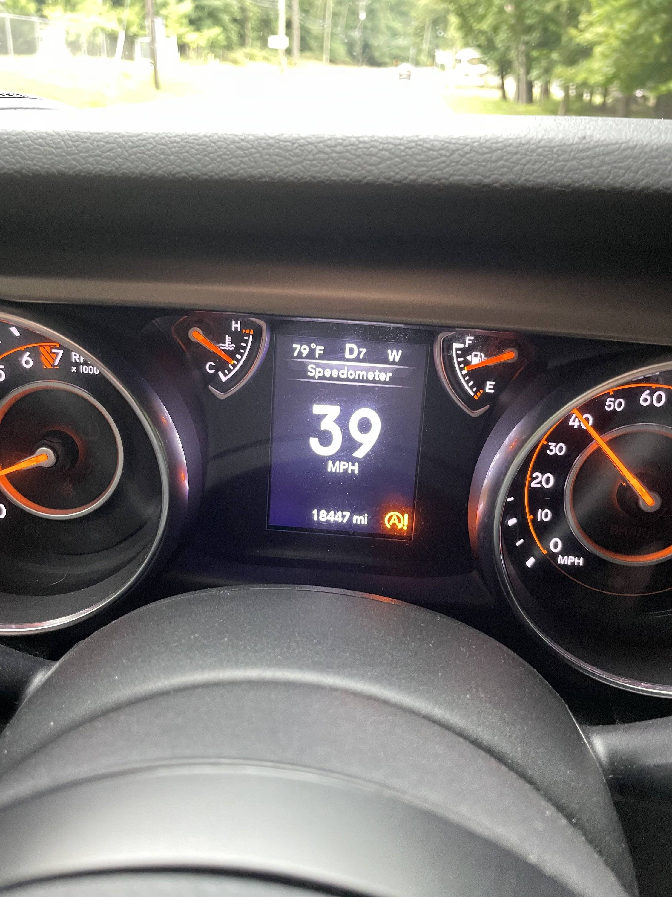

Can anyone tell me how to address the error code popping up? Attached is the picture of what I see on my dash.
If the seatbelt is not latched for the driver you get the autopark where it goes back in park when you put it in gear. And the auto start stop doesn't work without the seat belt. Also there is two switches under the hood. One of them is for start stop start when the hood is off or open it gives a fault. You can actually unplug this to keep it from shutting off at a redlight. But it gives you that same fault light. Doors have a switch also.
