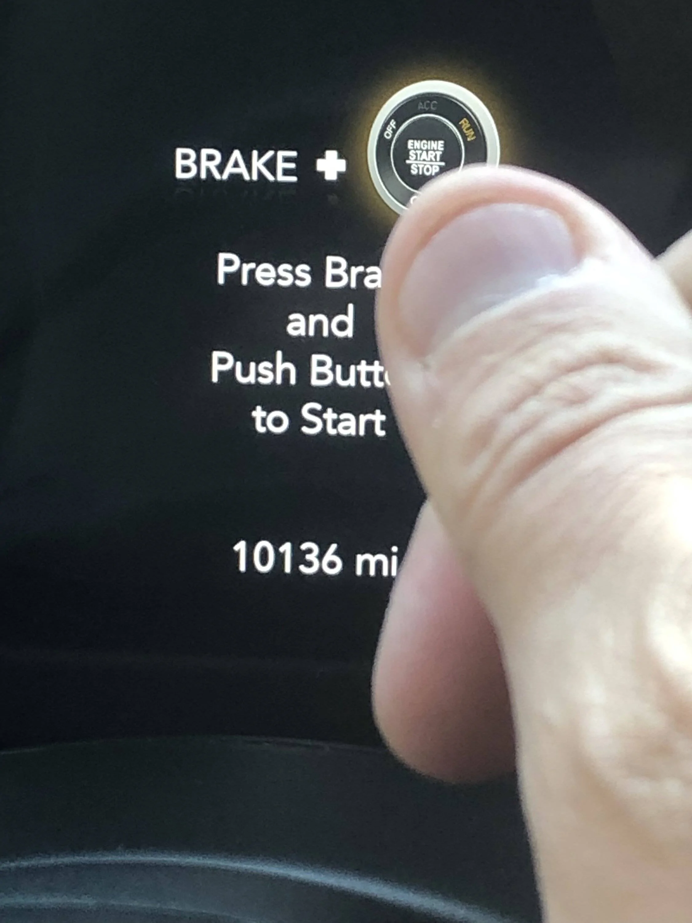

We have 2018 wrangler and for the past few weeks we get start stop error message, check engine light and for a short time the dash will go blank, no speedometer, radio, etc.
When looking at codes it will show over 30 codes we are assuming they are false codes due to whatever is going on electronically.
It seems this is happening when we hit a rough patch in the road or go over railroad track.
We have confirmed both batteries are good and our software is updated.
It has been at the dealer since Monday, not sure that they have really looked at it.
Has anyone had this issue
