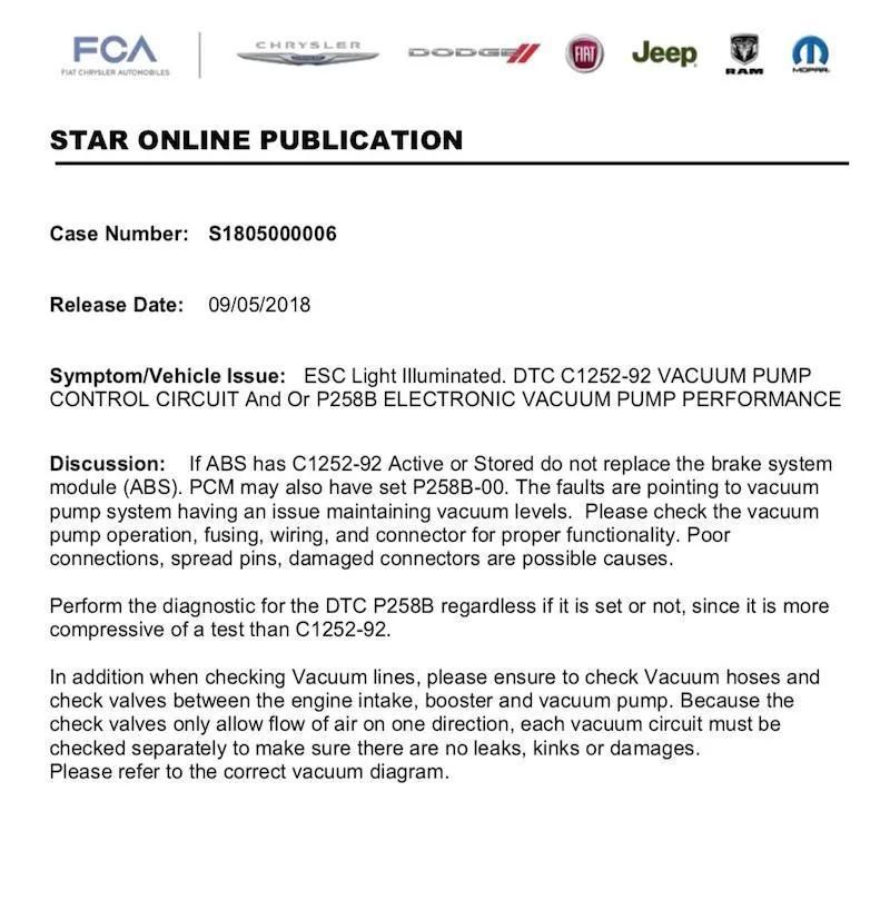

I am back in the shop. Issue came back Sunday. However I didn’t have the cel only the stop/start error. They are looking at it now.
Most common causes for a P0507 code is either a vacuum leak or a faulty Idle Air Control Valve. There is a TSB for vacuum leak, have your dealer check it out,!
