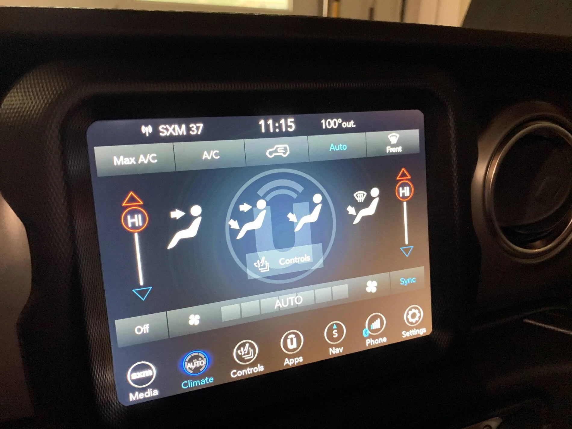

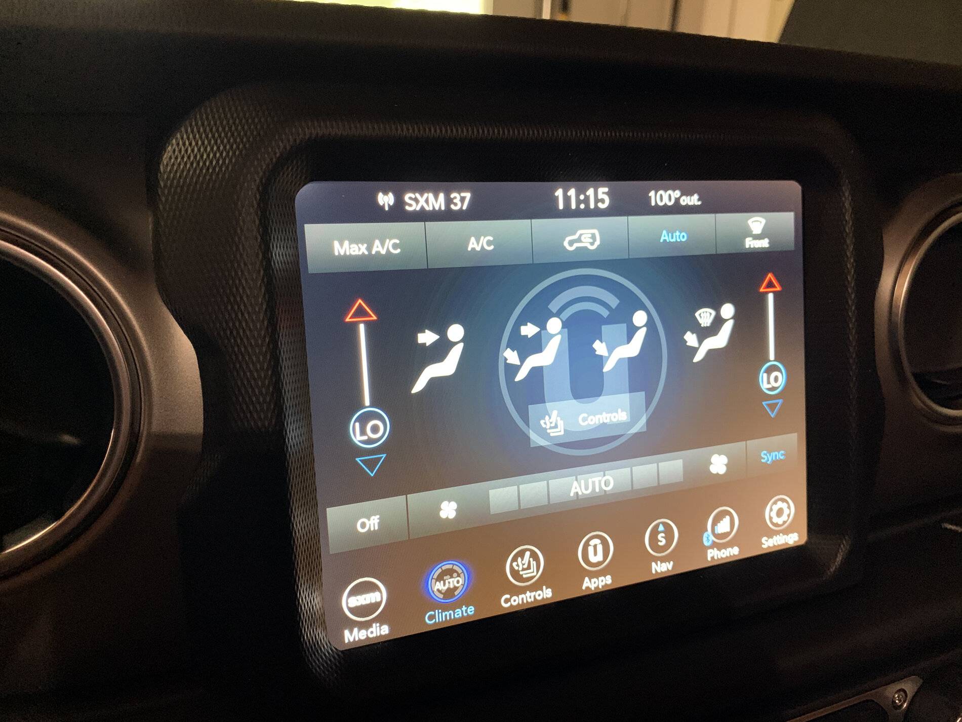

JLUR is brand new, 150 miles, went to drive it today and the climate control will only go either "hi" or "lo" and won't let me select a # temperature. A little frustrated.
Reset the radio settings.
Checked the fuses.
Unplugged the entire battery for 10 minutes hoping for a reset.
Any thoughts? Trip to the dealer? Kind of a hassle...

I pulled my fuse to the radio for an unrelated issue but mine did the same thing for a few minutes. Then the screen changed from blue highlights to a brown/tan that I’m familiar with and it works fine now.
Try pushing in all your fuses and relays. *shrug*

Shut the vehicle off, close & lock the doors then let the vehicle sit for a while. The Uconnect radios in the JL sync up with the vehicle and learn what features the vehicle has. Sometimes this gets out of sync and the vehicle needs just sit so the radio can re-learn. Give that a shot and report back what happens.
docwilson
Mar 18, 2021
30
2021 JLU
Issue appears solved! In addition to the previously mentioned efforts, I next tried pulling the fuses and making sure everything was seated well, but no change. Lastly, I read somewhere on the internet to soft reboot the Uconnect by holding the power button and tune button at same time for about 30 seconds. After doing this, it seems to have returned to normal function.

This is totally normal on the JL platform. The Controller Area Network (CAN) communication gets completely reset in the event of a total power failure, usually caused by the disconnection of the battery terminals.
Once the power is back, you can let the jeep sit for an hour or so to allow all the dozens of modules in the Jeep to reestablish connection with each other via the CAN and let everything go back to normal.
Just be aware this will happen during every battery disconnection.
