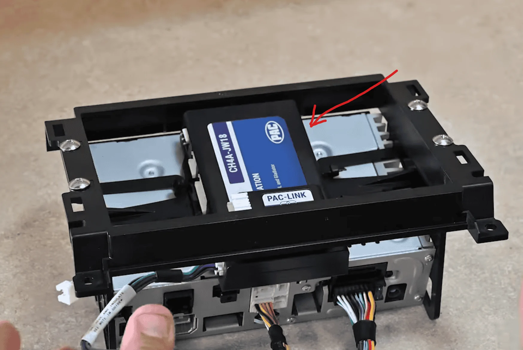

which box is the Pac Box? Is it the blax box where the sd card for navigation pligs in? I have to update this. First i have to get a PC to use.
No thats your main head unit. The pac box is mostly blue. Should be ziptied right in between your head unit and screen. And the mini pac should be 2 sided taped to your main pac unit. I installed mine my self and followed some you tube videos. Let me go see if i can find one highlighting the PAC unit.

Jeep Wrangler JL Stinger Heigh10 + NON-AUTO climate controls... 1685495250784
That.
Where the arrow is pointing is where the mini usb cable plugs in.

Yes you have to pull the display off. Plug in a mini usb cable from your computer with the pac updater software into the big Pac module not the mini one. Power on the jeep. The software should go from not connected to connected. I think at this point there was a click sound and the display turned off. Flash the new firmware file by opening it in the pac updater. It takes a little bit so be patient until it says complete. Power off the jeep, unplug the usb cable. Open and close the door and wait for a minute or so to get the radio to completely turn off. Hop back in and power it on and should boot up. I think I had to reboot it one more time before the climate icon showed on the main screen? Then put it all back together. It takes like 10 mins and works.
I've tried multiple times with 2 different cables and can not get it to say "connected" so it won't let me chose the file or update. At first I did it with no internet connection and I thought maybe it needs a connection, so did that, and it updated the Software on the computer end, and tried again with both cables and still will not say it is connected and will not let me get passed that screen....I'm wondering maybe my cables are not data cables?

I also had this issue with a few cables. I made sure the accessory power in the jeep was on to the module then i connected the cord to the module then to the computer and it worked. Not sure if this helps.
