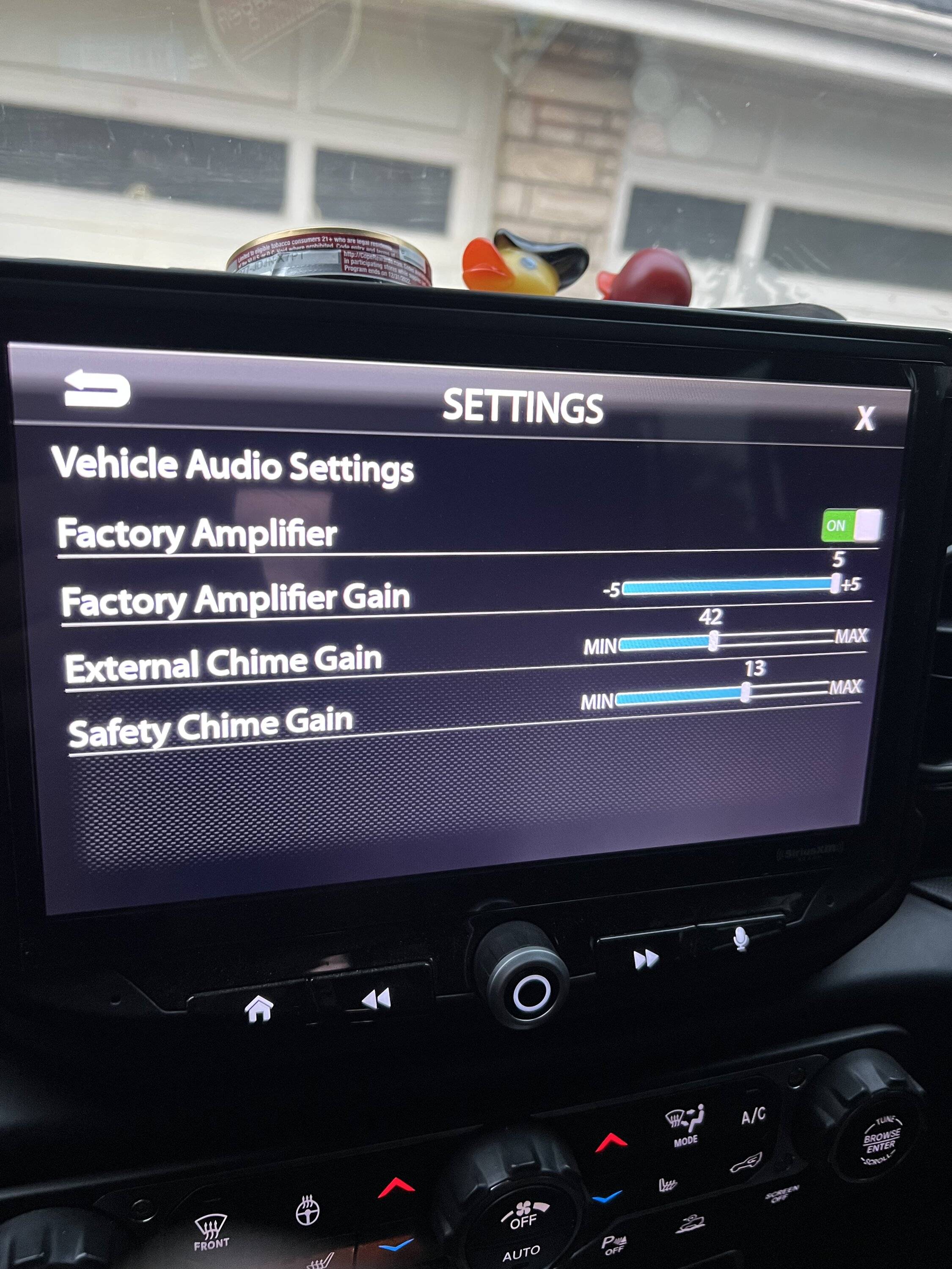

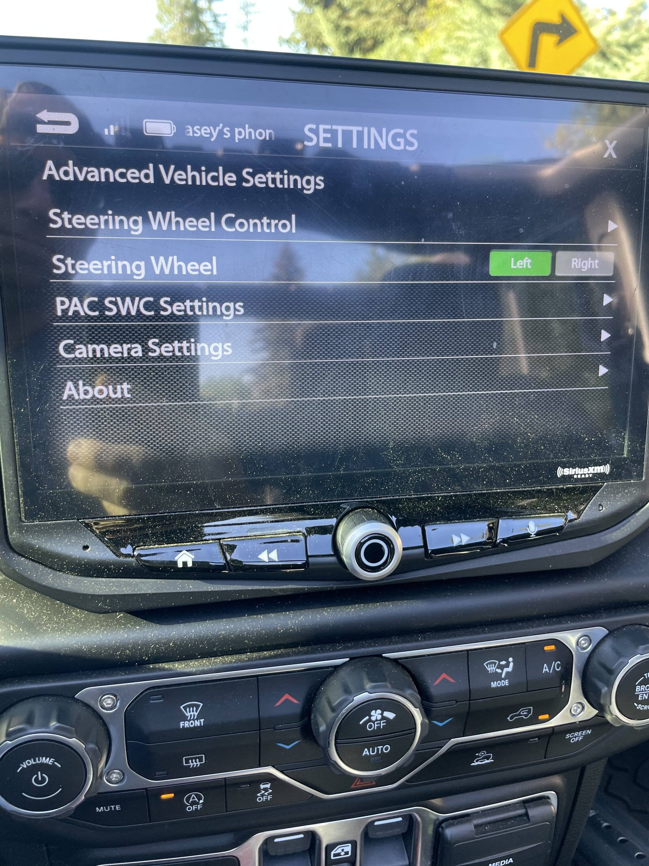

i just looked at radio after you put in passcode and enter installer settings hit advance vehicle settings. from that screen you should see vehicle audio settings. hit that . you should see factory amplifier gain.
im not sure then. i have a vehicle audio settings under advanced vehicle settings. it made a big difference. id email stinger.

The HEIGH10 has a 15-band equalizer, sound correction, and crossover adjustments. If your Jeep is factory amplified (meaning it has the Alpine system), you need to turn on the factory amplifier in the audio settings menu. This will grey out some features, but not all. The factory amplifier is very limited on customizing it's settings. There is also a 4-channel 25w RMS/50w peak amplifier build into the HEIGH10. Regardless of the HEIGH10 being connected to a factory system or aftermarket system, you should be getting a lot better quality sound if tuned correctly.

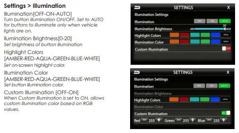

Hey Mike any direction on changing the color of the text on the screen from the white?

Hey John,
To adjust the color of on-screen text, go to the Illumination settings and select the desired color next to "Highlight Colors." Button colors have even more color options with custom RGB codes shown below.
