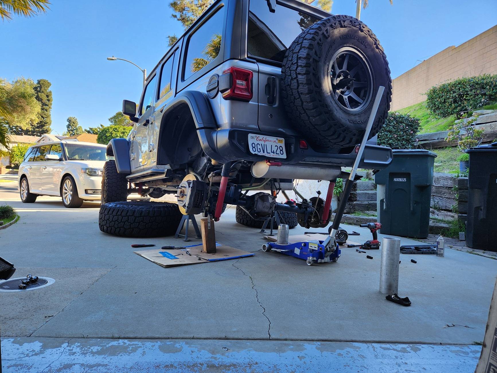

I installed rear 4.5" springs in jeep on Tuesday. Still with my mid-arm. Still 3.5" in the front. Same issue: rear was sagging with all the tools I carry on a typical trail run.
Jeep Wrangler JL Artec Long Arm Kits 20250225_151037[1]
Jeep Wrangler JL Artec Long Arm Kits 20250225_184348[1]

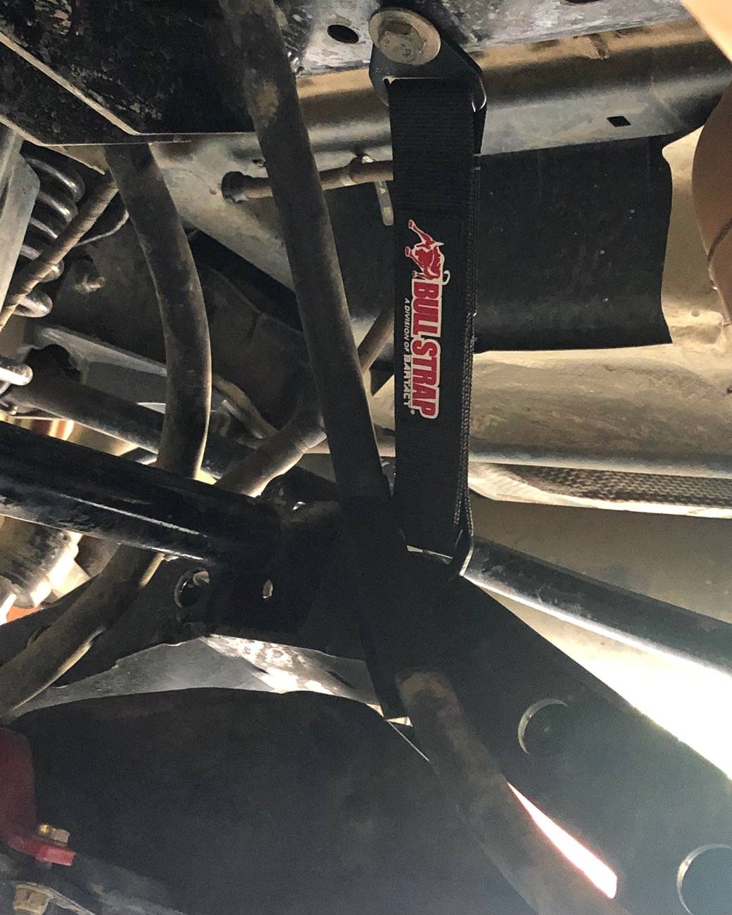

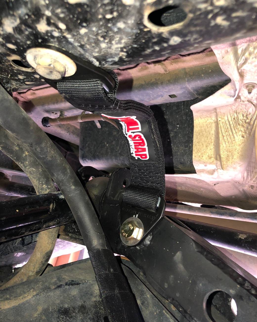

Smart to check things out when running long travel shocks…. Be sure and droop both sides of the axles at the same time…..when stuffing one side and drooping the other sometimes the spring won’t come loose….
On mine, (running almost 31ā€ extended in front on 3.5ā€ springs) the front is ok, but I’m at the limit for coils and shocks on 3.5ā€ lift (which I’d like to stay at). The next move is to go coil overs, bypasses, or ORIs, but I’m not going to do any of that unless I go to tons and 40s……
The rear is where I had to address the coils coming loose at both sides of axle droop ( being on a car lift, or accidentally getting airborne). When articulating, stuffing/drooping, the coils stay put, but both sides drooping they’d come loose….
Not wanting to run limiting straps on the springs, that would be counterproductive for what I’m trying to accomplish which is max articulation….
So, what I decided to do was run a single limit strap in the center…. I welded a busing in the RK truss and bolted a strap from the truss to the frame….works great… when stuffing/drooping strap stays loose, barely moves at all… pics or it didn’t happen, lol.
Jeep Wrangler JL Artec Long Arm Kits IMG_8013
