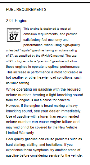

The manual says 87. When mine arrives, it will only see 87 unless I head up to the mountains. The gain in "performance" to me is not worth the extra cost at the pump.
From what I've read, the issue only comes at higher boost levels out of the turbo. Normal driving / low boost, it is not that helpful.
Thank you @2manyhobbies . So many are stating that "the manual says use premium." Not mine. And optimal performance is not anything that you will feel seat of the pants. I've run 3 tanks back to back on premium and regular. No difference in fuel economy or seat of pants feel in performance.
