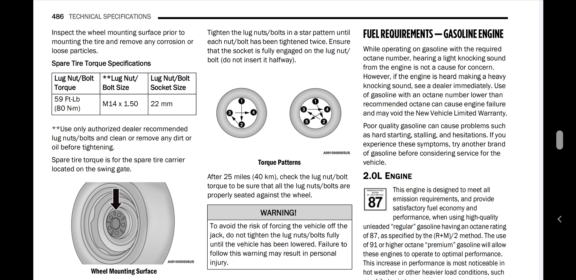

Just curious is everyone following the manual and use the premium gas ?
If you use regular will it really cause issues ?
Perhaps elsewhere is this thread this had already been posted from the '21 owner manual. The 2.0 is designed for 87. That said, I typical alternate btw 87 & 91. I've not seen any difference in performance or mpg regardless of the octane level.
Thanks Buck.
Interestingly it also states "use of 91 or higher octane “premium” gasoline will allow these engines to operate to optimal performance".
Personally, I'd like the optimal performance gained from 91 octane, however, the engine can run safely at 87 octane.
Up to you...
