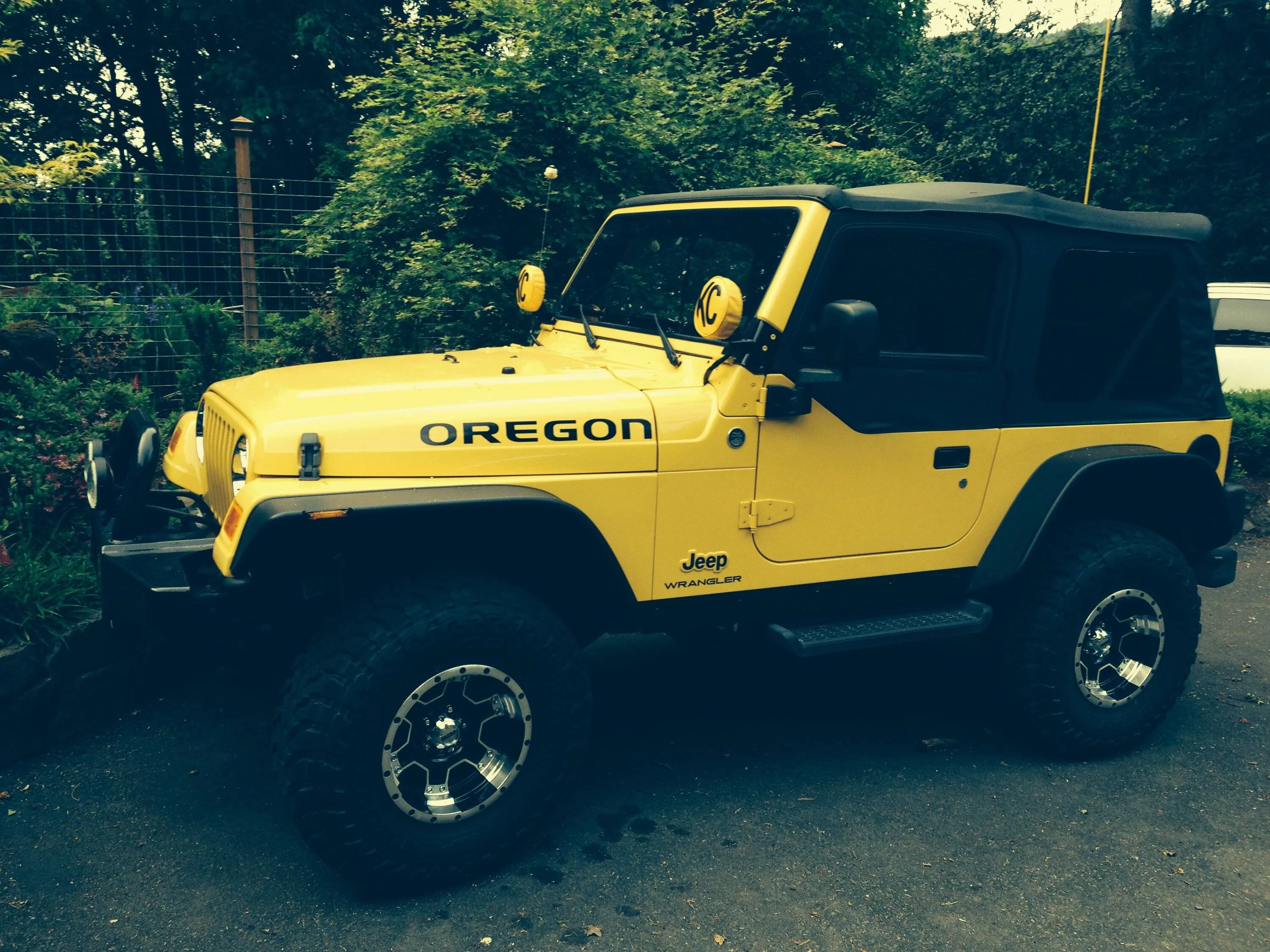

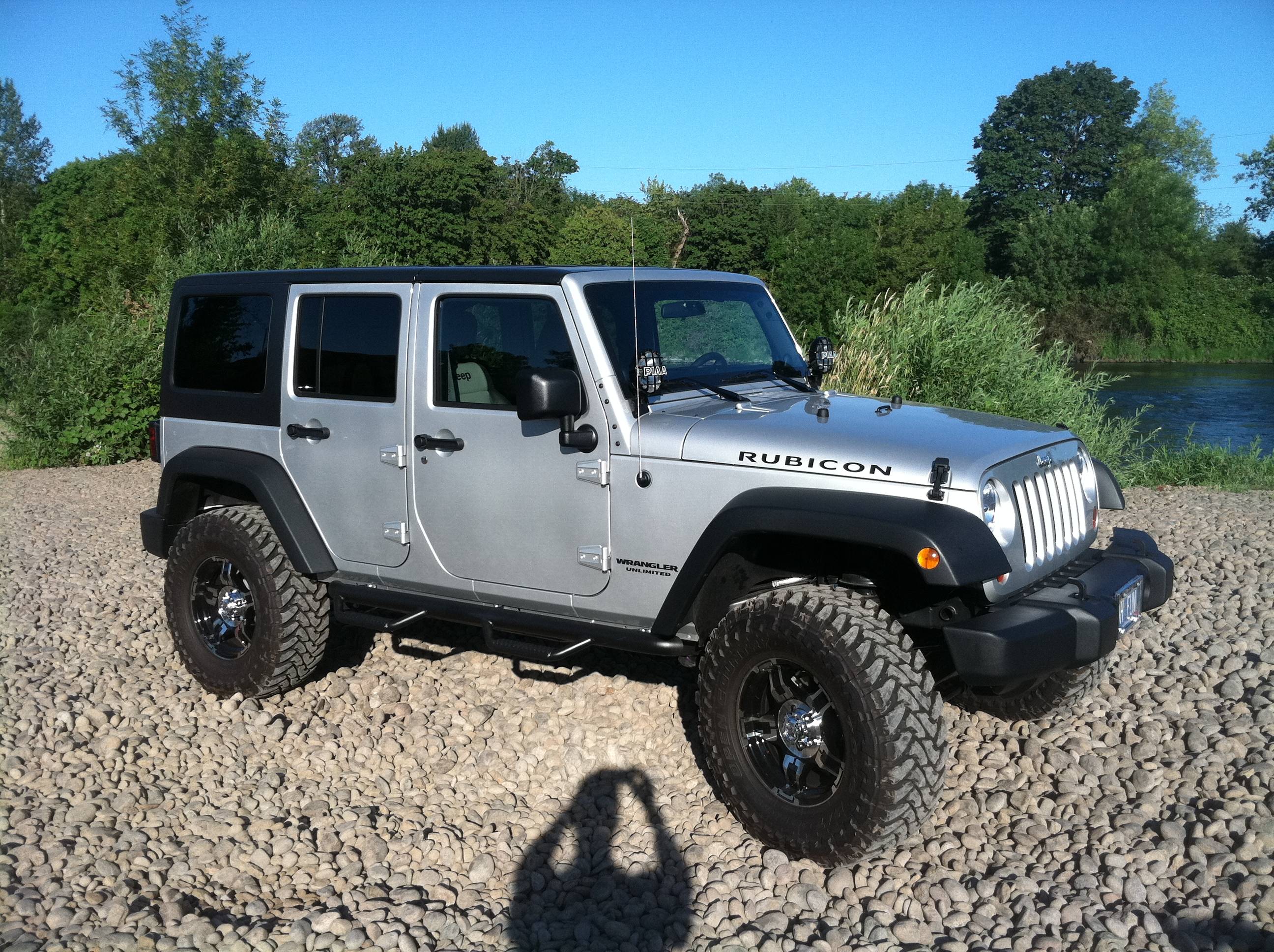

I‘ve had several sets of Toyo MTs. Two sets of 35s on F350s, a set of 35s on my wife’s JK, and one set of 33s on my last TJ.
The Toyos were good in mud, fine on the rocks, less prone to hydroplane, very quiet for a MT, and they lasted forever. I loved them on everything but ice, where they were like wearing football cleats to jog up polished concrete. Much better to have tennis sneakers (KO2) for that. The best compromise for me, for winter, is studded Duratracs. They drive over/through anything. I have 35“ Duratracs on our Raptor, which is great snow and ice mobile with 400 pounds of sand in the back.
The Duratracs are available in 37s, but only sized for a 20” wheel, which looks silly, drives harsh, and leaves less sidewall for airing down.
