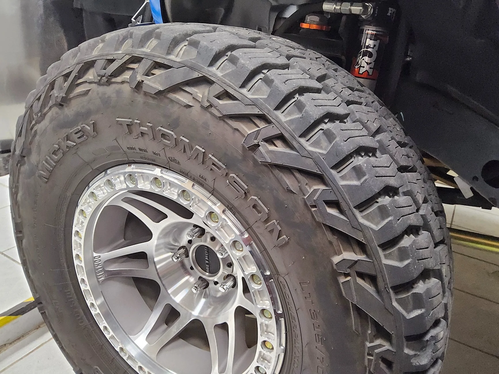

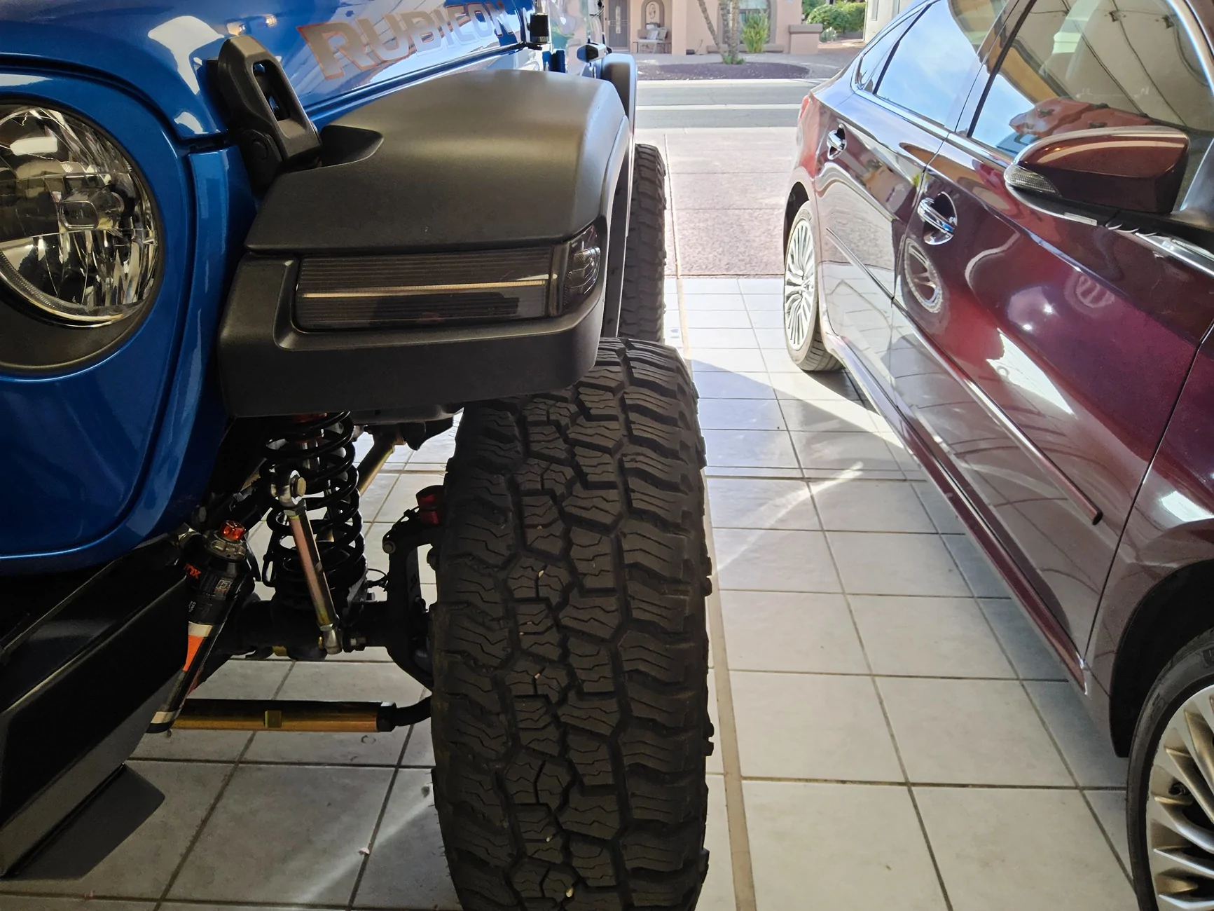

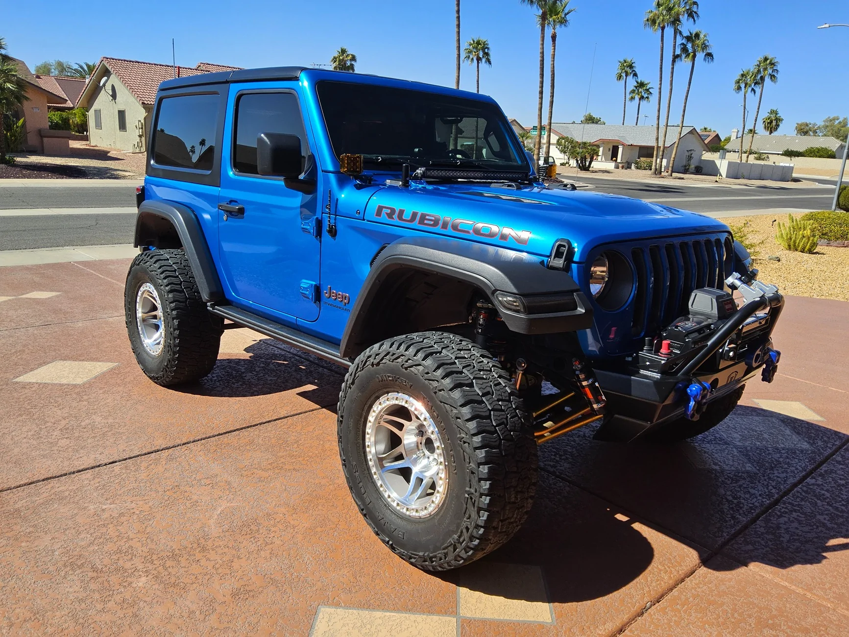

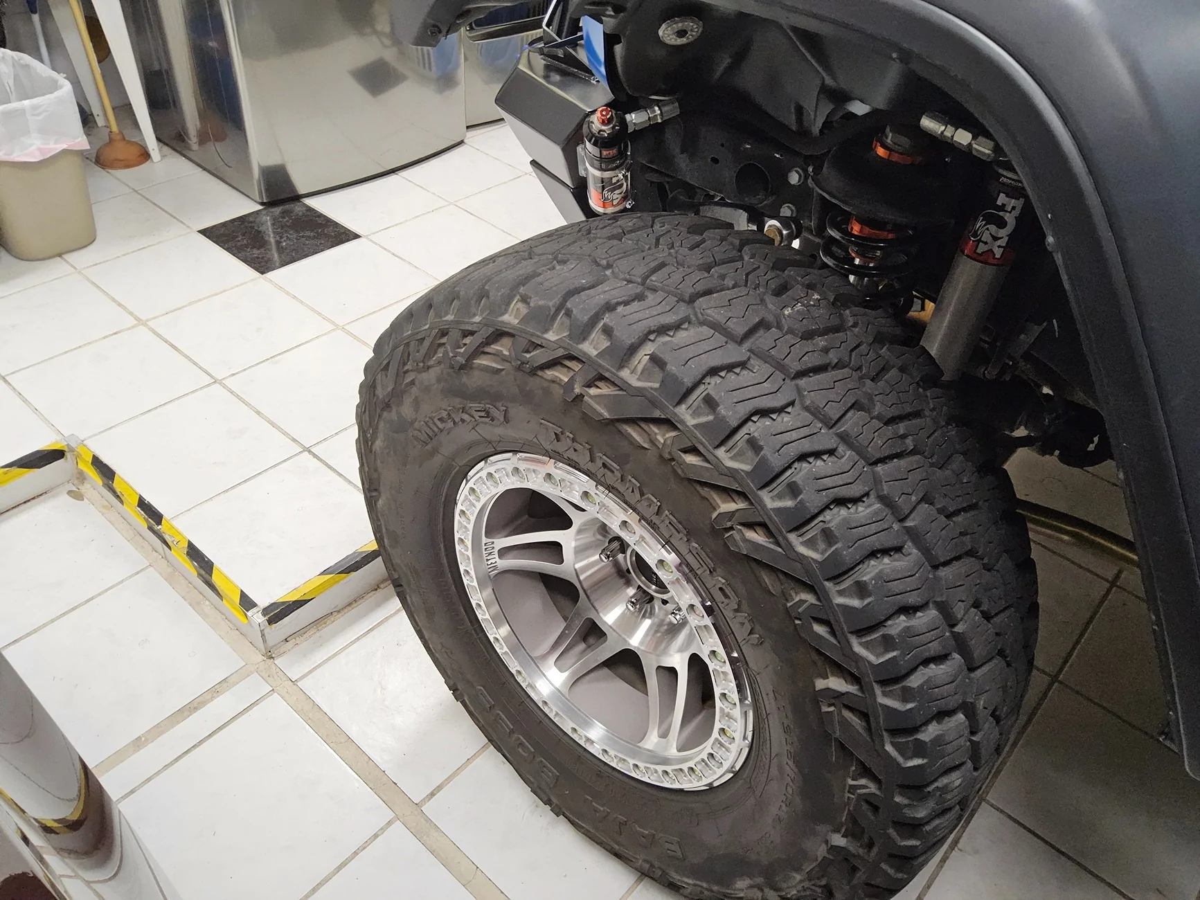

I'm running the Methods 106 Beadlock with zero issues on my 23 Wrangler Rubi 2 Dr. 3.6 eTorque. I am running with the Mickey Bajas LT315-70-17 Load Range E. I don't lose any pressures over time. On the trail, I run them down to 10 pounds and on the road, I run them at 35 pounds, per Mickey Thompson Customer Tech Support and I have very good even wear especially for a 5900 pound laden vehicle.
You do need to check the beadlock bolts torque every month. I'm approaching two-years of running them and in that last few months, I very seldom come across any bolts not meeting the torque spec.
I make a point to check the torque on the 1st of every month.

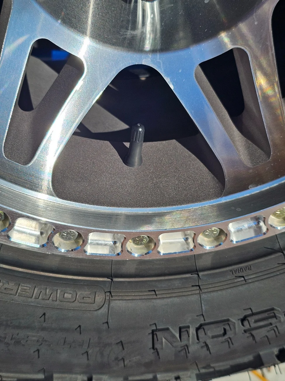

My TPMS valve stems on my 106s.

That is much better than with my 703 Beadgrip wheels. Too bad Method only does that with the beadlock wheels
