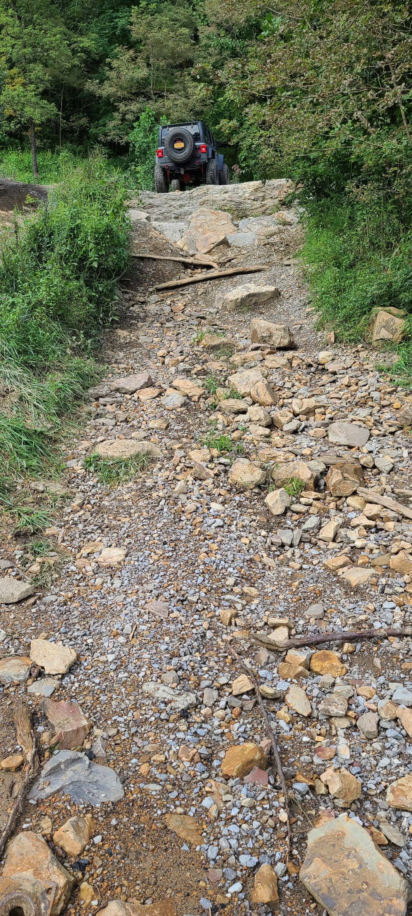

40's and lifted 6" over stock, and still rocking the factory 4.10's on my daily driver/rock crawler. Performed amazingly in Windrock Park.

This short cut through was a lot steeper than this pic shows...

Was this a shortcut up the gravel trail to the windmills? I wanted to try it when I was there over Veterans Day weekend but man it had just rained and it was so slick.
I forget the trail designation (P1 or G1 or something like that), but there's a hairpin right-hand curve on the main trail heading up from the general store. That was a cut through option instead of continuing around the hairpin.
It had 2 tracks. An easier dirt ramp of sorts, and the other made up of huge boulders followed by a 3ish foot vertical rock wall. Coming back down was a real eye opener. I was less than an hour into my 1st real offroading and was thinking at the time that I had no business doing that with next to zero experience. My jeep is far more capable than myself at this point.
That’s a lot more filled in on the dirt ramp then when I was there! People were laying on the skinny pedal trying to get grip through the mud, the “wall” on the dirt ramp was up halfway on my window lol.
And yeah I watched 3-4 people attempt it and not a single one made it with how wet it was out, we got the tail end of Nicole the day before and the first day we were out.
That vertical wall was no joke, I passed after watching someone bouncing on d60s on it not make it up
