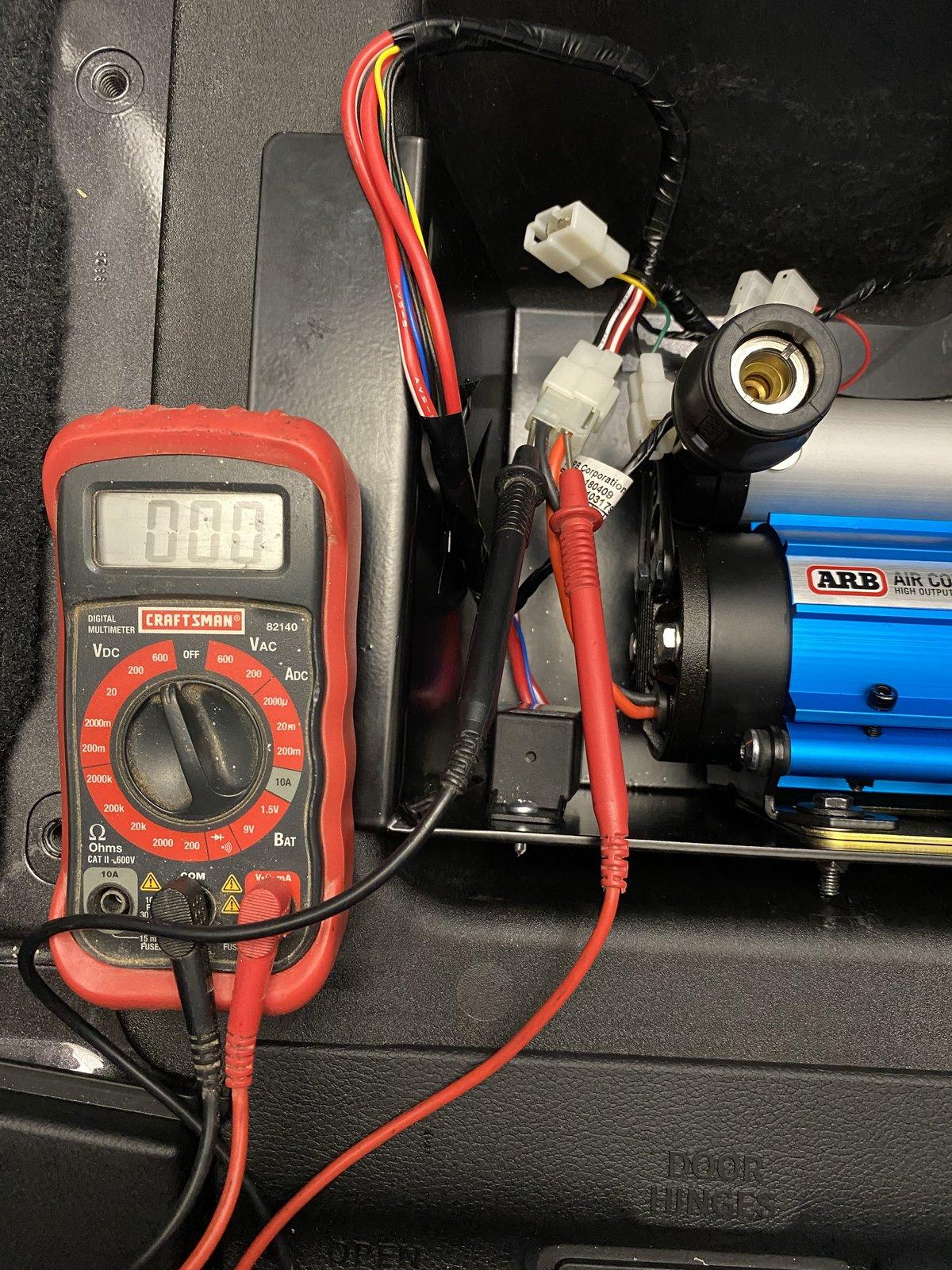

Just ran the direct-to-battery test and no joy. I got a lemon....on the horn with ARB now.

UPDATE:
I've got air!

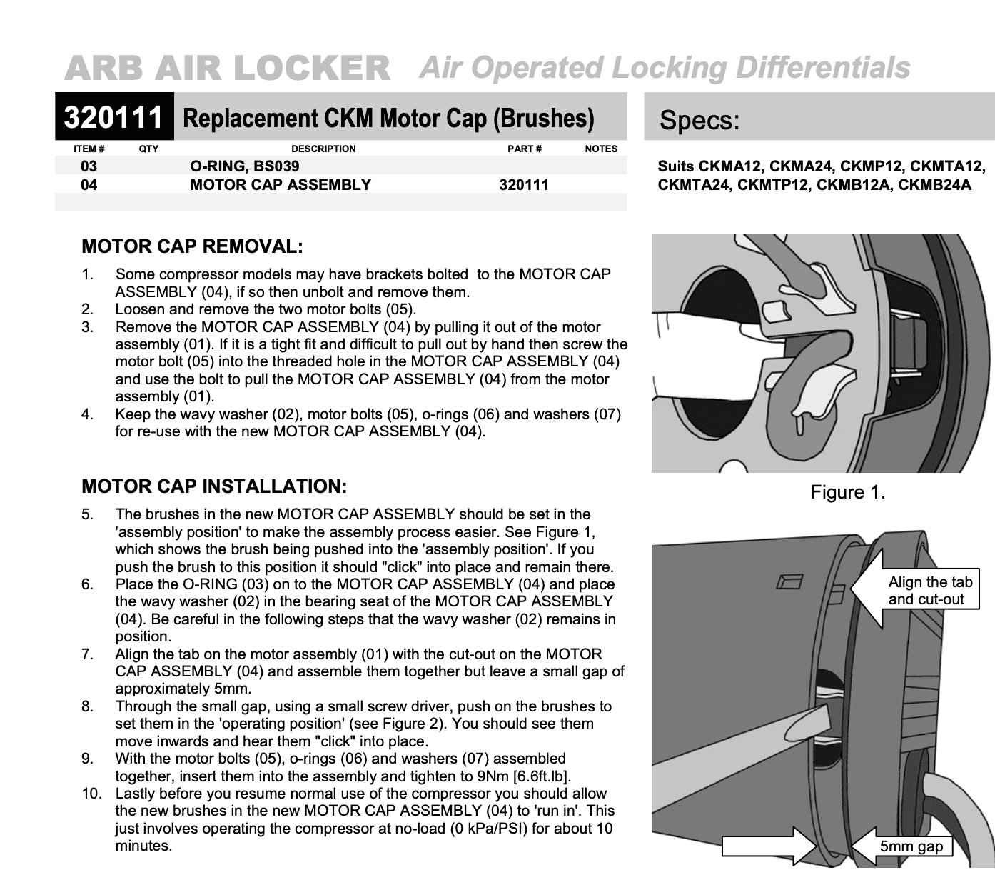

Talked to ARB and they sent me some directions for checking the brushes on the motor. never done that before but it was a piece of cake and I could immediately tell one was out of whack. Followed their directions and she fired right up.
Thanks to this great community for the ride here - particularly "Eck" for all of his help.

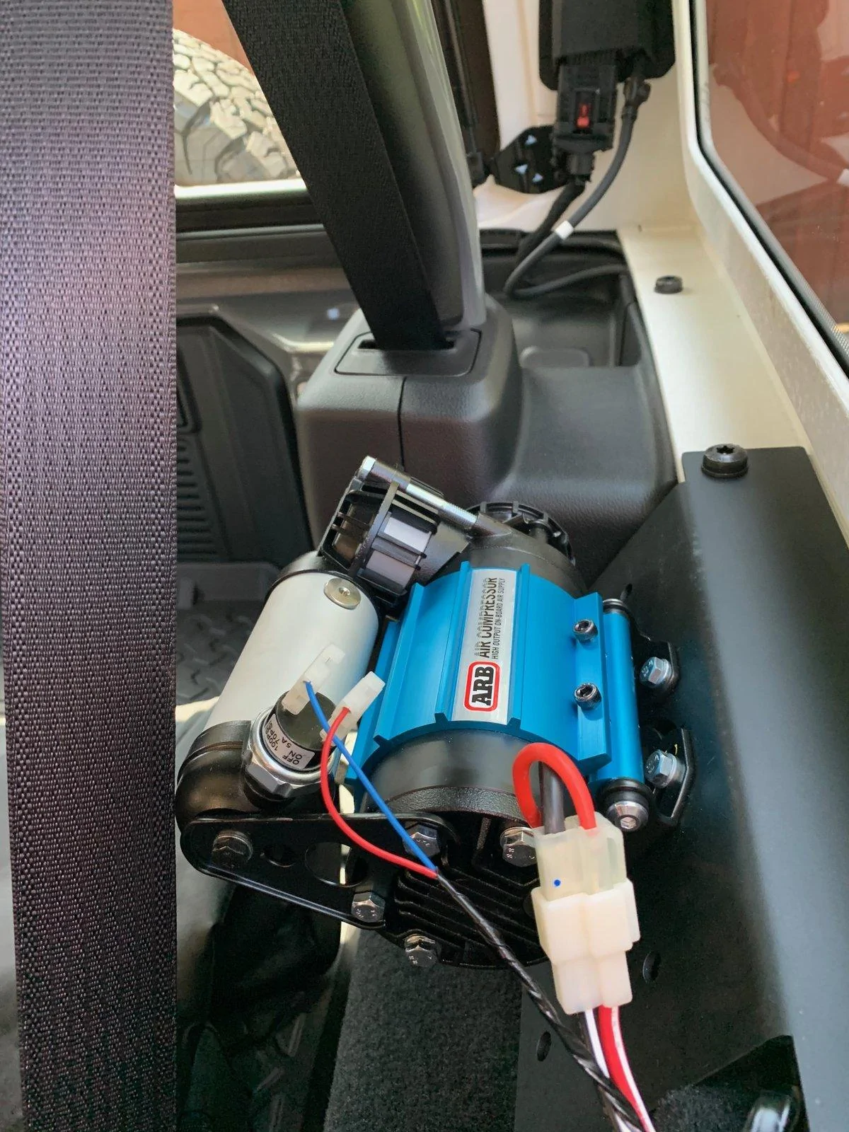

Pic 1 - jeep fired up, Aux Switch off
Pic 2 - Aux switch turned on
Pic 3 - Aux switch off again.
question: do you need to open the storage compartment lid when operating the compressor? is there a way to run the air intake out? i often have a full trunk
at the time I did have to open the lid. I have since added a hose to relocate the chuck just behind the sport bar.
