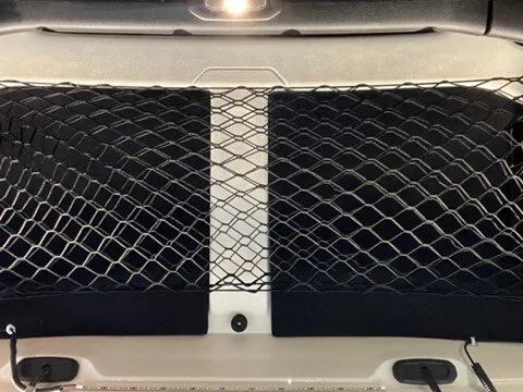

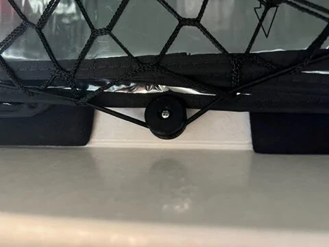

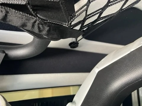

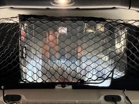

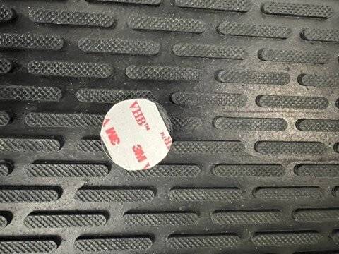

I recently was given a Weather Tech gift certificate and I wound up ordering a set of full sun shades. When I received them I realized that I need some way to store them other than just rolling them up. I considered a Blue Ridge Overland attic but I didn't want to impact the passenger compartment. I then started looking on Amazon and found this $10 net. It turns out that it is the perfect size for the rear of a Jeep hard top. It attaches with (4) round buttons and stretches tight. I did need to add (1) additional button that I 3D printed and secured with 3M VHB tape and a screw but at $10 for the whole package, it probably makes more sense to just order (2) nets. Here are some pictures of the final install. I have included the gcode for the extra button in case anyone needs it. This is definitely a great low cost mod.
That's a great find for $10 Art; I have a cargo net from the car before, so if repurposing that doesn't work, it'll be "Hello $10 deal".

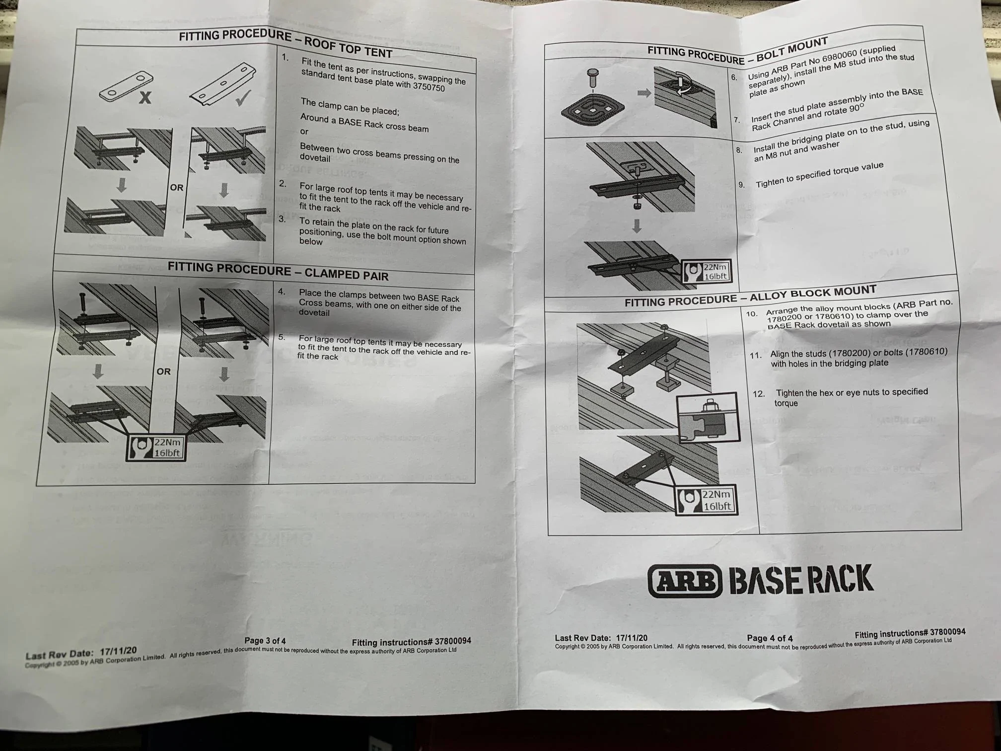

Thank you for sharing your solutuion with photos and video much appeciated. The bolt starter solution is genius, I've used the metal pipe trick at the end of the wrench before on engine & axle work before to acheive extra torque, cool to see that being employed here for extension. My tent is smaller and lighter than yours, mine is 130 lbs, and 60x48 closed. I've never heard of clamp mounts sliding side to side, that is a bit surprising given the tension they have, and force required to move the whole apparatus, I'll need to research that more. I don't plan on doing anything too extreme with RTT mounted though. Good luck on wrapping up your build, it looks fantastic!
P.S. I just got my narrow bridge plate kit, I found the differences in weight specs per configuration rather interesting.
Yeah, the different mounting options and their load ratings were definitely very interesting. If your RTT is 60x48 closed, then it will cover the entire rack as well (if you opt for the 61x51. Which, I think would also require you to mount the Rack to the upside down RTT first before securing the assembly to the rails. If I'm not mistaken, you will also be in need of a nut starter & wrench extender.

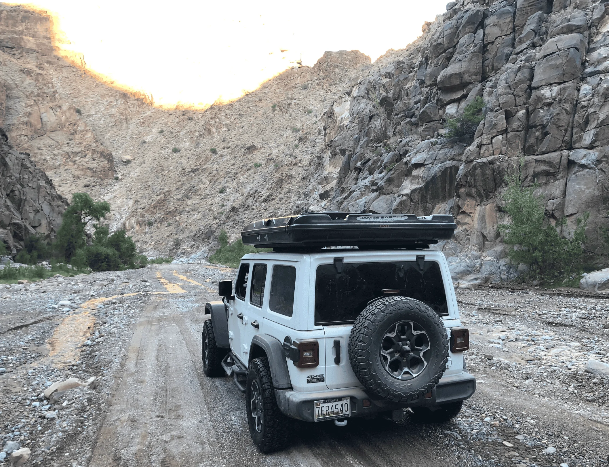

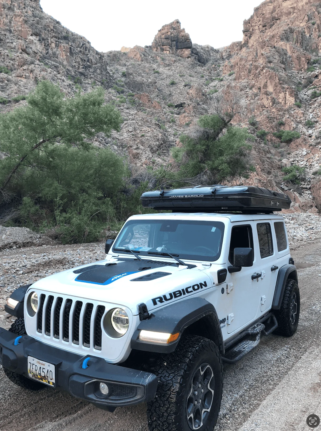

Love the low-profile and the sturdiness of the BASERack system. Took it out west for a 6 week exploration trip. Went on some pretty rough trails; it held up to pretty rough forces, especially side to side forces. But those were my primary overlanding needs (1) Low profile as I have a large RTT, (2) strong enough to hold up to everything (except extreme "rock crawling" obstacles).
