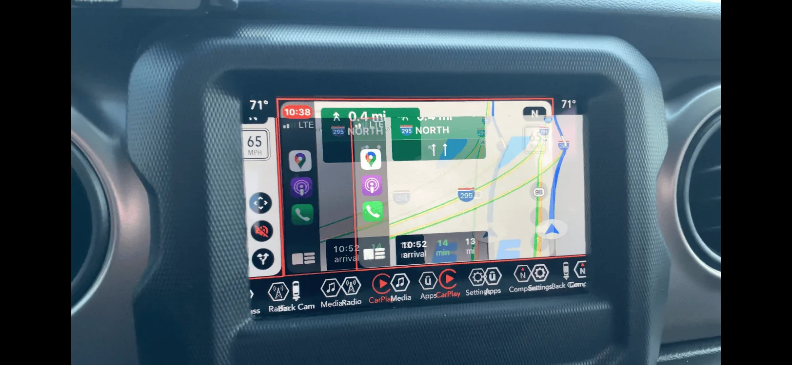

This is what the flicker actually showed when it occurred;
Jeep Wrangler JL Apple Carplay Screen "Twitching" Effect 22929913-8A9A-48A1-B1C3-EFF92E3F16F2

Didn't have the issue - but... I had an issue where I turned the volume down 2-3 it would continue all the way down to zero. (amongst other issues not related to the radio)
They performed TSB-08-003-19 Rev C
Since the update, flickering began - Only when Apple CarPlay is being used.
When I am on the radio tab, no issue at all.

Anything new on this? I had this problem in my Jeep, but then I was on business and rented another make (Hyundai? Nissan? I dunno) and got some flickering there too, so I figured it was my phone. Well I just got a new iPhone and still having the issue. Had the problem with my old iPhone XS, swapped from an Amazon cable to a fresh from the box Apple cable, and then got the new iPhone 12 Pro Max, all of them have the flicker. Tried both the port on the dash and in the arm rest. Have not tried the USB-C port, but I can try that next.
Would love a resolution, it’s somewhat distracting out of the corner of my eye, plus it honestly makes me a little wary of the Jeep electronics...

Unfortunately, I’ve been unable to find a resolution for this issue. I can tell you phone model, os version, cable type, etc makes little to no difference. This seems to be something with uconnect itself, even running the latest firmware.
I love my Jeep, but this and other electrical issues make me nervous. I’m on my 4th auxiliary battery in under 30k miles. I asked the dealer why it keeps failing, he shrugged and said they do that. To get both batteries replaced outside of warranty, he quoted me $500, so I dread the next time this needs replaced.

I've searched the forums and not seeing anything on this yet--some months ago, I noticed that when using Apple Carplay, the screen occasionally twitches. Not sure how else to describe it, almost like a quick spasm then works normally for awhile. The audio doesn't cut out, it doesn't hurt anything, just obnoxious and looks awful when it happens. I've tried replacing the usb cable. It only happens using carplay, so I doubt it's the 7" unconnect unit itself. I starting noticing it after the dealership updated the firmware on the jeep headunit, although it could be coincidence. Still, all signs points to a software issue rather than hardware, so either iOS or uConnect. Only thing I haven't tried is replicating the behavior with an android device. Anyone else seen behavior like this?
