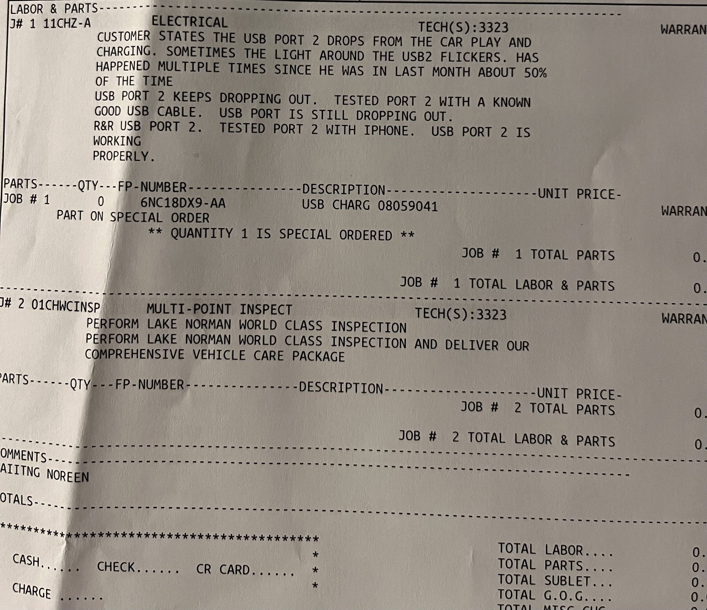

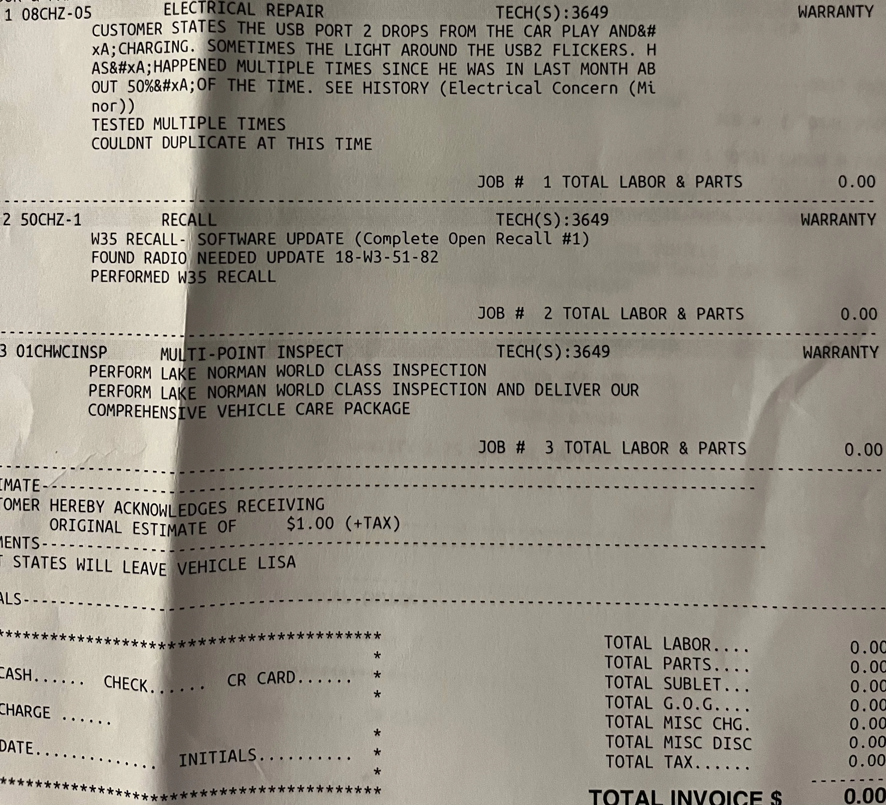

mine got fixed by replacing the usb2 port and the usb hub in the back of the center console. dealer did it under warranty. took 4 visits.......
Could you post or send me a copy of your service record for this, so I can show the dealership? I’ve had two different dealers try to figure this out and both quit trying. The first replaced the entire radio, but it still happens.
Here are two that I could find, it there were 3-4. I know for sure they tried replacing the usb2 socket in the center console and that did not work then they replaced the usb hub in the rear of the center console and that fixed it. The way it is wired is that the usb hub in the rear connects to the one in the dash and the port inside the arm rest is wire to the rear usb hub.
Jeep Wrangler JL Apple CarPlay freezing D8823512-B3E7-4622-9DE5-6F0E25DC06A0
Jeep Wrangler JL Apple CarPlay freezing EFD88D08-5773-4F15-BC0B-1094075CC12E
