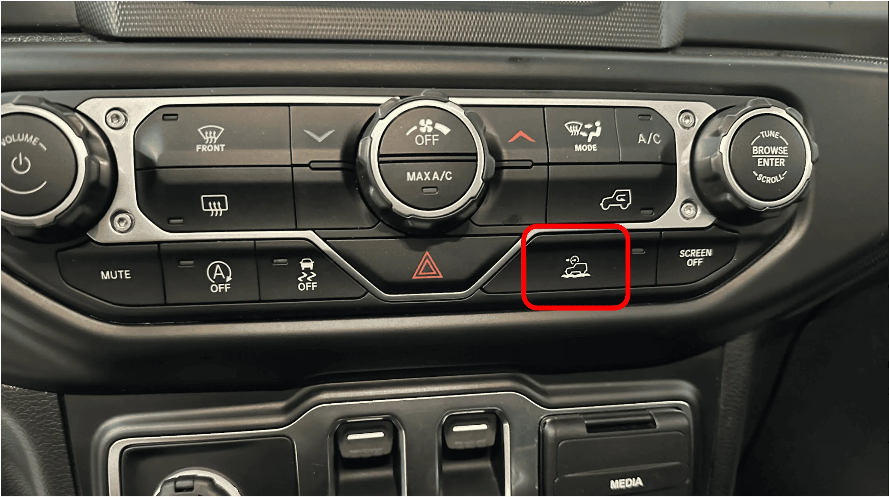

Anyone know what this button does?

Can't find anyting in the manual about tis button

Select Speed Control (SSC). It's a great feature. Consider it off-road Cruise Control for about 5 MPH down to 1.2 or 0.6 MPH depending on your trim level.
It's especially good for off-road descents as it can control all 4 brakes individually as opposed to the driver who can only control all 4 brakes simultaneously. I've used it to get down sketchy slick mud and it did a great job keeping things completely under control. It's uphill performance can be matched by a human driver but only one with a very steady right foot.
Yes, the icon looks like a duck. Once you see it you can't unsee it.

I think it has to be in 4lo to work.
I tried it a couple of times down sections of sketchy, loose downhills and didn't like it. I trust myself more than electronics even though electronics can usually racat quicker than me and control things that I can't.:)
The logic that drives your trust levels is fascinating. But to each their own! ?
I've not tried it, but I had kind of the same thought process. I use cruise control nearly every time I get on the freeway, but never use it for like, residential roads, or anywhere that I'm likely to need to quickly react to changes in the environment/road ahead. Likewise, when I'm wheeling, I'm probably the *most* attuned to what's happening on the ground beneath me - seems like the last place I'd want to automate (plus, what's the point of off-roading if you're just going to cruise-control through it?)
I hadn't thought of using it for downhill though.

It is fantastic when you need to go down a steep, slick incline. My driveway is treacherous in good conditions, and when it is icy, this is the only way I can make it down sometimes.
For reference, my "driveway" is a 3/4 mile dirt lane that cuts diagonally up the side of a small mountain (big hill), with a sheer drop on 1 side that at the top is all of 100 feet straight down to the decommissioned railroad bed below.
I've tried it on insane descents like going down Red Cone. Holy crap that feature was noisy AF. I immediately disabled it due to the fear that it'd burn out my brakes, even when locked into 1st in 4lo.
And, of course, a Sport in our group lost its brakes. 1st in 4lo apparently wasn't low enough with the Sport's transfer case.
Definitely try it on really steep climbs. It's kind of mind-blowing.
