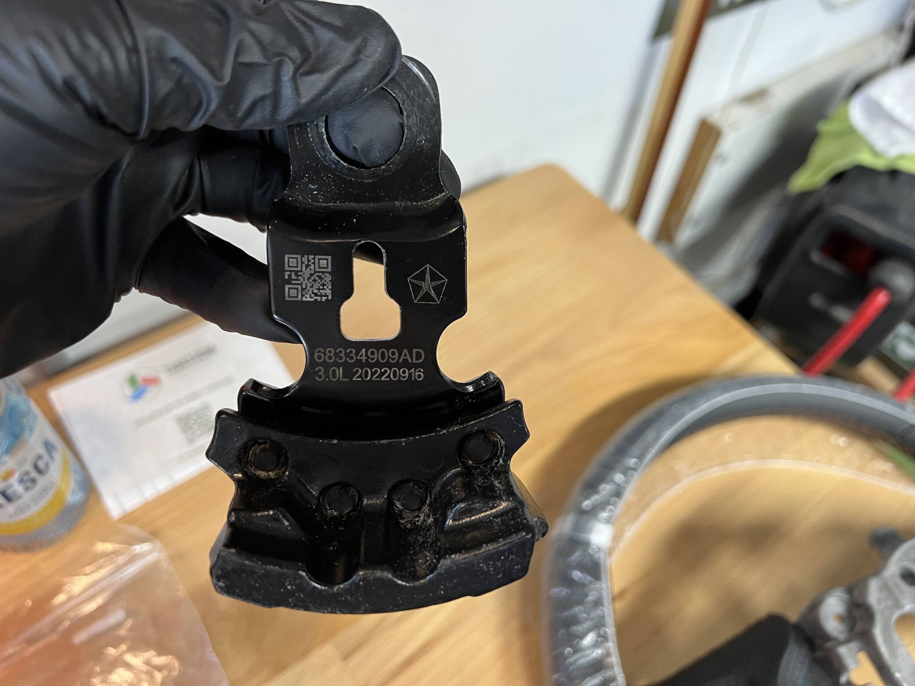

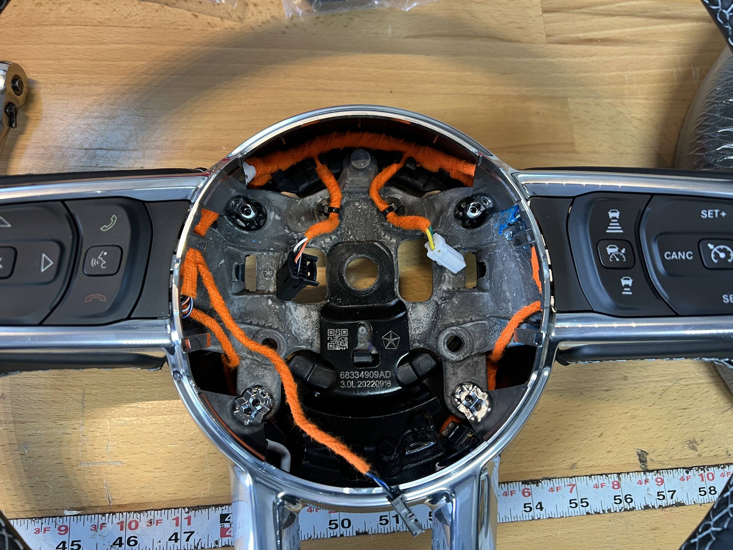

Here is my second conundrum. My steering wheel on my diesel seems to have a weight on it that no one has mentioned in any of the paddle shifter videos. It clearly has a 3.0 L stamped on it, so I’m assuming it’s a diesel only parts. as I did buy a 392 wheel, do you think I also need to have this weight in there as well? The 392 wheel definitely seems heavier than my OEM Rubicon wheel. Does anyone know about this weight? It has a QR code on it that I’m going to scan. My thought is to go ahead and install it and see what it feels like and if it seems too heavy on the wheel, I will take it apart and uninstall it. I’d love to get some feedback from someone who knows about this. @392OVRLND or @Ratbert, any ideas?

I'm thinking that it's time for your to buy a scale.
Ha, I have a digital one at my office, but didn’t feel like driving over there!!
