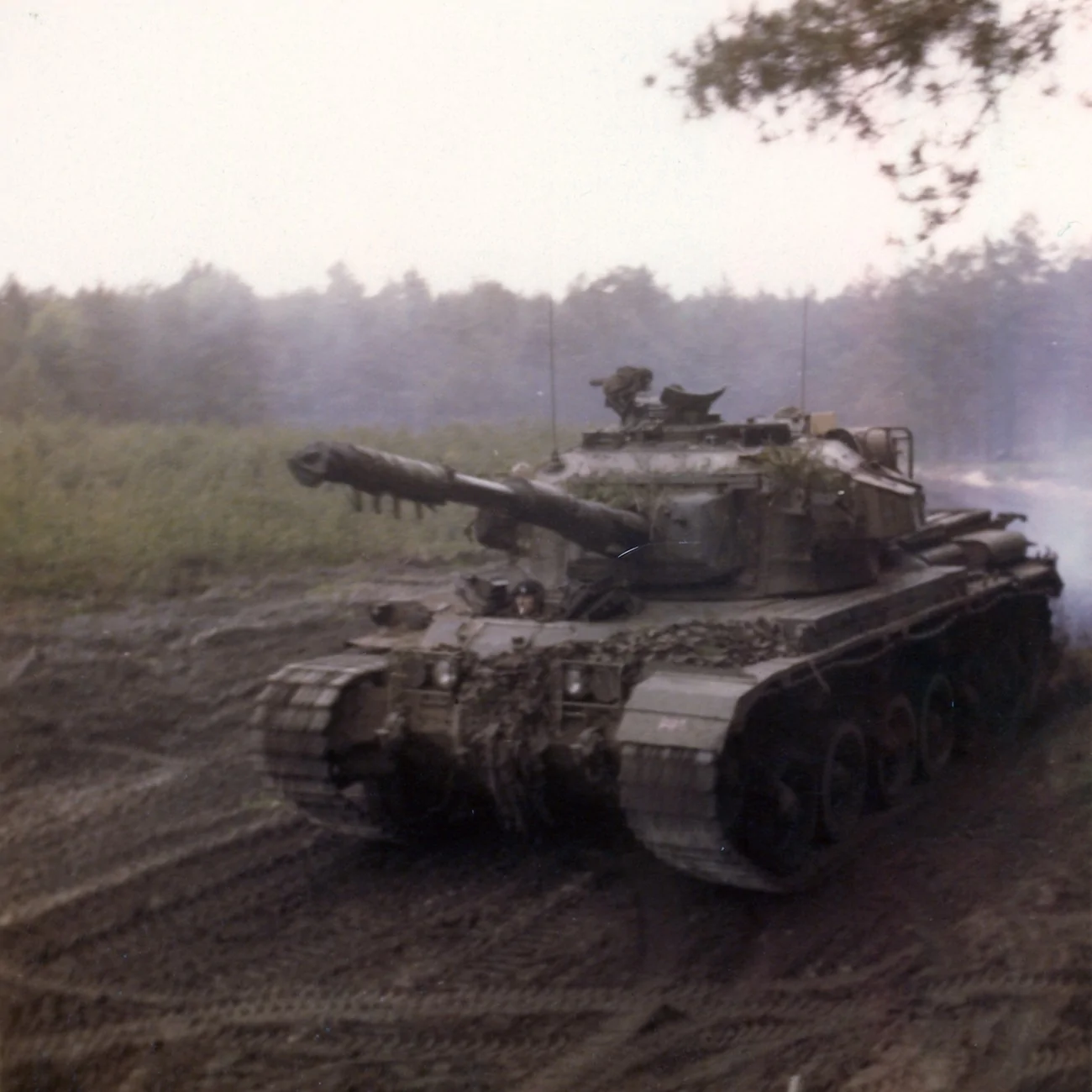

This is a Centurion MK13 Tank, fully bombed up about 55 tons. It has 5 froward and 2 reverse gears, straight cut crash gear box. You have to double the clutch both up and down the gears, get it wrong and you are in the shite. On the down shift it is normal to "flick" a tiller (steering brake) in the neutral position to slow the gears to help mesh them.
There are 2 main brake drums, they are about 36" diameter and 4" wide. In an emergency they will last about 15 to 20 seconds tops. I only changed a set out I think twice in about 2 years, that's in a squadron of 13 tanks. The steering brakes are the same diameter about 3" wide. Engine braking was really the only way, on the level it was "easy", in the mountains in south Germany, not so much. The clutch was worked by a set of push rods and linkages from the front to the back of the tank, which were hard to adjust, start at the front and work your way to the back. Driving was a real work out didn't have to go to the Gym.
Jeep Wrangler JL Any harm in engine braking? Centurian mk13

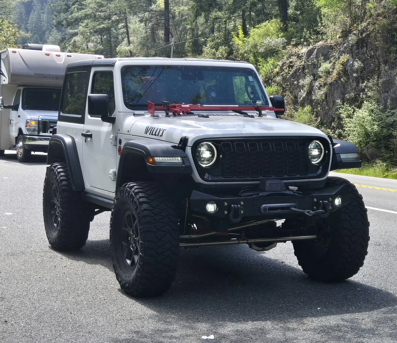

So true, specially if one is a 2 door with 3.5" lift and 37" mudterrains. I don't want to ever experience and find out what happens if I slam my brakes at 65 mph downhill. Not only downhill but also a curved highway. My aerodynamics and tires are so bad that I don't even neef to brake on a flat highway, Jeep loses so much momentum when I lift my foot off of the gas pedal.
